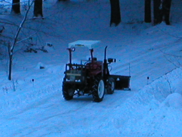

Hi Brian,
I mounted a 7' truck plow on the front of my tractor. It is a 20HP Nortrac. Once the snow gets high on the sides I then push the banks down here and there. Kind of opens a hole so the snow has aplace to go. Anyway I had to make the brackets to mount the blad but the little tractor swings it around like it's not even there. /forums/images/graemlins/grin.gif
