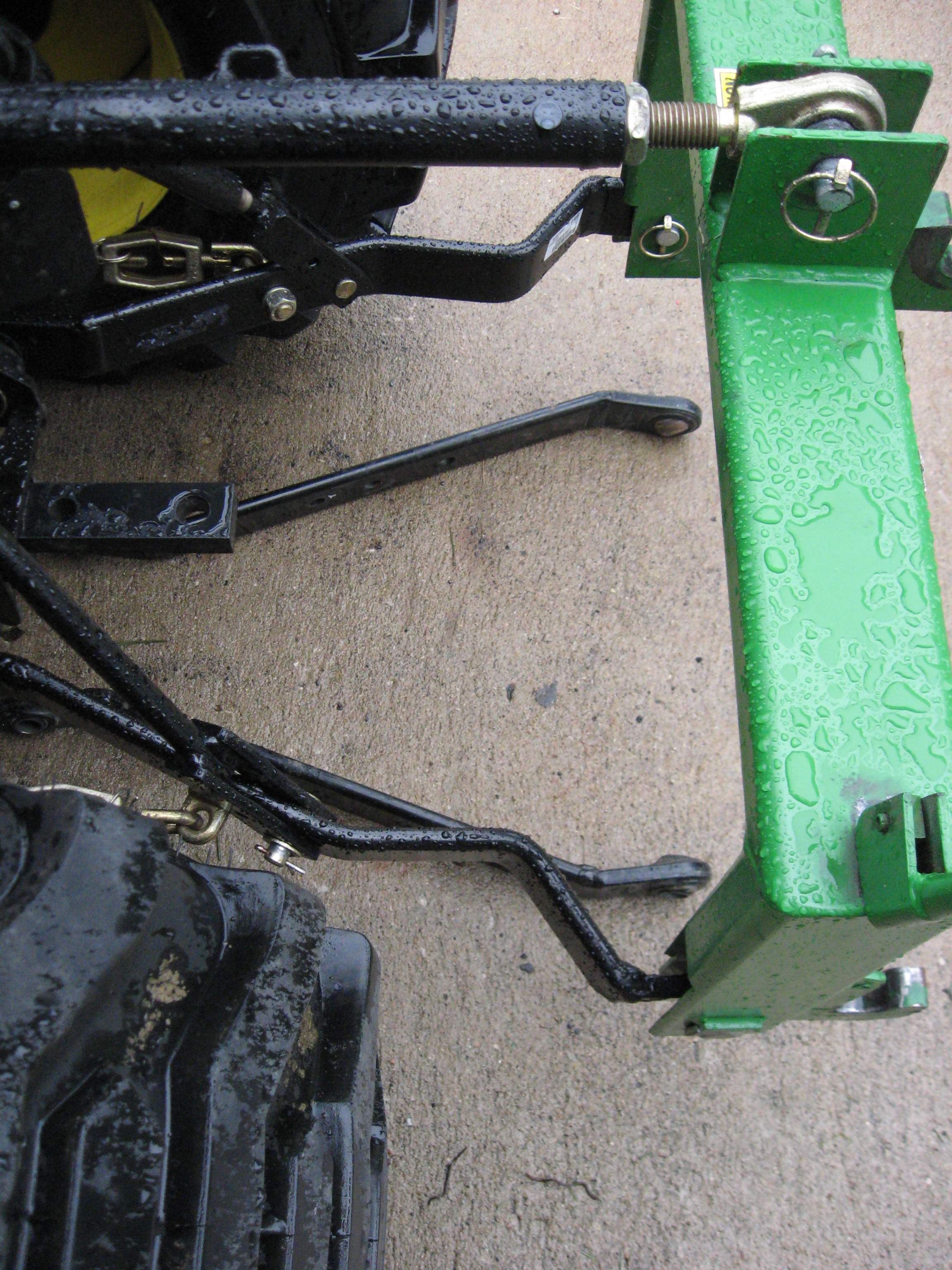

There used to be a concern regarding old / new style lift arms on the 3pth. Old ones may rub tires - new ones don't. Maybe a 2520 owner or JD store can clarify what to look for and if that was still a concern for 09 models.
Here is a picture of the new style (on the tractor) and old style draft arms for comparison. This is a fairly big issue if you will be using three-point attachments because the arms are about $300 apiece. IMG_1362.jpg
It will work with the old ones, but having them rub on the tires is annoying. Might be a good bargaining chip.
