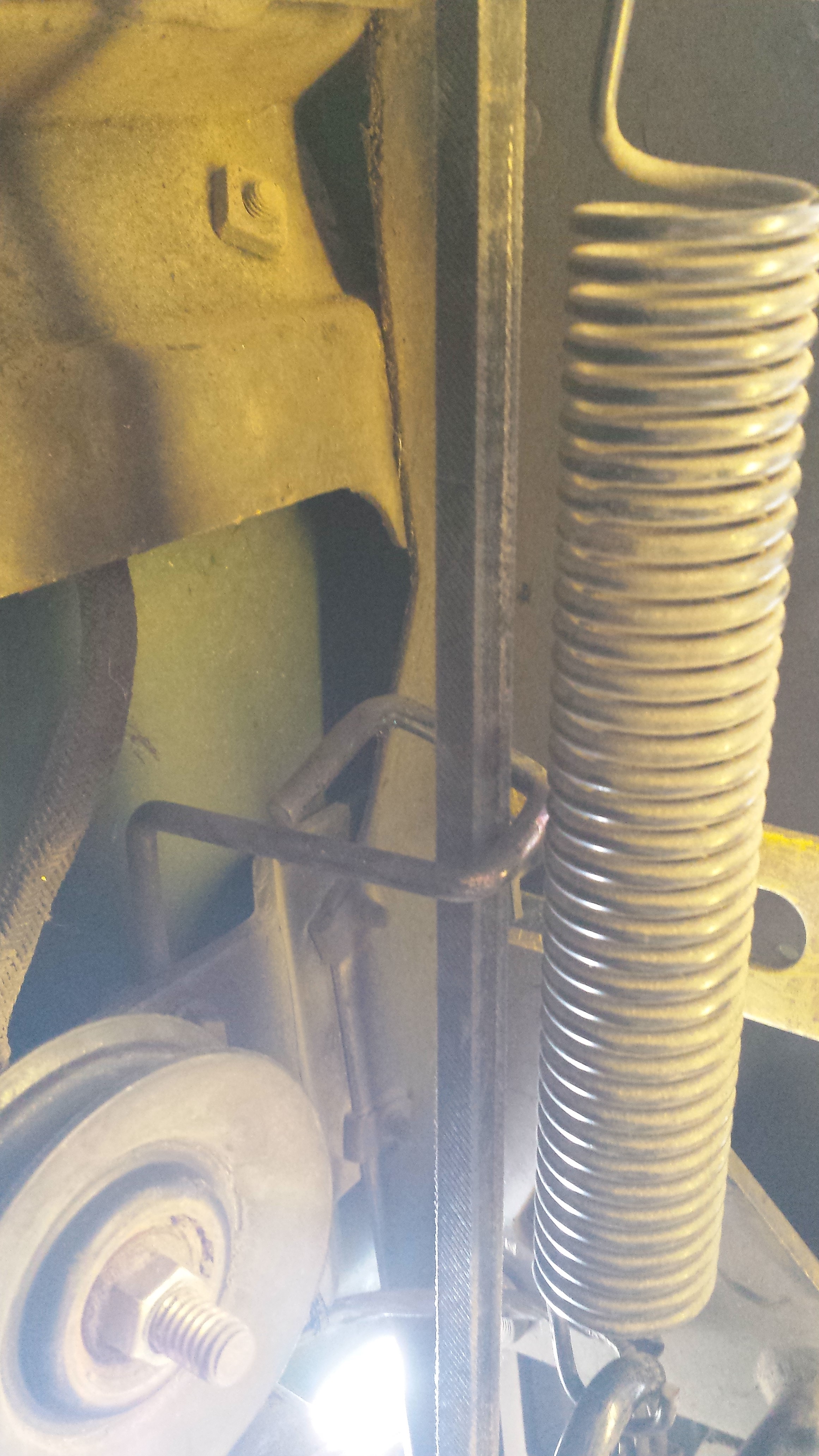

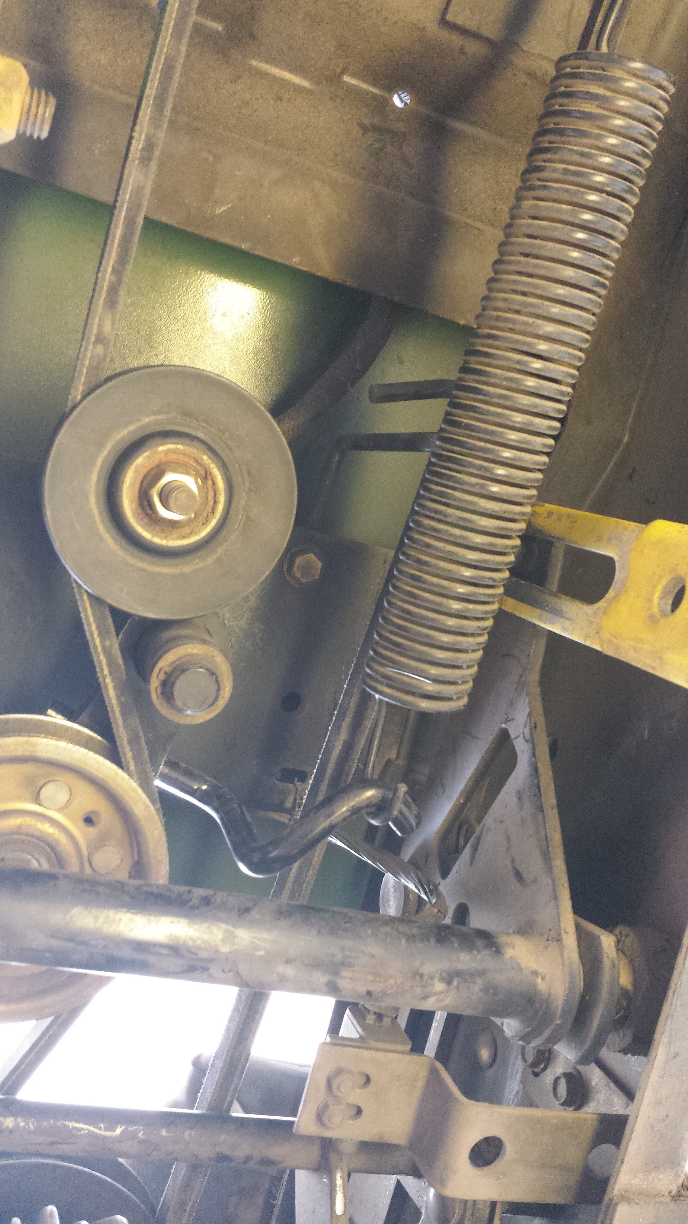

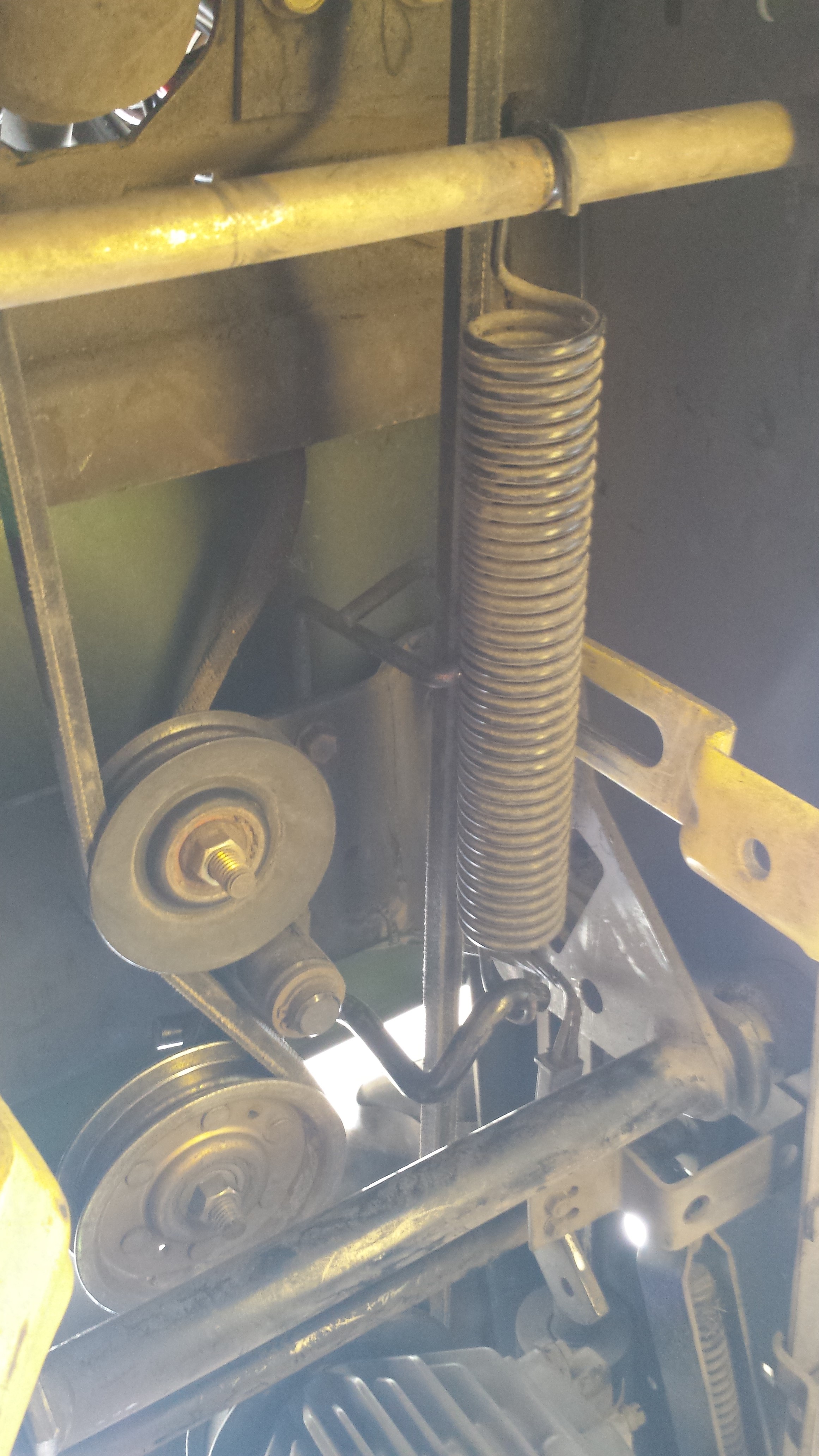

The belt goes to the out side of the small idler pulley nearest the engine. On the spring loaded double set of pulleys, V side of belt around smaller pulley, outside flat of belt on the larger pulley.
Your picture of the spring loaded pulley set looks correct, but there is guide plate missing. It does not matter, but my spring was on with the hooks up, not down.
There is also a wire guide to keep the belt on at the engine pulley, right side if you on the tractor.

Success! thank you very much for all the help. i was thinking about it while i was at work today....maybe the drive belt was failing and slipping causing me to think i had an issue with the pto....either way i'm back in business, couldnt have done it without everyones help, thank you!
