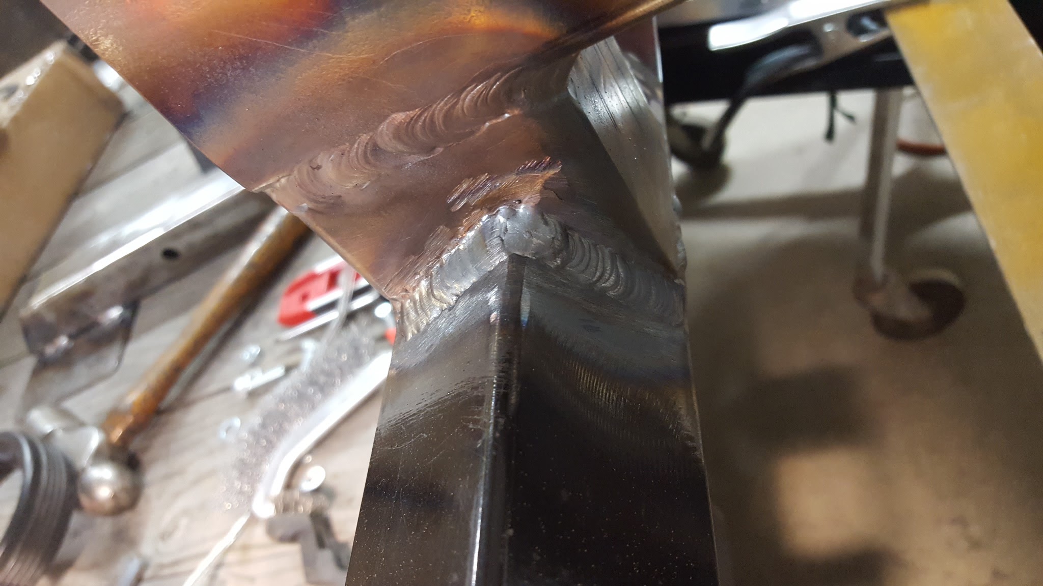

I'm still learning how to TIG weld, so I decided to weld something productive. Some look okay but others not so good. It sure would have been faster with the MIG.
I had a hard time on the right side of the angle.
I had a hard time welding the wench plate to the 2" square tube.
Now it needs paint!

You got some really bad under cut in places. I would run another pass over the under cut to fill it in!

I could post a few pics of my tig welding, that would make you feel better about your welds. :wink:
   / I'm still learning, but I made a wench mount for my trailer. #6
The nice thing about Tig is that if you don't like what you get, You can go over it again and again with or without filler rod.
I have did a little of that. Tried to fix one of the welds tonight, didn't really turn out all that well. I ground it out and well re-weld it tomorrow.
Tim I didn't think you welds looked bad at all. Yeah one was undercut there, but overall I would have been happy with them.

Thanks James, Here is the one I fixed or worked on anyway.
