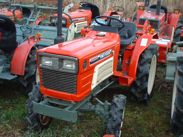

As many of you have probably guessed, I have imported a couple of containers of tractors kind of as a hobby. I'm not a dealer, but I did sell 4 tractors that I bought myself, specifically for resale. One of those was a YM1702D with 157 hours. That was real - the meter still worked, the tractor looked like it had come off a showroom floor. There were still paper/cardboard tags under the hood attached to various hoses etc with string. The tiller did show some use, but was in excellent condition as well. It was clearly not rebuilt, or repainted. I'm sure this is an exception, not the general rule. That tractor was a beauty, and if it had been a powershift tractor, I would have kept it for myself. As it was, It sold before I even got the fenders back on it.
My point is - it is possible that this FX24D truely had only 100 hours on it. It would be a rare find, but still possible.

That is one of the cleanest looking tractors I've seen coming out of a container.....that is a rare find with the hours so low.
Looks like you might have an F or FX series right behind it?
Can't make it out but certainly a later model Yanmar.
