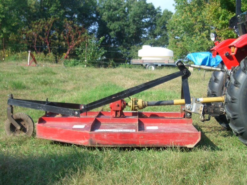

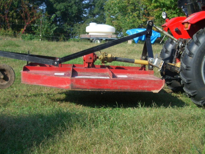

Greg, please don't misunderstand me as picking a fight or trying to argue, I'm just trying to make sure I understand here. Isn't this the same mower?
Yup, but you're again factoring a much older discussion into the topic. The internet is an evolving thing, and stuff that's retrieved from the past has to be considered in it's historical context. I haven't owned that particular tractor or that mower for years. That posting was before I suffered the damaged toplink threads and bent straps caused by the FTL bracket being upside down. At that time, I was under the same impression as KEBO and REELNATIVE. I'm not sure where Ken's coming from. What I'm posting now is "lessons learned" from that earlier experience.
I can't say with certainty, but my guess is that these other guys are trying to make one toplink do for all their TPH implements. Among other lessons learned over the years, is the tractor/implement geometric relationship.
There's no such thing as a universal toplink. That's why you can buy them in a variety of open/closed lengths. I've had two dozen or more TPH implements over the years, and six different tractors. During that time I've used two hydraulic toplinks and perhaps 7 or 8 different conventional toplinks - and I'll bet at two dozen adapter bushings. I do NOT leave just one toplink on the tractor(s) and hope it will work on any given implement. Rather, I fit the toplink to the tractor/implement geometry - then leave that particular toplink with the implement.
Given that you currently have only one tractor, one implement, one toplink - my advice remains unchanged.
//greg//
