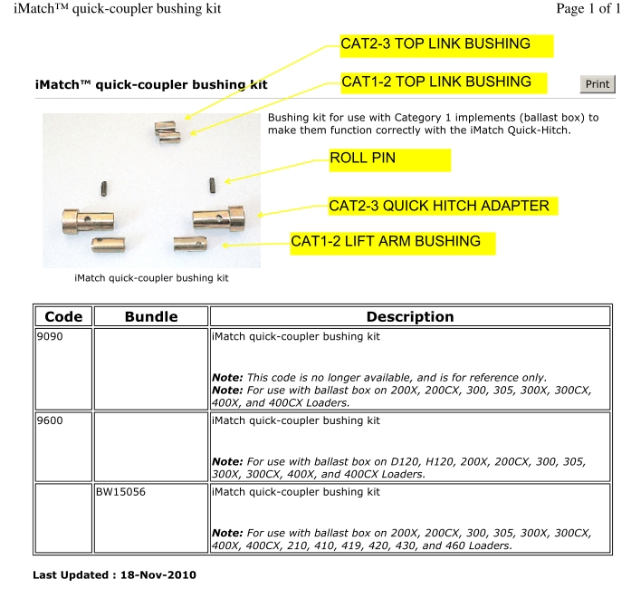

OK, so the IMatch stick out. What do you guys recommend for ballast instead? open to ideas...:confused:
I think we all recommend the iMatch + ballast box combination. Kennyd pointed out that the iMatch includes one BW15056 iMatch quick-coupler bushing kit. This needs to be added to the ballast box so it fits securely onto the iMatch.
For your additional attachments (if you have any) you may need to add another bushing kit to the attachment. The JD kit is somewhat pricey. You can get all the pieces elsewhere for less. Here is an example:

Picture of the John Deere BW15056 kit is below:
Here is another source for the bushings: QUICK HITCH ADAPTER KIT CAT 1-3
