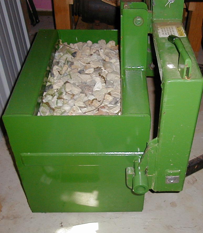

I recently purchased a 2210, FEL, with an iMatch and ballast box. The arms on the ballast box do not extend past the iMatch to allow pins to be placed into the arms. This leaves the box so that it is able to slide in the hitch. It can't really fall off, but I don't think that it should be this way.
The dealer brought me a new ballast box and the arms on that are even shorter than the first. He tells me that all of the ballast boxes that they are recieving are like that. Has anyone had a similar problem ? Is this standard for an iMatch - ballast box combination ?

There is a part number for longer pins-knobs they call them for the imatch hitch..Have you dealer parts guy look it up, they are in the picture with the imatch hitch..You might find the number on John Deeres parts site..I will post it if I get around to finding it after while..
   / iMatch Mismatch #4
There is a bushing kit (BW15056 - I think- maybe BN15056) that I bought to make the ballast box fit the I-match, which is spelled out in the fine print. Its about $30 and converts the Cat I to Cat III, and comes complete with roll pins to attach it to the ballast box pins (via the 'holes').
There is no way, IMO, that I want to run bushings back and forth from one attachment to another. This defeats the purpose of the I-match system. I think the bushings should be more readily available, and the salesmen should know when and where they are needed.

When I got my 4110 with a ballast box and a iMatch, they gave me a bag of parts that is a little kit to convert the Cat 1 pins to Cat 3, but I haven't taken the Backhoe off and tried it yet. Looking at the parts, it's not obvious exactly what to do with them. If you know of a picture of these parts installed, I'd be very interested in the link.
Cliff
   / iMatch Mismatch #6
Maybe this pic of mine shows what you want to know.
The bushing is in place and the 'hub' is to the outside.
