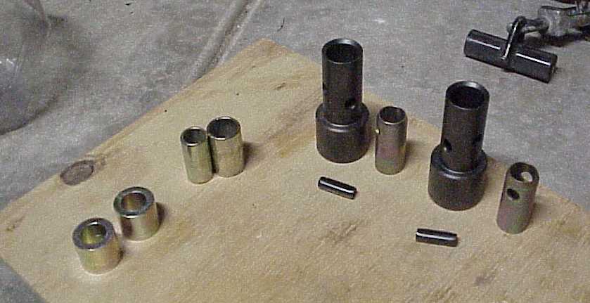

OK, I went out and took a photo.
With my 4110 and iMatch and ballast box I got the things in the picture. The two thick bushings on the left came attached to the iMatch with a tie. The rest came in a black sealed bag marked "bushings". The only reason I got the extra bushings was that a mechanic happened to be there when I picked up my iMatch and he said I couldn't use the ballast bow without out that kit, so they gave me the kit.
The two groupings of three items on the right are, I believe the Cat 1 to Cat 3 bushings for the side pins. I guess the little bent metal tubes are to afix the bushings to the pins if you want to. I guess I would get some removable pins instead. (thanks for the photo, they make sense to me now.)
The next two bushings (going right to left are concentric (one fits inside the other) and I guess they fit over the top pin to make it cat 2 to fit the iMatch.
I don't know what the other two are for, but they are cat 1 to cat 3 bushings and will work some some implement I do not have that presumably has captured cat 1 pins.

The ones with the roll pins are what I need..I have the spacers on mine now and just been using it like that without the lock pins-keepers..

You have that figured out, at least as much as I have it figured out. There are combinations in the kit for more than just one tractor. And maybe one attachment, as you suggest.
Pssssst. (Now if we can sweet-talk JDdude to downsize that schematic attachment, this thread will be much easier to read). /forums/images/graemlins/wink.gif

I just wanted to thank everyone for the replies, especially Cliff_Johns. I spoke to the dealer and they weren't aware that such a kit existed. After emailing them the pictures which were posted in this thread, they emailed them to Deere. Deere told them the part number and the dealer then had to order 8 kits because several customers needed them.

Glad it worked out -- and that you could help all those other owners by educating the dealer. This kit seems to be an obscure bit of trivia. Digital cameras are a great invention.
