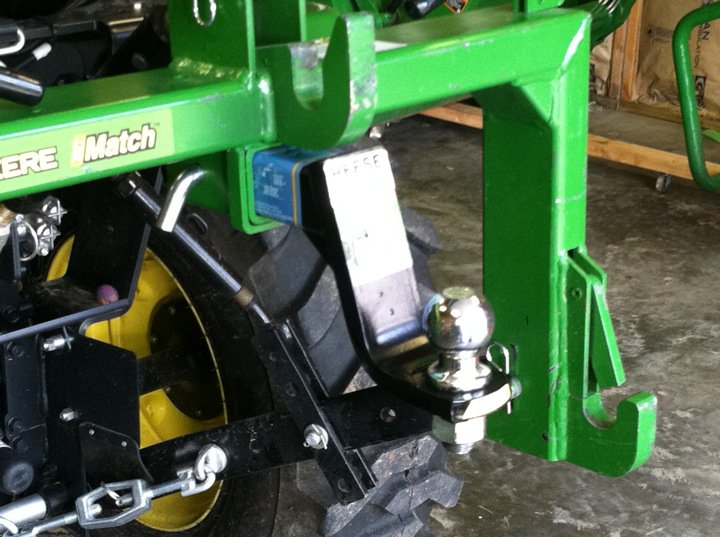

Thanks to JB4310 here on TBN for the idea......
I welded a receiver tube to my Imatch quick hitch instead of buying deers attachment and bushings for around $240 ( 3-point hitch tractor receiver hitch )...I have a whole $25 in the receiver tube and paint and it works great...:thumbsup:

Good plan! Better than what I did 10 years ago... I welded some metal to fit in the I-match that had a the receiver tube in it. Way more complicated than what you did. I think I'll scrap mine and do one like yours. Good idea!

This is great for light to medium trailer loads, I think for real heavy loads the 3 pt adaptor type would be better suited because it is transferring the pulling load more to the lower arms. with the hitch up high on the top beam the pull load is more on the top link, which is not as strong as the lower arms.
Also I would not attach a chain to an insert in that upper receiver and jerk hard on something, for the same reason of to much shock to the top link.
But for trailer towing/ moving around the yard I think it's perfect and quick, no need to install the adaptor. I think we'll see more of it.

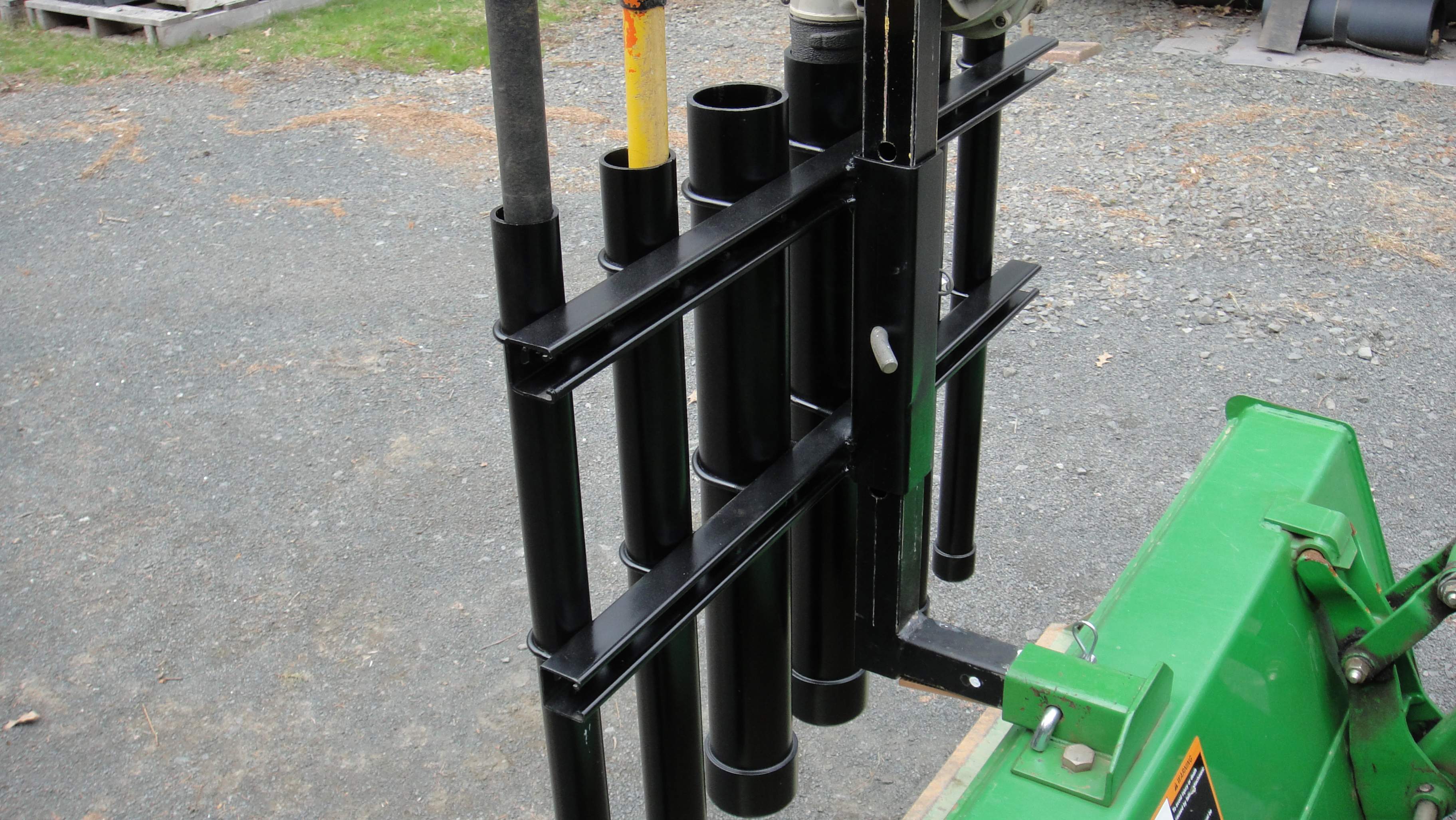

Did you see this contraption? Goes good with a receiver tube.
JB.

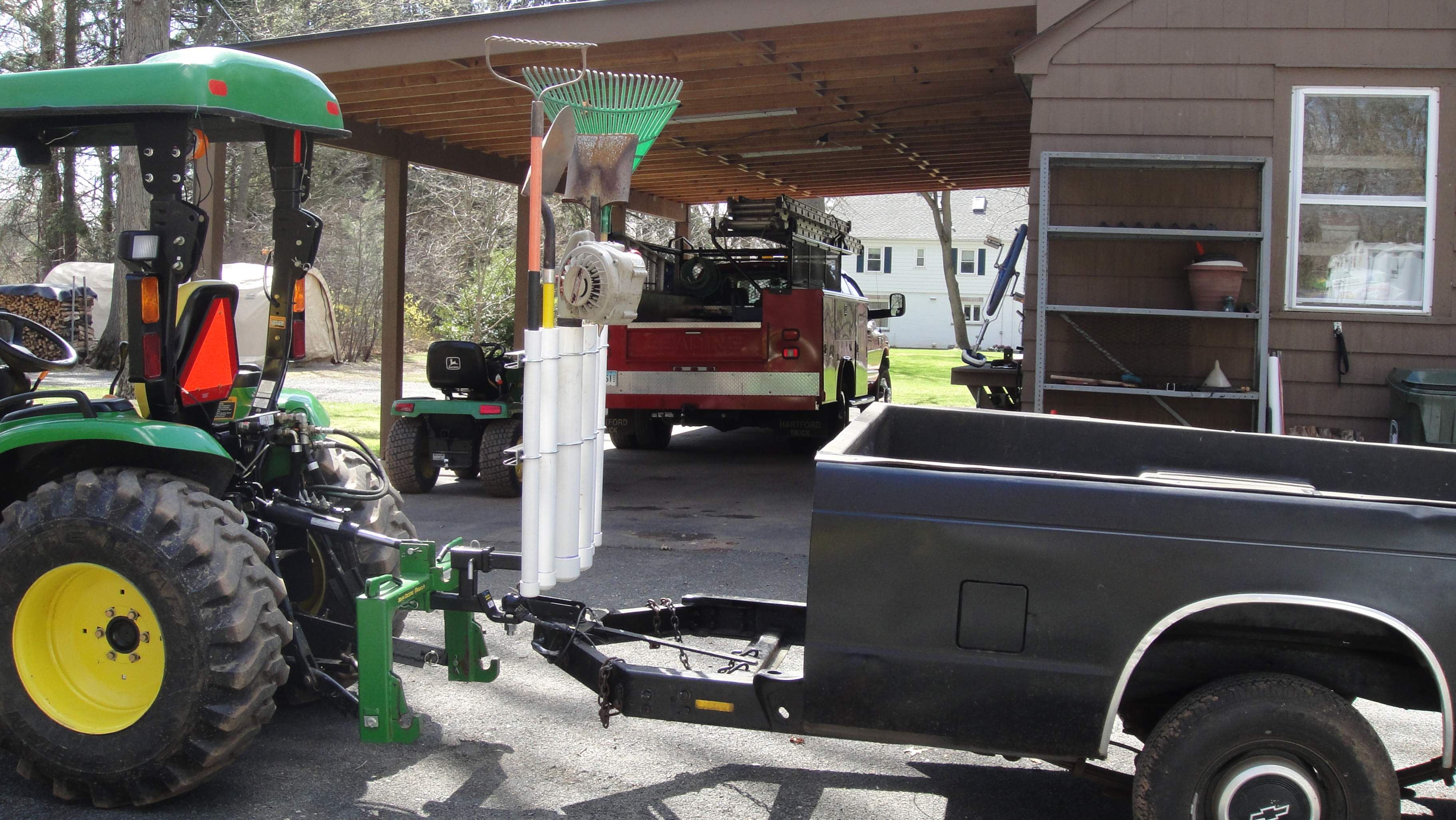

The I-Match is John Deere's name/version of the 3pt quick hitch, same as the Speeco sold by Tractor Supply. It attaches to the 3pt lift arms and the top link. Look at picture in post #3 with the trailer connected, it shows it very well and you can see his drawbar there with a clevis in it.
