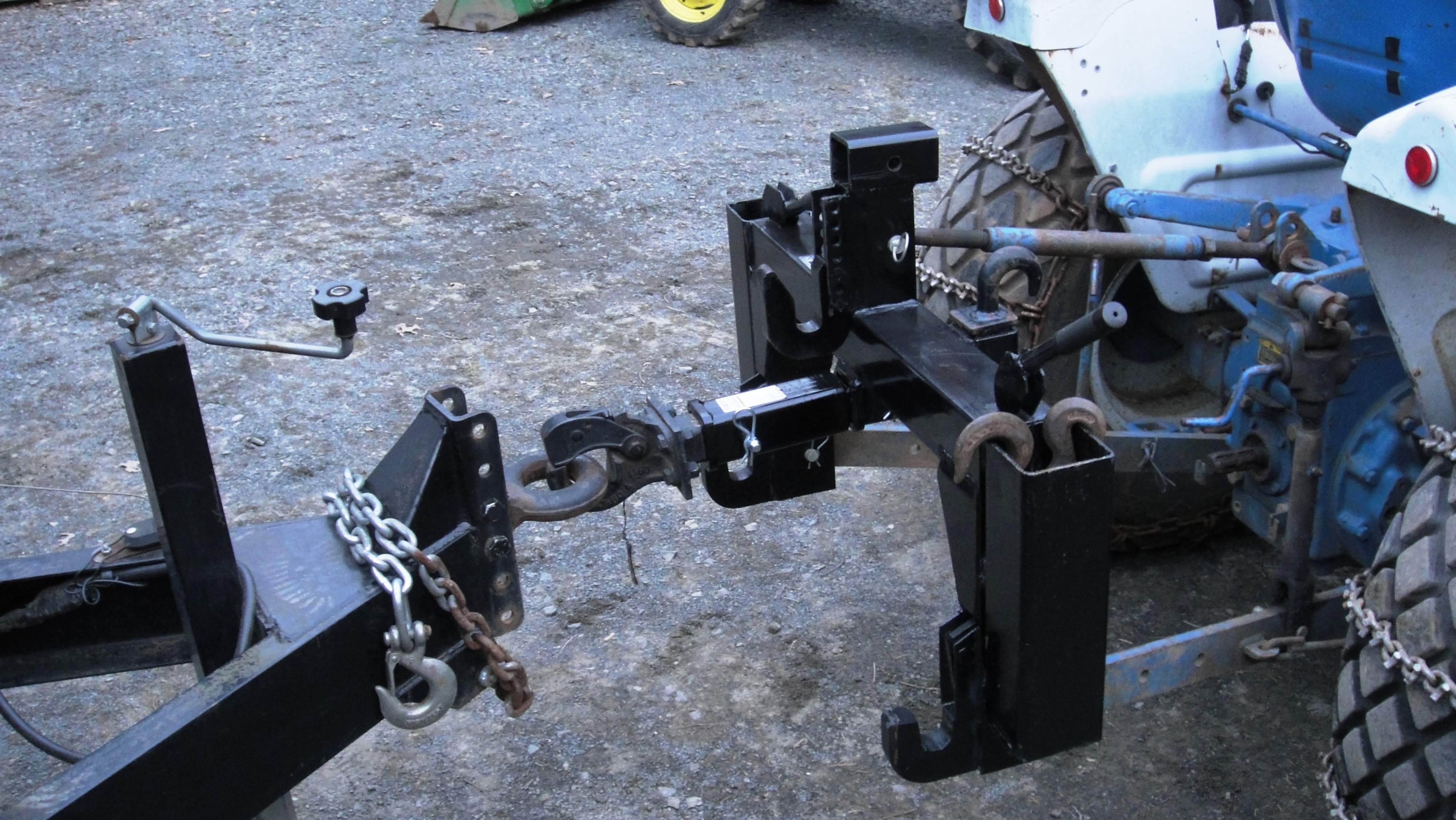

I've got both the I-match and the HF QH. I like the I-match better, mostly for it's looks. The HF model is bulky and a little rough around the edges, it did require some modifications to work with the implements already modded for the I-match. But once set up, performs as well as the I-match.
I've done some custom modding to both, putting storage boxes on the sides and receiver tubes.
JB

As you can probably figure by now, the choice is dependent on your own uses. I have the HF QH and it's clearly lower quality than the others - but it does work. Like many others, I had to grind on the hook to open it up to standard dimensions and I had to modify the pins that hold the hook on so it would fit into my box blade. However, these modifications were minor compared to how I would have had to modify my log splitter to work with the fixed hook on the iMatch.
If you need an adjustable top hook, you really need it.

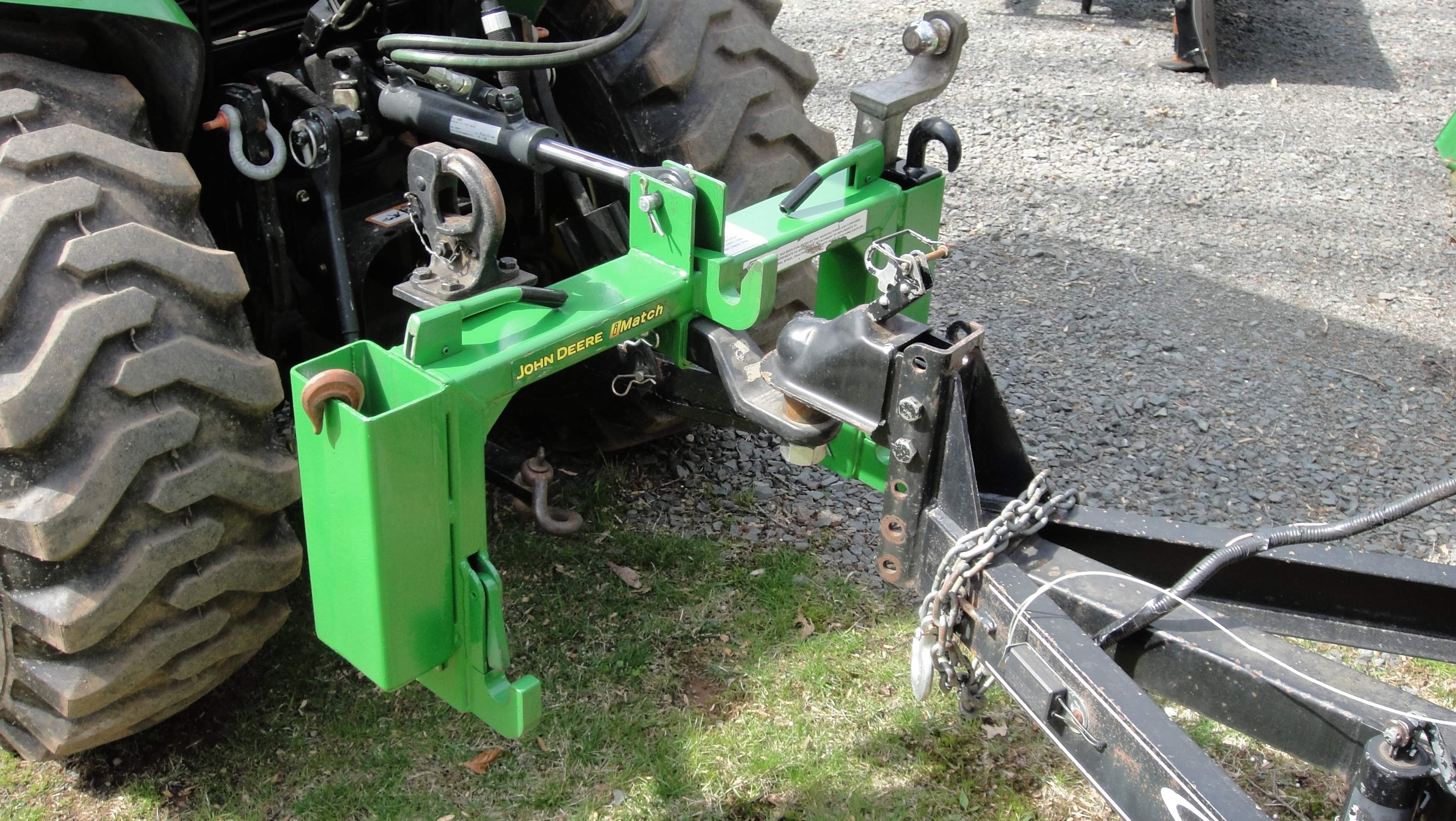

I reckon I'll go a bit further on my original post...
If I had the tools at home to mod my iMatch or the implements, I'd probably like it a lot more.
So far, it fits the RFM (a Frontier set up for iMatch) and a Deere ballast box. These are the two implements most frequently on the 3PH.
It wouldn't fit the RFM I had before the Frontier. It wouldn't fit my old rear blade and it won't fit my chipper.
Since I sold the older RFM (for reasons other then the iMatch fitting) and the rear blade (which I hadn't used in years)...kind of a moot point.
So, now I have the chipper to mod (which would require the upper attach point lowered AND a longer PTO drive shaft) and maybe my rotary cutter (didn't need it last year).
I must admit, for the implements it does fit...it's really handy!
