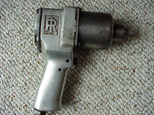

Side view.... possibly this belongs in the Smithsonian, rather than my tool box????? /forums/images/graemlins/grin.gif /forums/images/graemlins/grin.gif

Now I'm not going to say anything for sure, just from the pictures, but . . . I have a few opinions. /forums/images/graemlins/wink.gif
1) I'd say that dimple in the back end is the grease fitting and it should be greased.
2) The screw you saw when you removed the oil plug is probably holding the throttle valve spring in place, although most of them have the throttle valve and spring held in by the air inlet fitting.
3) When you loosened the screws on the back of the tool, there's probably a reverse valve spring under there.
Naturally, Ingersoll-Rand says to use their own grease in their tools, and they actually have more than one grease. The original grease in a 2131 is a different color than that in the 231 and many others. I used the Ingersoll grease for the 231s in all the air tools I worked on (regardless of brand or model; came in one pound cans) and never had a complaint. Most of the mechanics used just whatever grease was in the grease gun on their job. And of course any grease is better than no grease.
Too bad we don't live closer together 'cause I'd just have to take that tool apart to see what's in there. It's a little different, but does look very similar to one an uncle of mine has had for about 50 years, and I cleaned it up and made it work a little better, but it was simply worn out and no parts were available.
