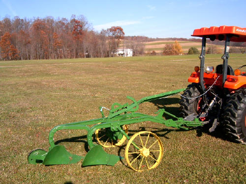

Chris,
I picked up this old JD 2 bottom pull type plows in poor looking shape for $50.
A few hours worth of repairs and painting and they are working and looking great.
(attached)
   / Implement Decision #7
WoW! super nice pull plow.. I'd have jumped on that for 200$..
I paid 195 for my dearborn 10-1 2-12 bottms plow... Those old plows had better frame strength than modern ones in the same price range..
Soundguy
