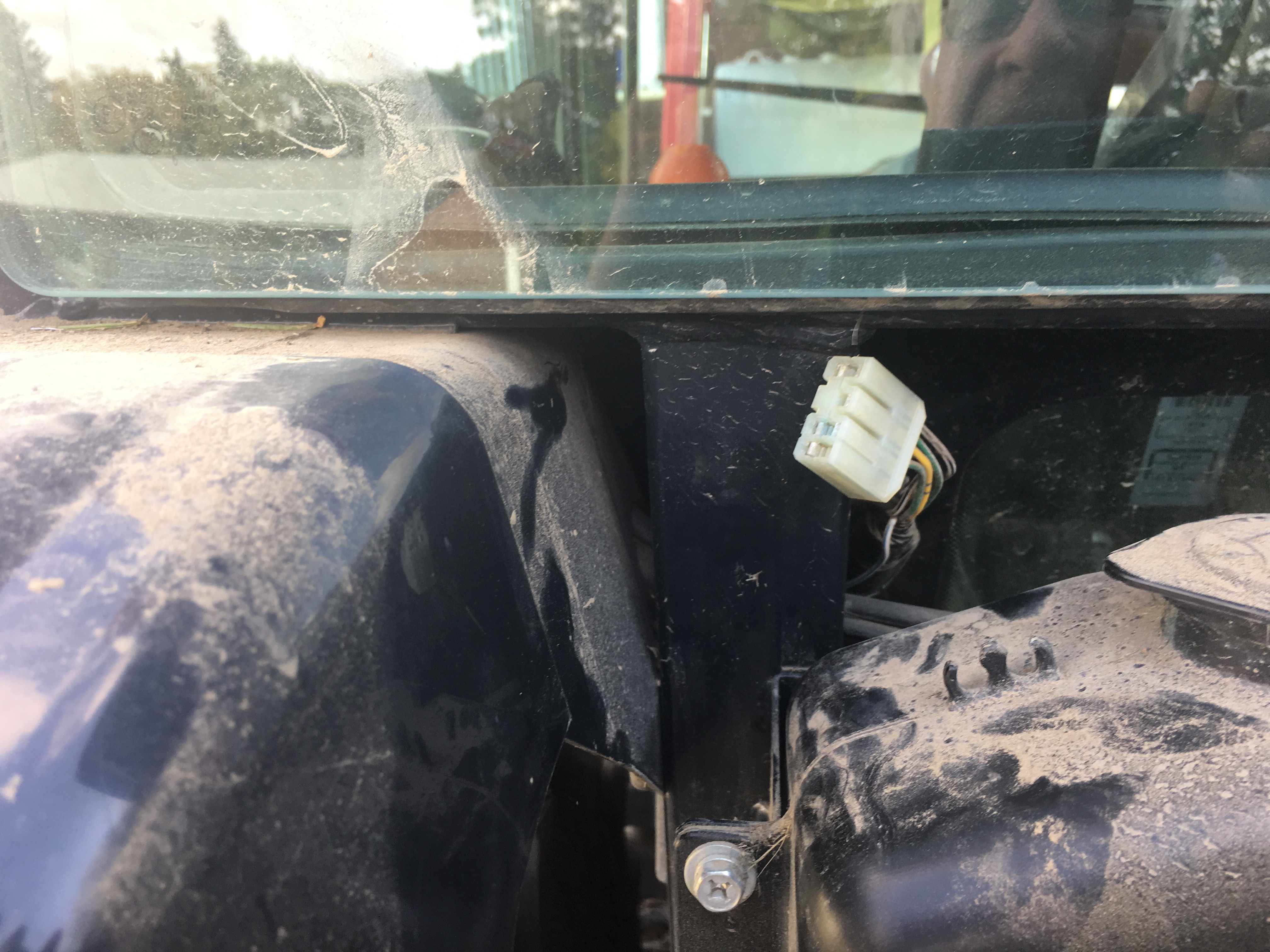

The one thing I think would be great to do is add the ability to use electric trailer brakes.
Another option for the plug is to use something like an electric sprayer and in that case a 7 wire RV plug would be a good choice.
   / Implement lights connected to MF GC1705 #12
Not a big fan of Scotchlocs either, but they do work.... Yes I'm old school strip, solder, tape...
Dale
Correction. It’s “SMART school”, not “old school”.
   / Implement lights connected to MF GC1705 #13
Not bad idea..The 7 pin.... Gives you option to have 12 V dc power to rear (easy connect), and the lights, and yes the possibility of trailer brakes....
It really depends on how far one wants to go with this....
For my DC power I chose to ignore the builtin (controlled by ign switch) for a switch on dash and two pole plug/socket.... So I can run sprayer or what ever with engine off (all electrical systems not powered up) ....
Dale
#14
The trailer already has a flat connector so I will be going with that. I figured the only option was to connect into the backlights somewhere. Thanks for all of the replies. :)
   / Implement lights connected to MF GC1705 #16
Seem to remember reading that Massey has a pigtail on the left rear already in place. Might do some looking.
   / Implement lights connected to MF GC1705 #17
I am going out to try my new Piranha bar for the first time this afternoon so when I get out to my property I will take a look at mine although I did not see anything when I moved my lights to the inside of the ROPs I was not looking for a trailer connection at that time.
Jim.
   / Implement lights connected to MF GC1705 #18
Prob not an actual trailer connector, just a plug for extending to a trailer plug, if that makes sense.
   / Implement lights connected to MF GC1705 #19
Not the same tractor, 1742 has this. Didn’t check with a test light, but seems logical DBD1FFF2-E453-447F-A0A3-D0D1B820CFCC.jpeg
   / Implement lights connected to MF GC1705 #20
IT does, but its a single 12v supply for accessory power and it is controlled by key switch.... There is no pigtail for "trailer" lights...
Dale
