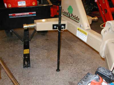

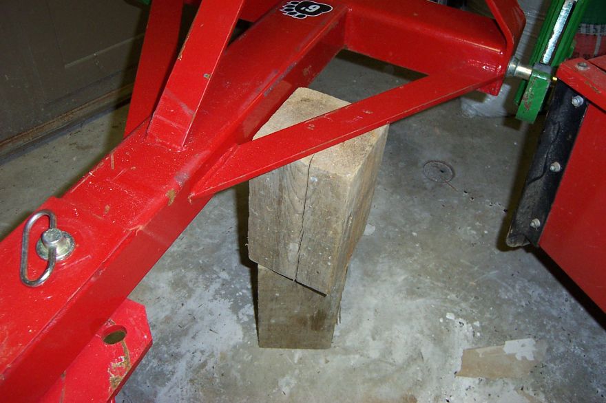

My Kodiak 6' Landscape Rake needs something other than blocks of wood to hold it in position. What have you folks designed/fabricated ?? Any suggestions will be appreciated. Thanks, Eric

Looks familiar. I had the same problem on my landpride rake. Let me get a picture of what i made.
   / Implement Stand Ideas ?? #3

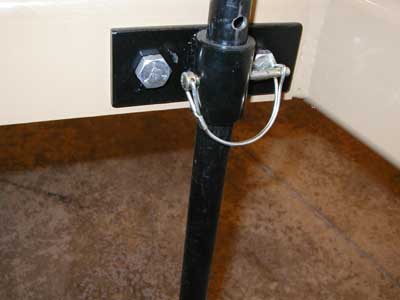

A short piece of 1-1/4" pipe welded to the frame with a pin hole drilled in it. Then a 1" pipe with two holes drilled in it for the leg also with a flat plate for the foot. One hole for holding the implement up and the other for storage when the implement is in use.

   / Implement Stand Ideas ?? #5
sorry dial up and im having problems i'll get you a picture some time
Barnboy....
Thanks for pic. This is similar to what JerryG explained. I like that design/setup. I appreciate you sharing that with me.

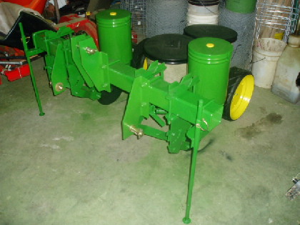

Here's the stands I built for my #71 Deere planter

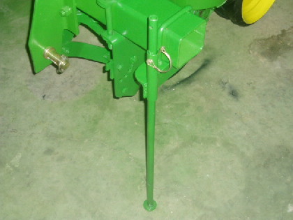

   / Implement Stand Ideas ?? #9
'Nuther view of the same.....
