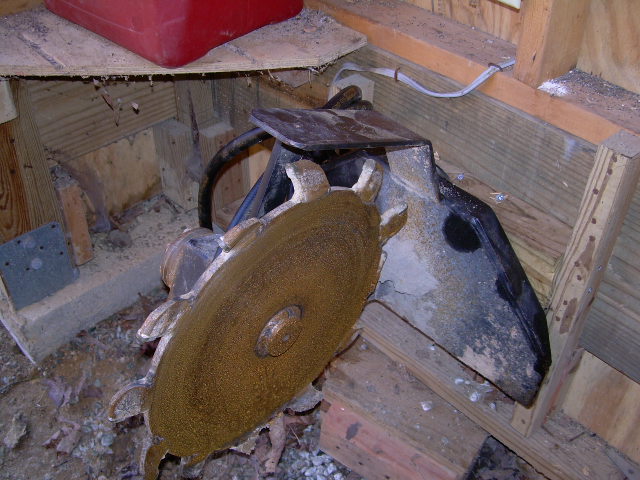

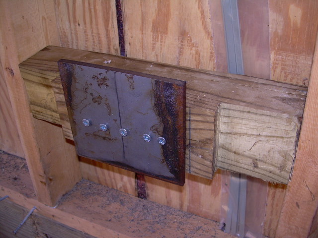

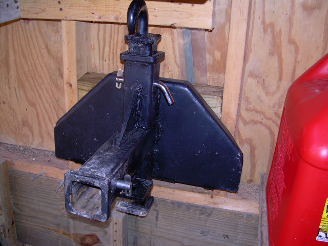

Here are the pictures of the hangers. I am not sure it is strong enough for the stump grinder. It holds it but I heard some cracking. I added a hold up strap. I added a 2 X 4 wood spacer for the one holding the stump grinder and it cleared the hoses. It also weakened the unit.

Very nice. Gets the job done.
I think if I were going to make another one of these for a heavy attachment, I would use a 6 X 6 piece of wood and run bolts through the plate to the back of the 6 X 6.
