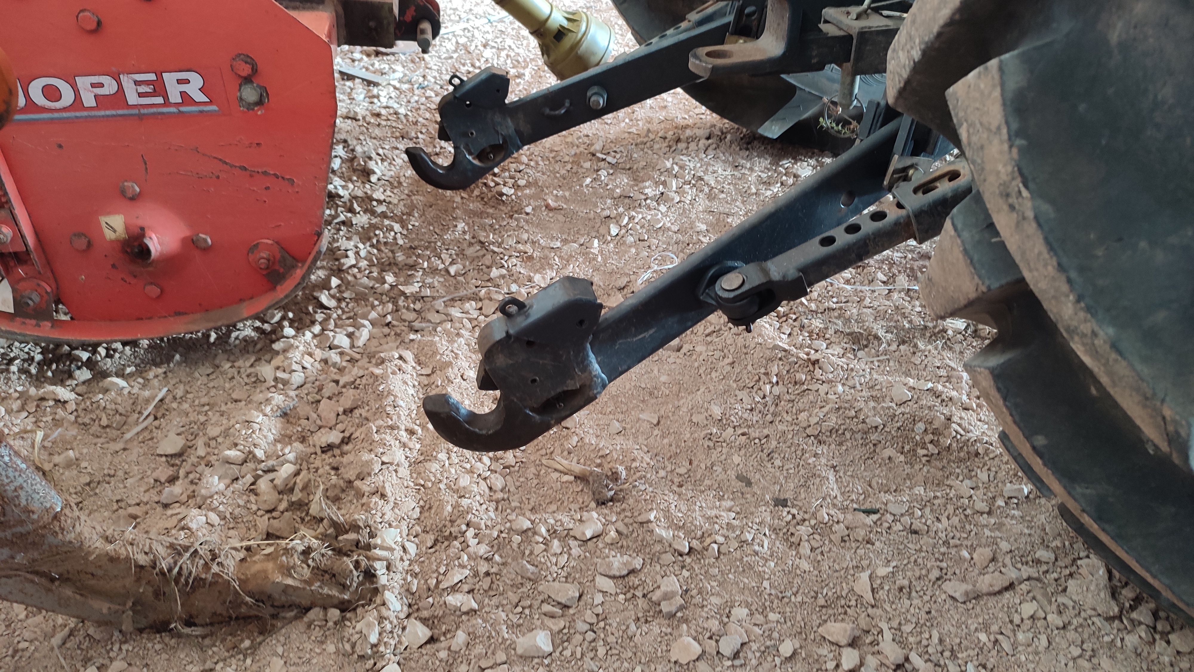

I vote for the Euro hooks/Lower link hooks. You won't regret it. Easy to use, lasts a life time, trouble free and for how well it works, not that expensive (About $300 for the Cat 2 kit on AgristoreUSA).
It does require cutting the old links out and weld the new ones in but it's worth it. This applies to the tractors that don't come with it as standard.

They telescope, just remove them. You can mail them to @MtnViewRanch and he will send them back ready to go.
My tractrs both have telescoping lower links as well and you cannot EASILY remove them. The boss that carries the telescoping end is securely welded to the end of the arm. Why I never pursued Euro Hooks or Pats is because the extendable lower ball mounts work just as well for me. If the weren't, I would have but because they are, I never considered it.

To add the Euro hooks to extendable ends, you simply pull the pin that keeps the end from falling out, rework the existing end and slide it back in.
The removal and reinstallation literally takes 1-2 minutes.
I can't say as to what you guys think that the issue is? :unsure:
And YES, the Euro hook ends add 2 1/8" to the overall length when properly added on.
In a perfect world, you would be able to slide out the standard links and slide in a set with euro hooks on them. But, that would make things too easy.
To the OP, I have a Speeco quick hitch and it works well
This can be done, most people don't want to spend the additional money vs reworking the existing ends.
