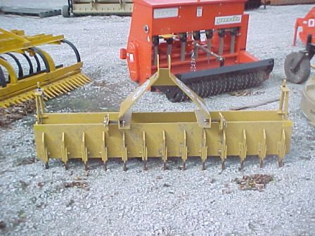

What about a 5 foot pulveriser, looks like that would work very well on a MX track.
Sherpa

- Can anyone educate me on RobertN's Gannon roll-over scraper idea. That may be the ultimate weapon. I have one remote hydraulic in the back. I suspect it's like a box blade that lets the dirt flow freely out the back(?)
- Same for sherpa's pulverizer idea. I attached a pic of one found in a search.

Here is a web page with a small roll-over box on a Kubota BX.
www.geocities.com/runnernest/BX22.html
www.landpride.com/cgi-bin/byteserver/manuals/lp/pdf/303-082p.pdf
I will take some pictures of mine this weekend.
To give you a rough idea, the scraper is set on a bar/pivot. It has three positions. In the first position, the ripper face down. This allows deep ripping(mine could go about 12-14" if I had the wieght and power to pull it.
If you pull the trip lever, you can flip it to position two. this would place the ripper to the rear, up out of the way. The scraper blade and box are no facing forward, allowing you to scrape going forward.
Again tripping the lever, the whole thing rotates, for the scraper is facing backwards. this is great for pushing stuff backwards, or for smoothing.
I will have to take pictures, because it is hard to "picture" with words...
