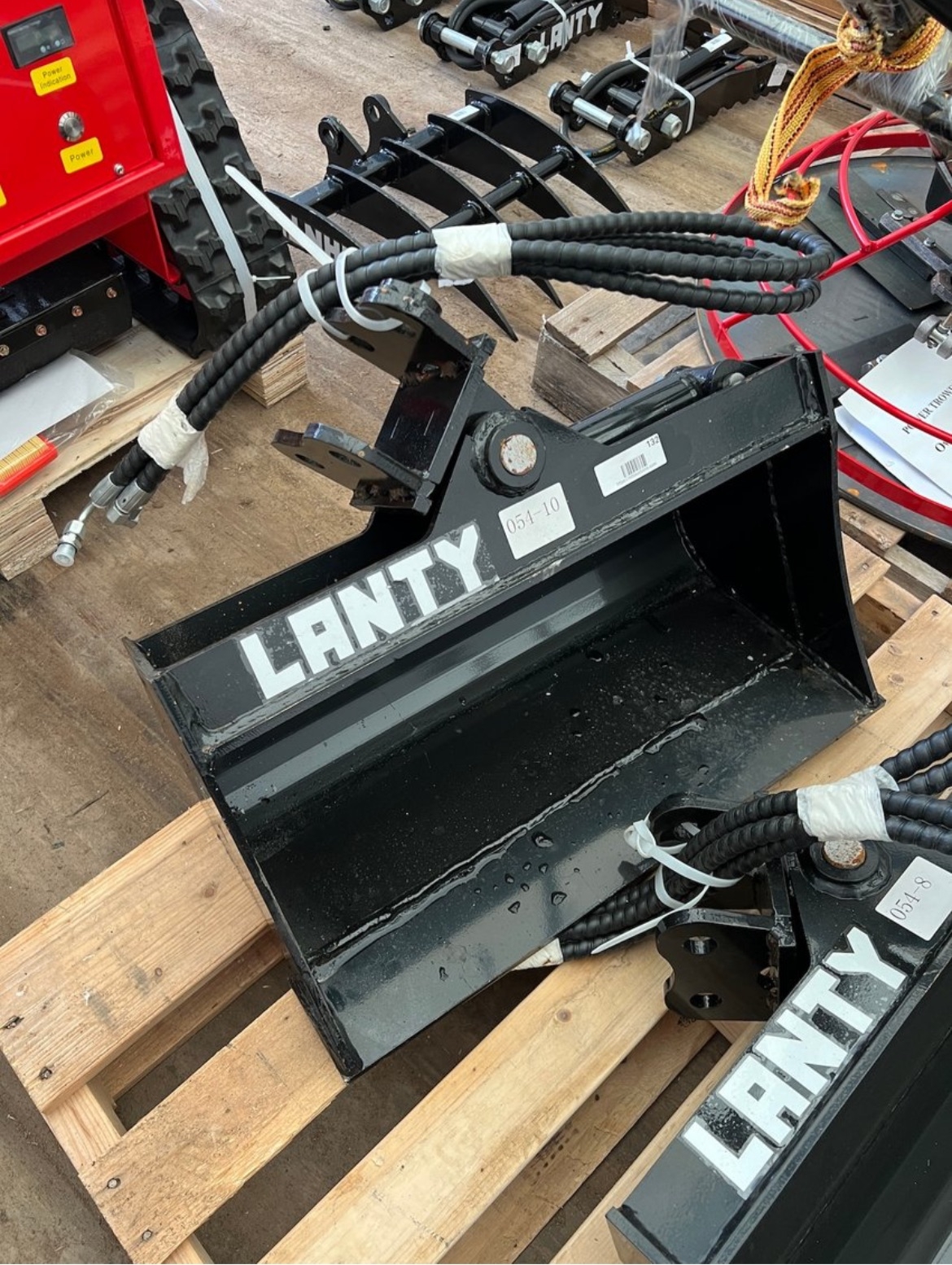

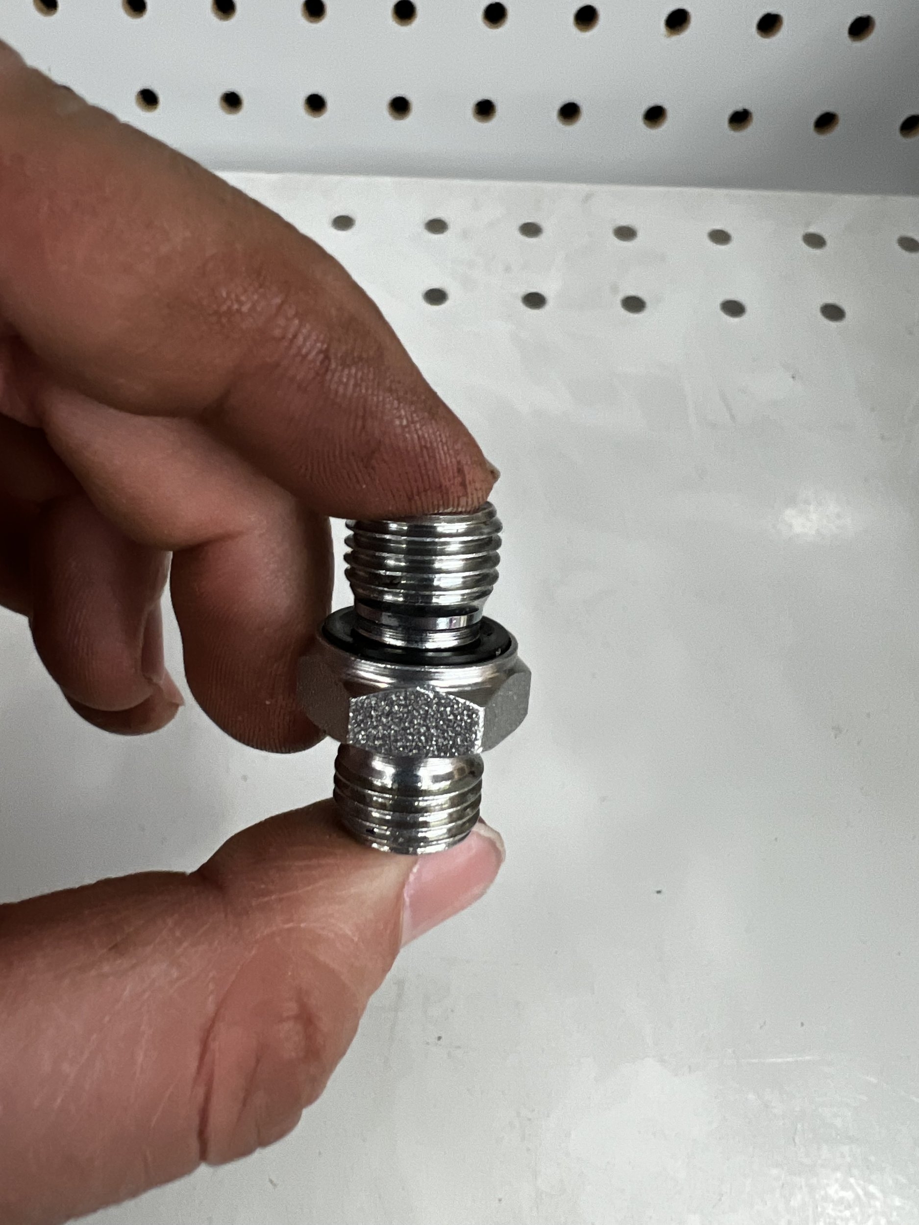

Is there any chance you know what fitting this is and where I can get one? It’s off a Lanty tilt bucket it came with two fittings and one is missing. I’m striking out at all local hydraulic outfits. It screws into the cylinder on the bucket and then the other end screws into the hose. You can see the one fitting I have screwed into the end of the hose in the picture.

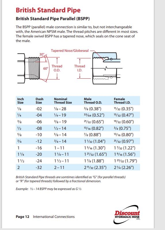

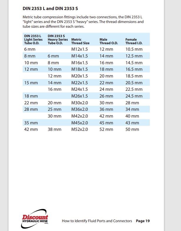

Can't tell from a photo. You need to look at a thread ID table and use calipers. I use bolts of known thread pitch to ID the threads.
DiscountHydraulicHose has free thread guides. 2 pages excerpted here. My guess is a 9001 metric to metric, or a 9004 BSPP to metric.
Appreciate that. I didn’t know if there was a general thread size these machines used. I believe it’s the same thread as the two hydraulic blocks that are on the arms of the excavators are since that’s where the other end of the hose screws onto.

- - - - Messing with either of the RVs on an em 15 - prob should figure out a gauge first, but if you haven't traced the hoses yet to figure how to flip controls I'd say there's more to learn before trying to get a gauge on there. (Like yes the thread type of the fittings.)
My em 15 used 16mm for that port block thing, which I deleted. Most of the rest I've found on it are 14mm.
The fittings/thread should all be DIN 2353 style/type.
Link to an appropriate sized adapter I used to convert an attachment to the aux hose end.
Keep in mind there are many 'DIN' types, the closest one to 2353 is different only in the interior chamfer angle. And some places call them by their tube size. IE 14x1.5 mm din 2353 can also be called 10mm tube din 2353
