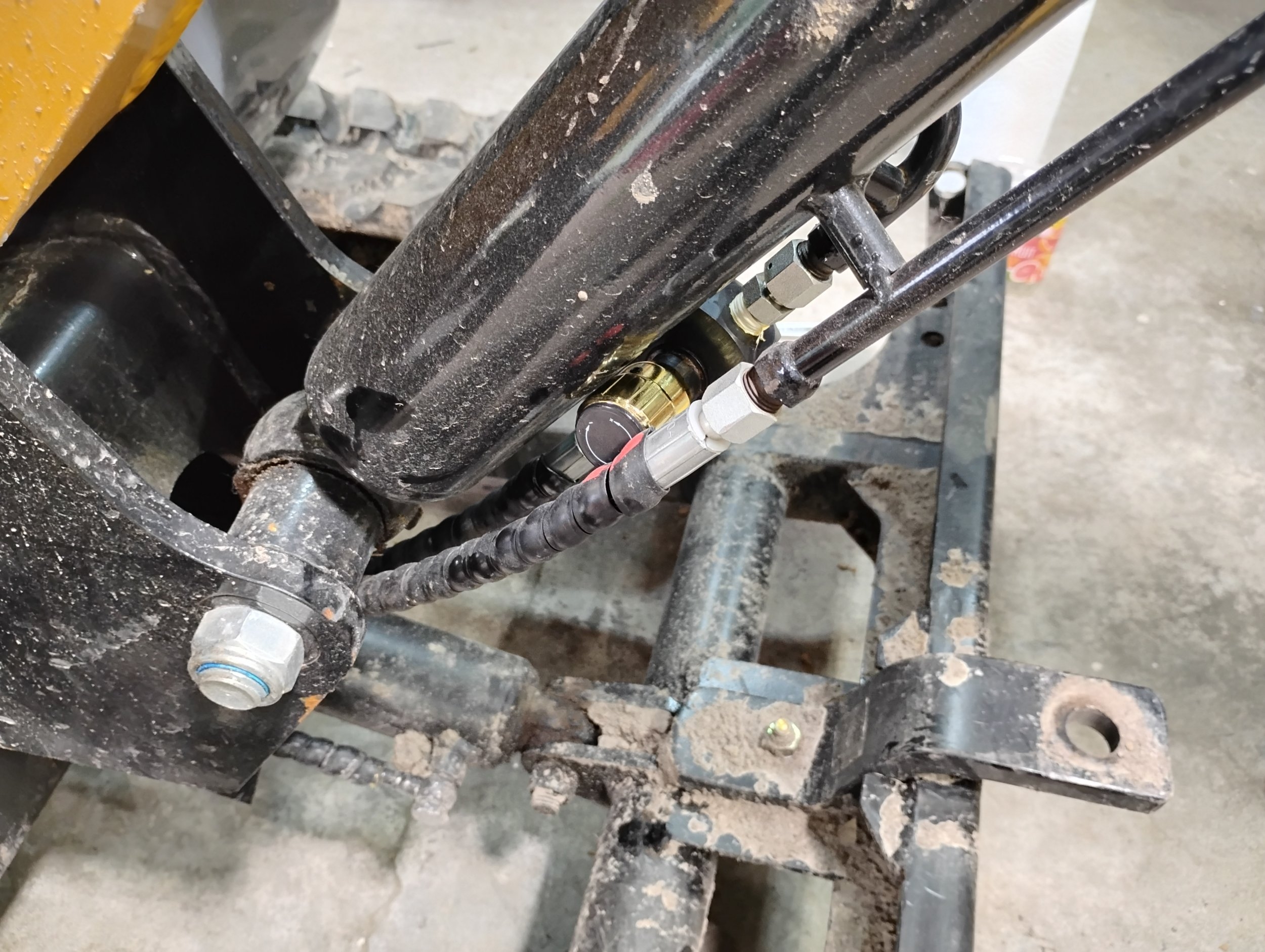

I have a AGT DM12-C and want the swing boom to be DCV and the auxiliary to be electronic.

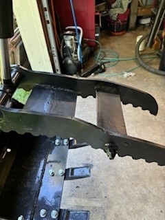

Very strange offset upper pivot for the OEM hyd thumb on the DMC-12. It looks like they did not remove the mechanical thumb brackets (as I did) to install a hydraulic thumb. The geometries are totally different.
   / Importing and modifying a new mini excavator from China #1,482
This is why I think they installed parts in the wrong place at the factory.

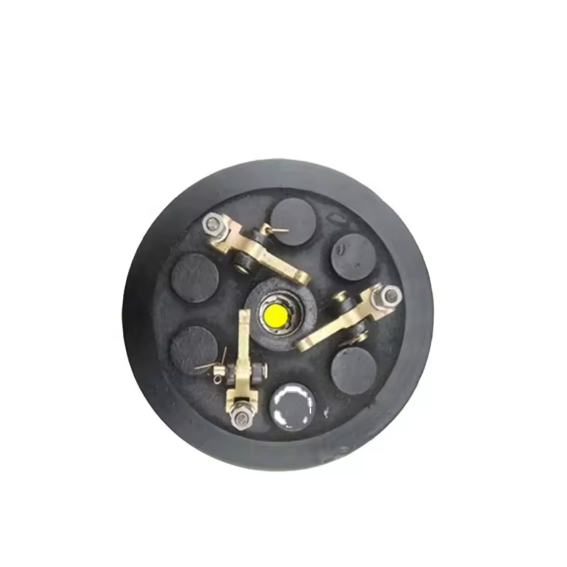

Interesting update on the runaway "feature" of the track drive motors on virtually all of the 1-2T Chinese mini-excavators.
It seems a few people have been successful getting their Chinese mini-X supplier to replace both drive motors with new ones that have have an added valve block with counterbalance valves. These are essentially hydraulic brakes.
Everyone who buys these machines from an importer like Agrotk or Kymron needs to request this very important safety upgrade. Auction buyers are kinda SOL, but direct requests to the factories in China is something to consider.
Any followers of Howard Kettner on Utube? He posts his upgraded motor replacement here:
Looks just like the upgrade I posted before:

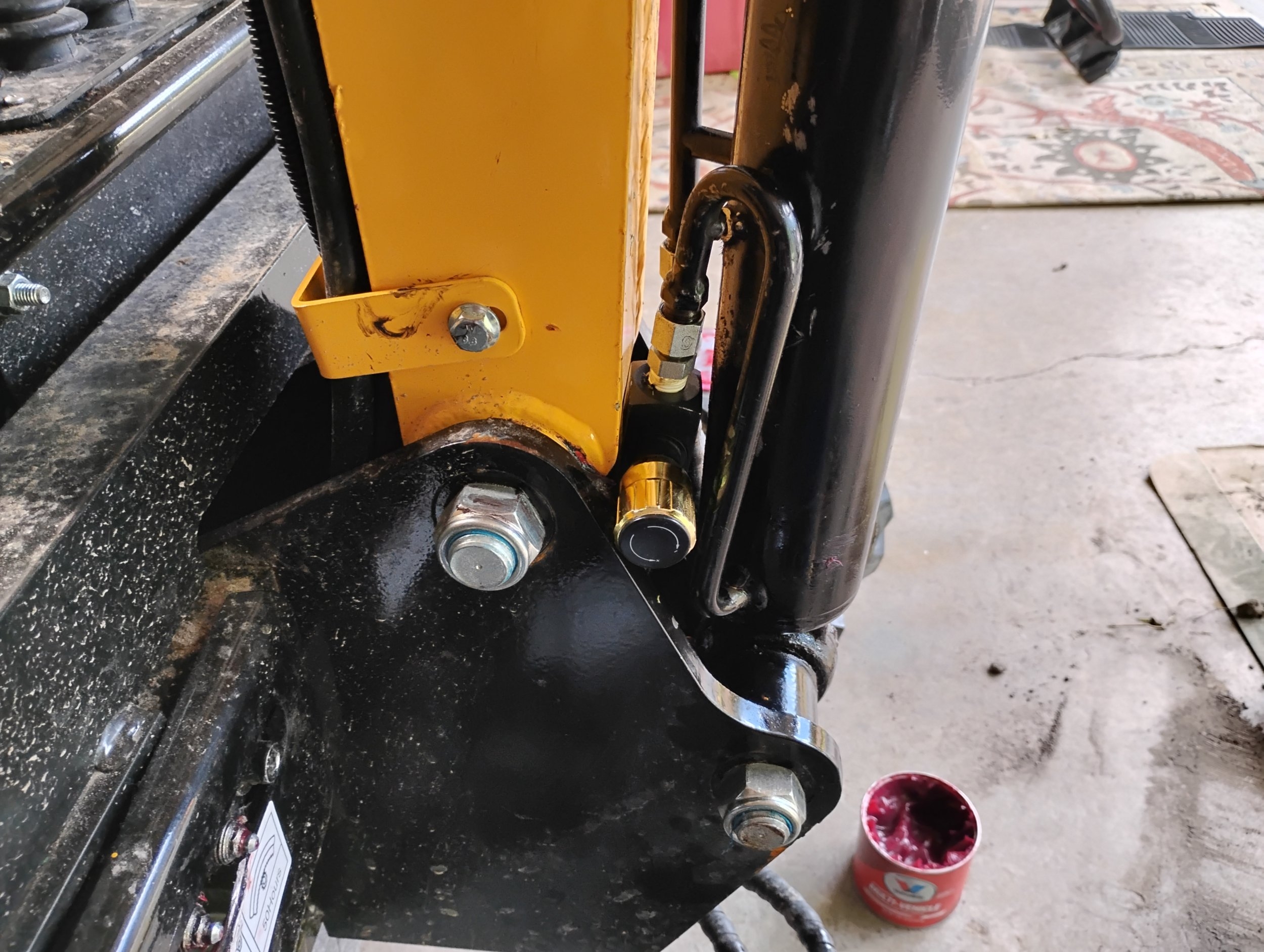

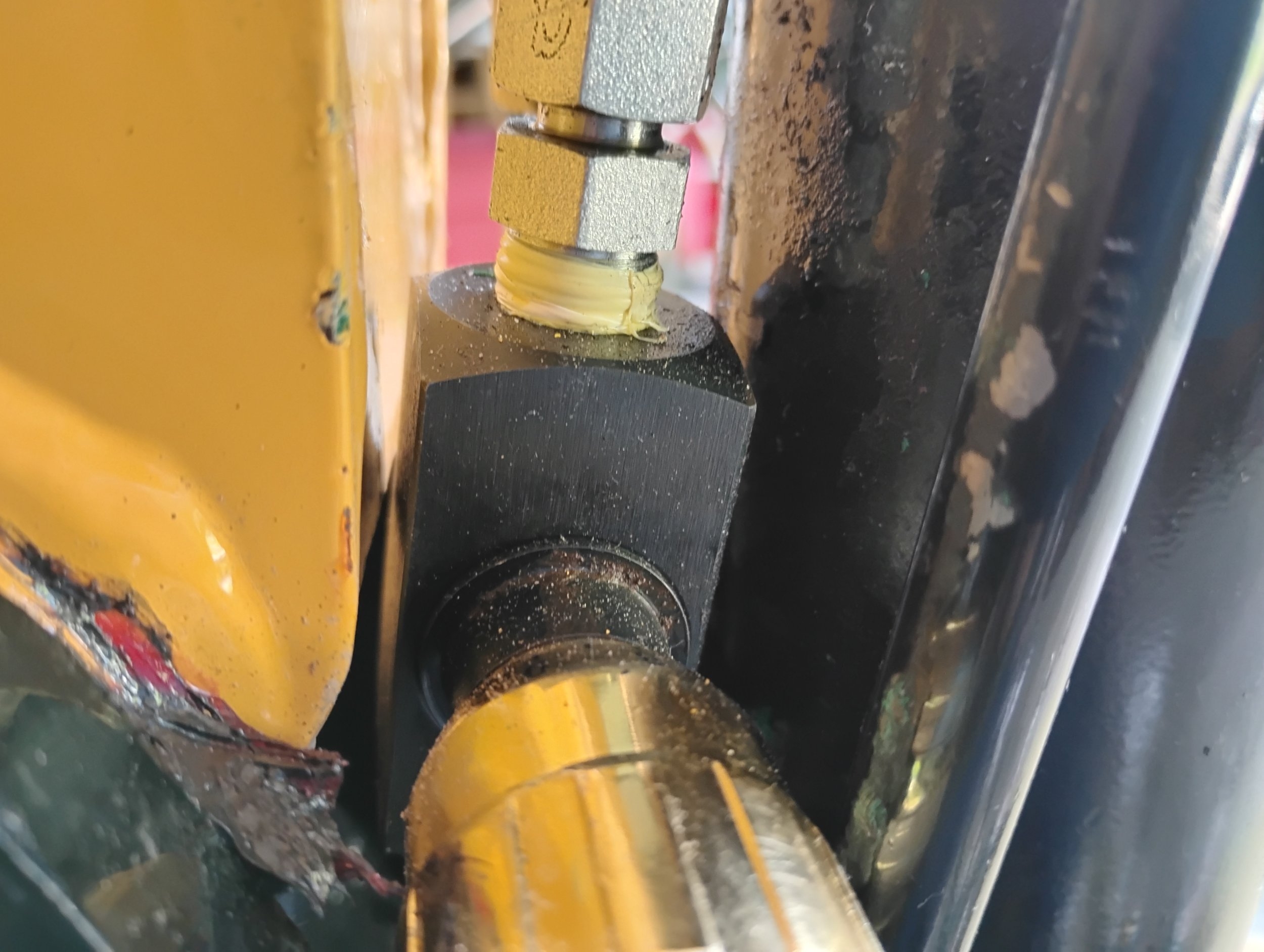

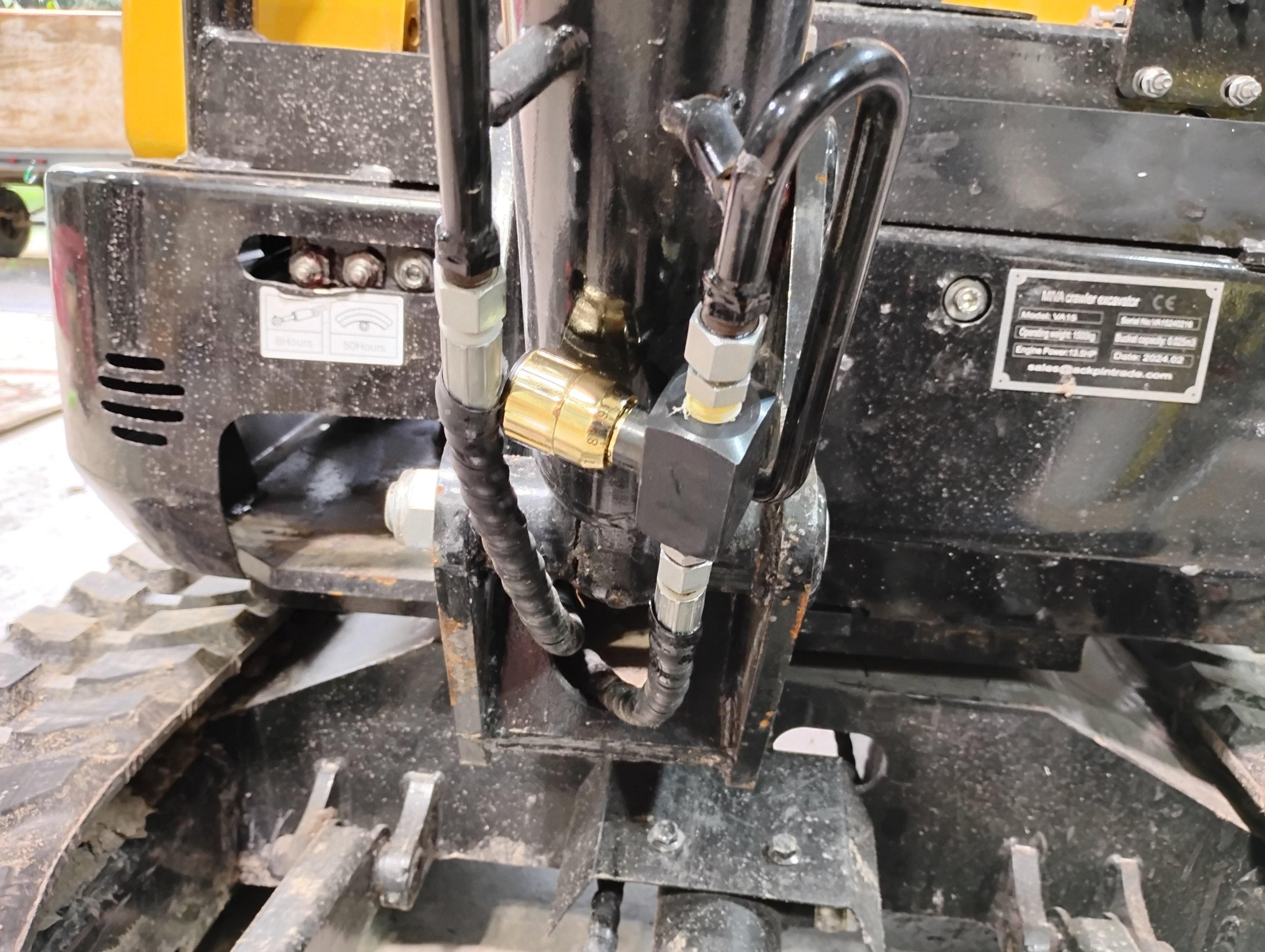

Does anyone know where to find a fitting for the hydraulic tank return? I originally thought it was an DIN L18 but it appears the threads measure out to ~27mm and not the 26.5mm that the spec calls out for. Needless to say, the the female L18 will not thread on. I am trying to add some filtration without rebuilding the entire hydraulic system.
Alternatively, has anyone just cut another hole and added a bulkhead fitting for the return?
   / Importing and modifying a new mini excavator from China #1,488
Cam Sweet from Garage Connection and Central digger supply had a video some time back about some of the import diggers have an L18 with 27 mm threads not the standard 26mm thread. And that fitting was not available outside of that one fitting supplier from China. His issue involved the hydraulic cooler and filter kit that he sold for the H15, and some were being built with the 27mm not the 26 mm fitting.
#1,489
I welded in my own fitting. Go to post #31.
Make sure that fluid return does not aerate the oil, by being placed too high on the reservoir.
   / Importing and modifying a new mini excavator from China #1,490
I found manufactures of the fitting in China, the fitting does exist but it is a crimp/swag fitting only. Mine is definitely the nonstandard L18 fitting on the tank. Time to cobble something together it seems.
   / Importing and modifying a new mini excavator from China #1,491
I figured this was going to be the solution but was trying to avoid it. Thanks for the tip on oil aeration.
