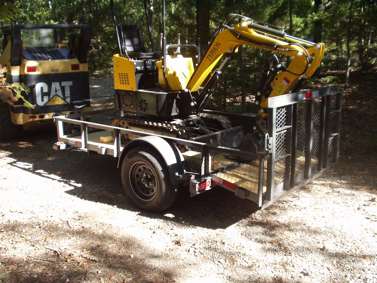

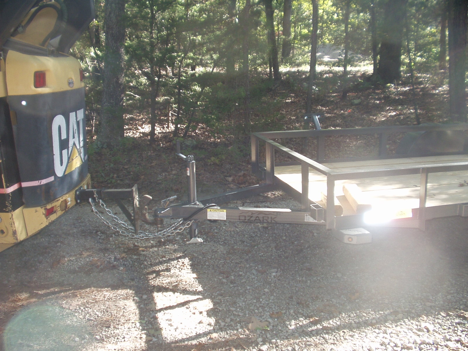

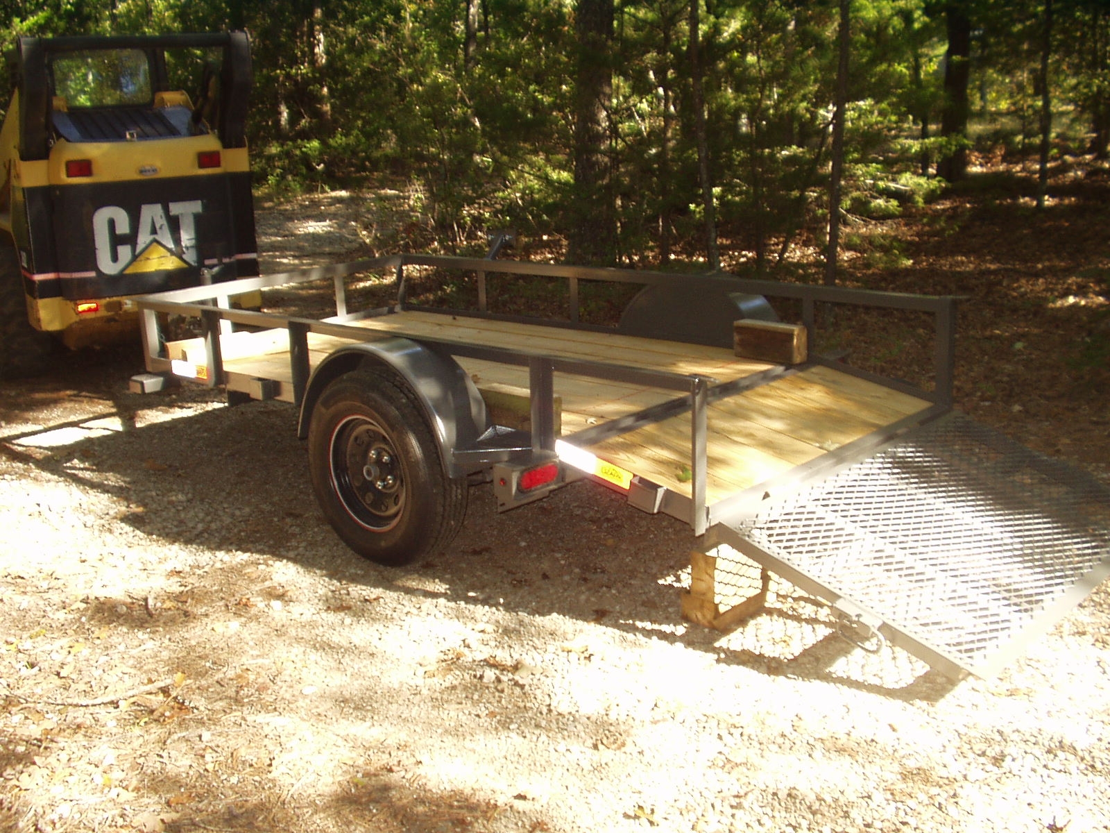

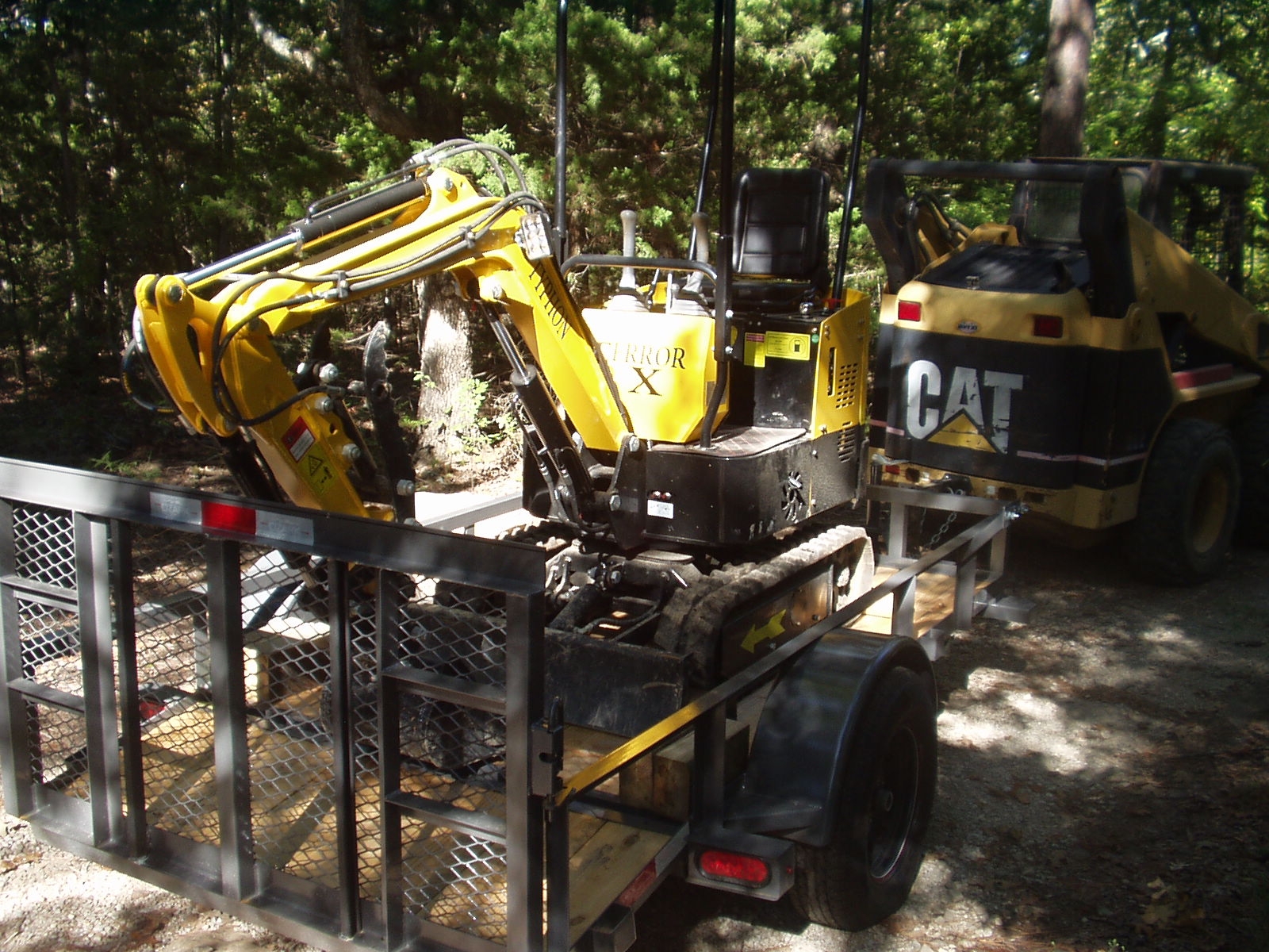

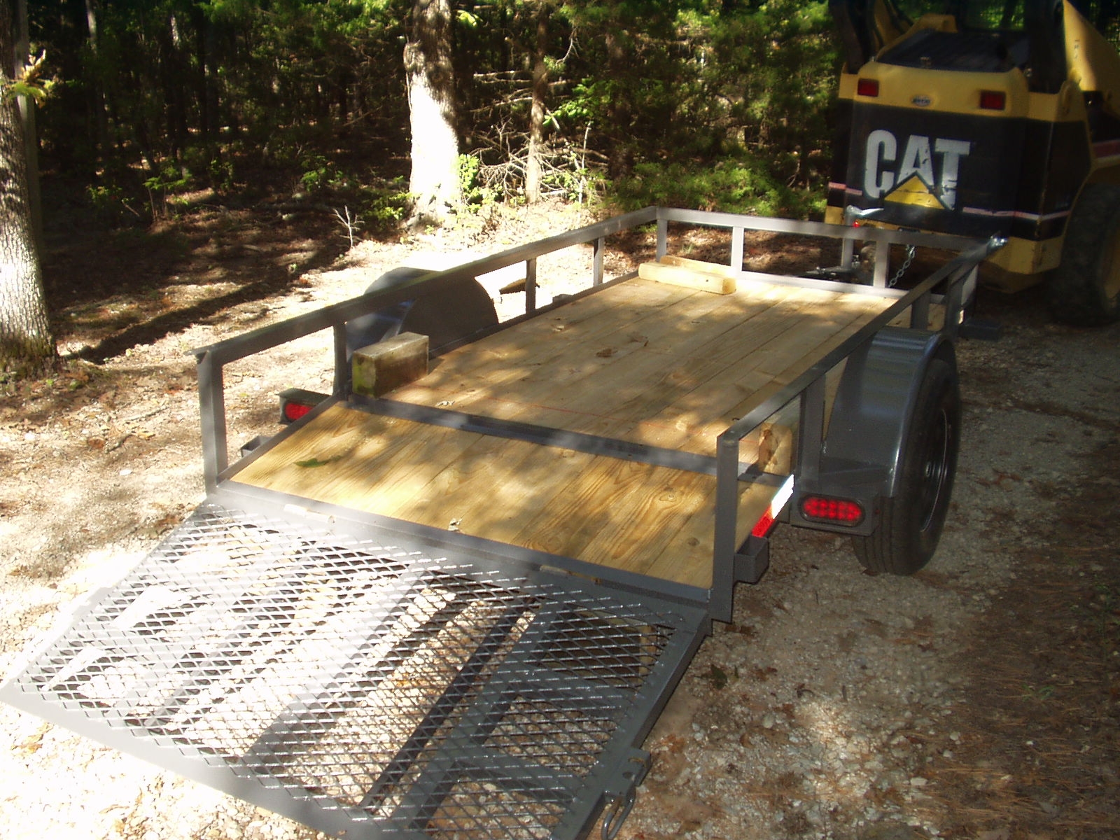

Because the little unit travels so slow I just bought a small trailer to move it about. It is a 5 x 10 (8 X 2 ft drop deck) with 3500lb axle.
ETA: Some pictures and observations. The first time loading the Ex on my trailer went pretty good though a few things should improve with practice. I am going to have to add ballast to the front of the skid steer though if I am going to pull the setup. I noticed quickly on a small incline the front tires feeling light and ready to rise off the ground. That would be not good.
