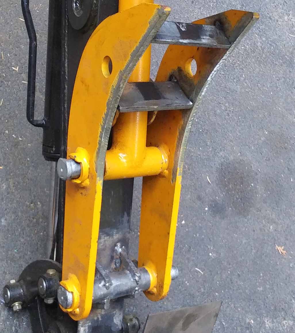

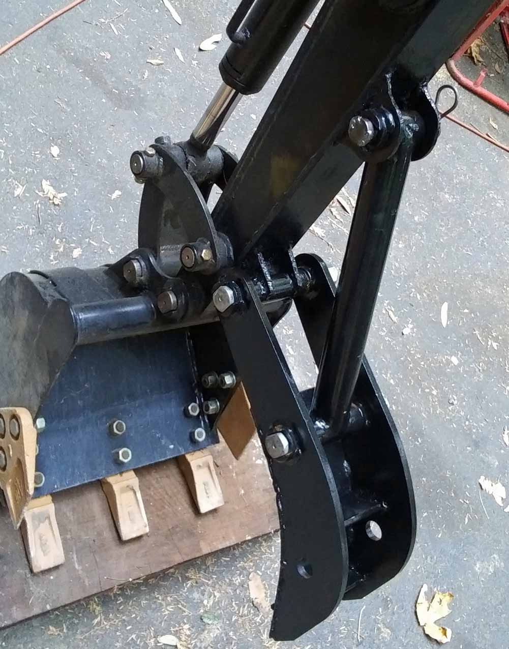

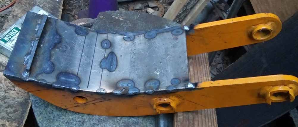

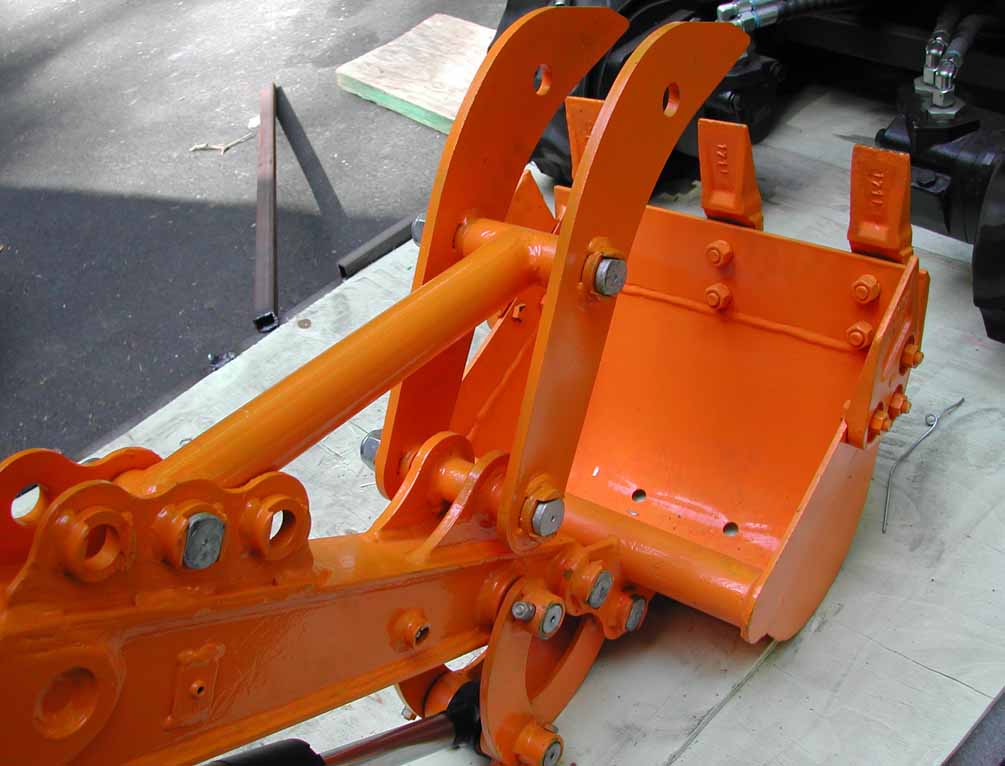

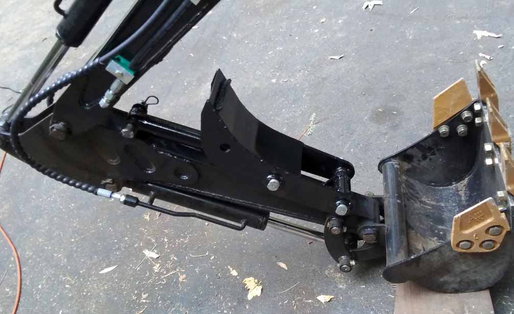

I bought the yellow mini with a mechanical thumb (post#21), but I went with a hydraulic unit that I fabbed up. (Once you've gone hydro, ya can't go back.)
Well, the black mini, which I have just sold, needed some kinda thumb, so I modified (fixed) the yellow one and installed that one.
The yellow one included a main pivot plus 6 pin tabs welded to the dipper. Problem was you have to remove the brace entirely in order to fold the thumb into the storage position against the dipper. Furthermore, the thumb itself would not survive anything but the gentlest service. It was a 2-piece design with no bracing between the sides.
So I welded different pivots onto the dipper, including 2 tabs to hold the brace in rest position. I also welded a face and braces to the sides.

Have you considered using carriage bolts on that bucket?
Carriage bolt heads would leave a much smoother surface, so that excavated material would not be as likely to stick in the bucket.
   / Importing and modifying a new mini excavator from China
#177
Have you considered using carriage bolts on that bucket? Carriage bolt heads would leave a much smoother surface, so that excavated material would not be as likely to stick in the bucket.
I have eliminated bolted teeth in both of my buckets, the one for my backhoe, and the one for the yellow mini. See above.
It is not only to reduce the problem of dirt hanging up on tooth bolts, it is so I can use better teeth. The teeth you see here are cast steel, but not as soft as other bolt-on teeth I have owned in the past.
