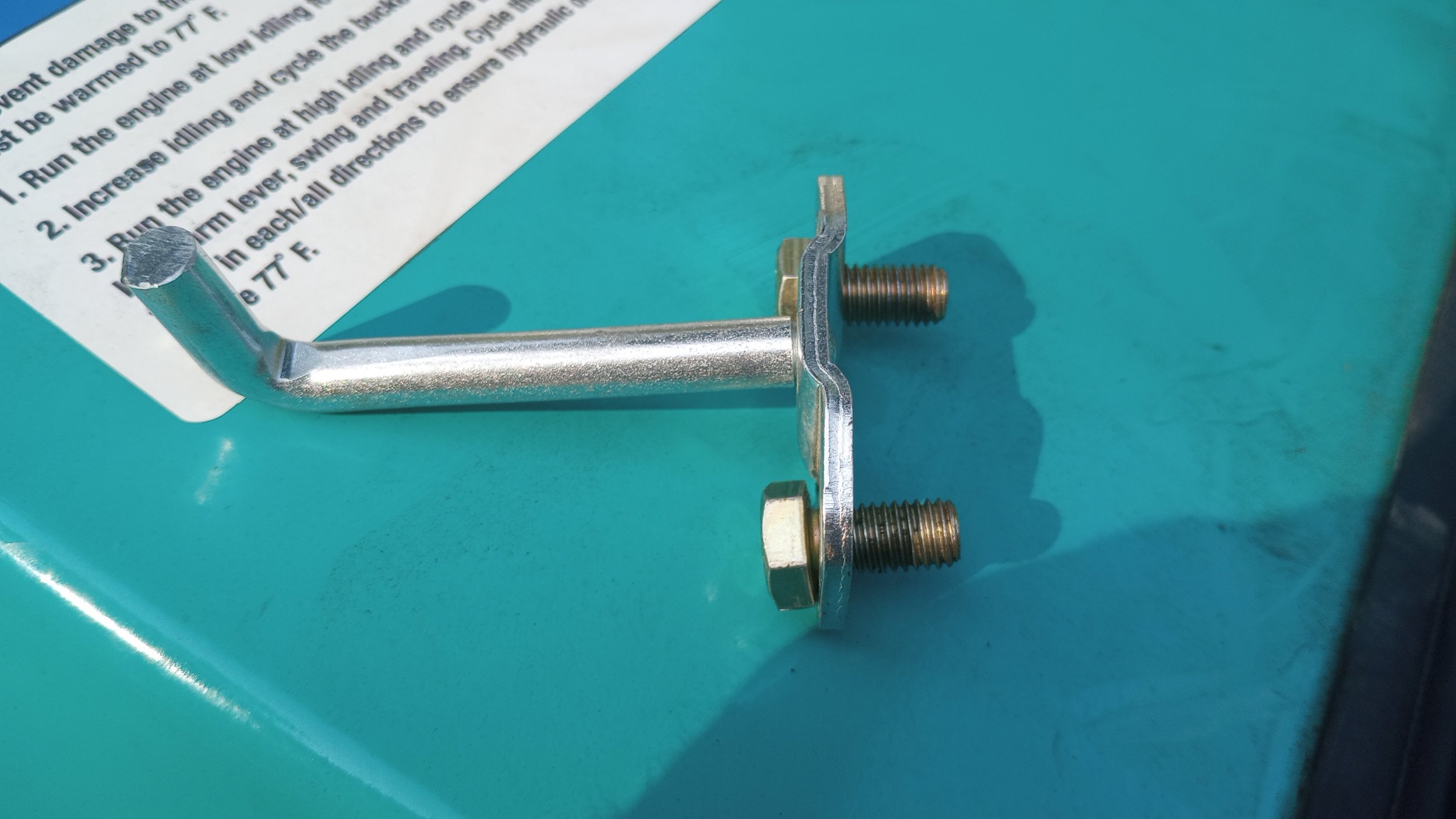

Found the engine house latch sans nuts. This thing just sat there for G** only knows how many thousands of miles . I went over every nut , bolt , and Hydraulic fitting on the machine before even starting it again.

Found the engine house latch sans nuts. This thing just sat there for G** only knows how many thousands of miles . I went over every nut , bolt , and Hydraulic fitting on the machine before even starting it again.View attachment 803669
Reminds me when I got my Jinma tractor. I still have parts that I found and stashed away and never found out what they were for since 2007.
I think they had shop clean up day when they packed my tractor up and threw all the leftover stuff in my crate.

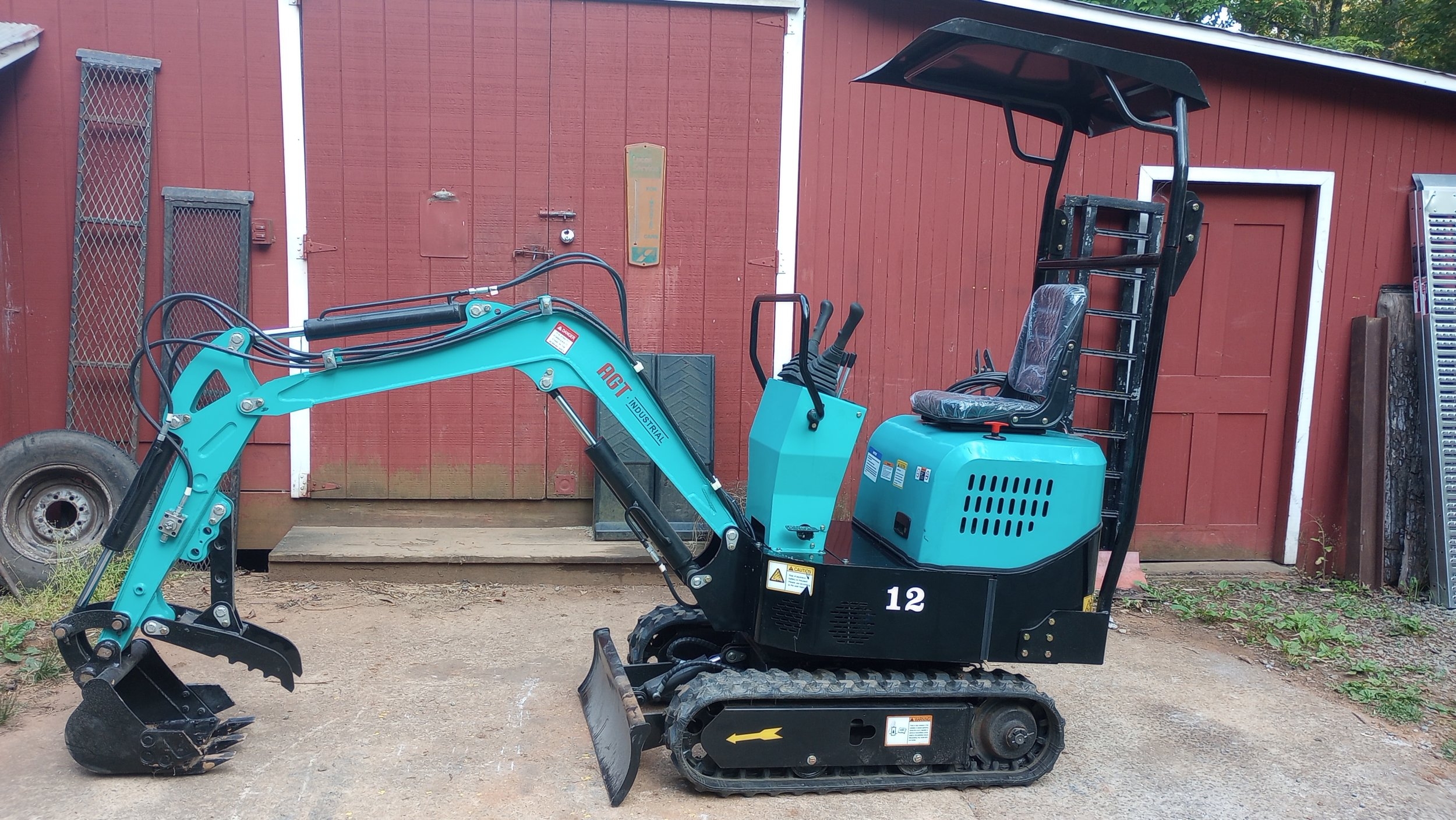

Hey Folks , got some pics for you.View attachment 803641
Nice machine, I like the engine cover access better on that style than standin on my head to check the oil on my style (toaster green also).
I have only seen pictures of that style, but didn't see a filter in the pictures, but I might have seen a Cooler, is there either?

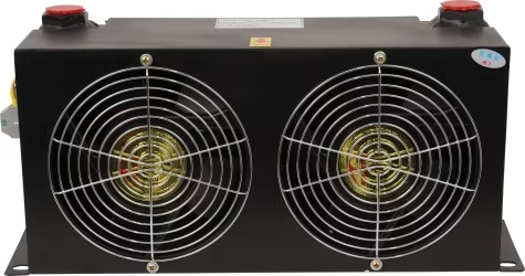

Speaking of Coolers. I think I need to install one, oil is already getting brown with 20 hours.
Before or after the Filter?
The hyd oil is getting brown? That should never happen. One of the first things I did (see above) is get rid of OEM fluid. You don't know what they used, it flushes out manufacturing dirt, and it is likely the cheapest stuff they could get.
Next is install a temp gauge. I use a passive capillary style, and try not to exceed 50C. The hyd motors for the tracks heat the oil fastest.
Finally, any cooler will help, but choose wisely for where you can install it and the current it draws is less than the capacity of your alternator.
If your hyd filter is properly installed, it is on the return path to the tank, which is low, but positive pressure. The inlet side of the pump can be subject to slight negative pressure, so sturdy hoses must be used. This location or either side of the filter will work if installed properly.
   / Importing and modifying a new mini excavator from China #439
No filter - No cooler , nada. Already have the parts ordered. The House is packed so tight gonna be cutting lots of holes .
It gets blazing hot inside even after 5 minutes. Found a 10" fan that puts out 1750 cfm. I can't put anything on the return line, not enough room. Everything will be attached to suction line. Funny thing about this is the hose is a SAE 100R2AT 5/8".
SAE 100R2AT has a burst point something near 1700psi. It's a booger to cut because it's configured as hose, braided wire , hose, braided wire , and then polyester reinforced outer hose. You could pull 80 bar suction and it wouldn't collapse. I guess it's what they had on hand.
