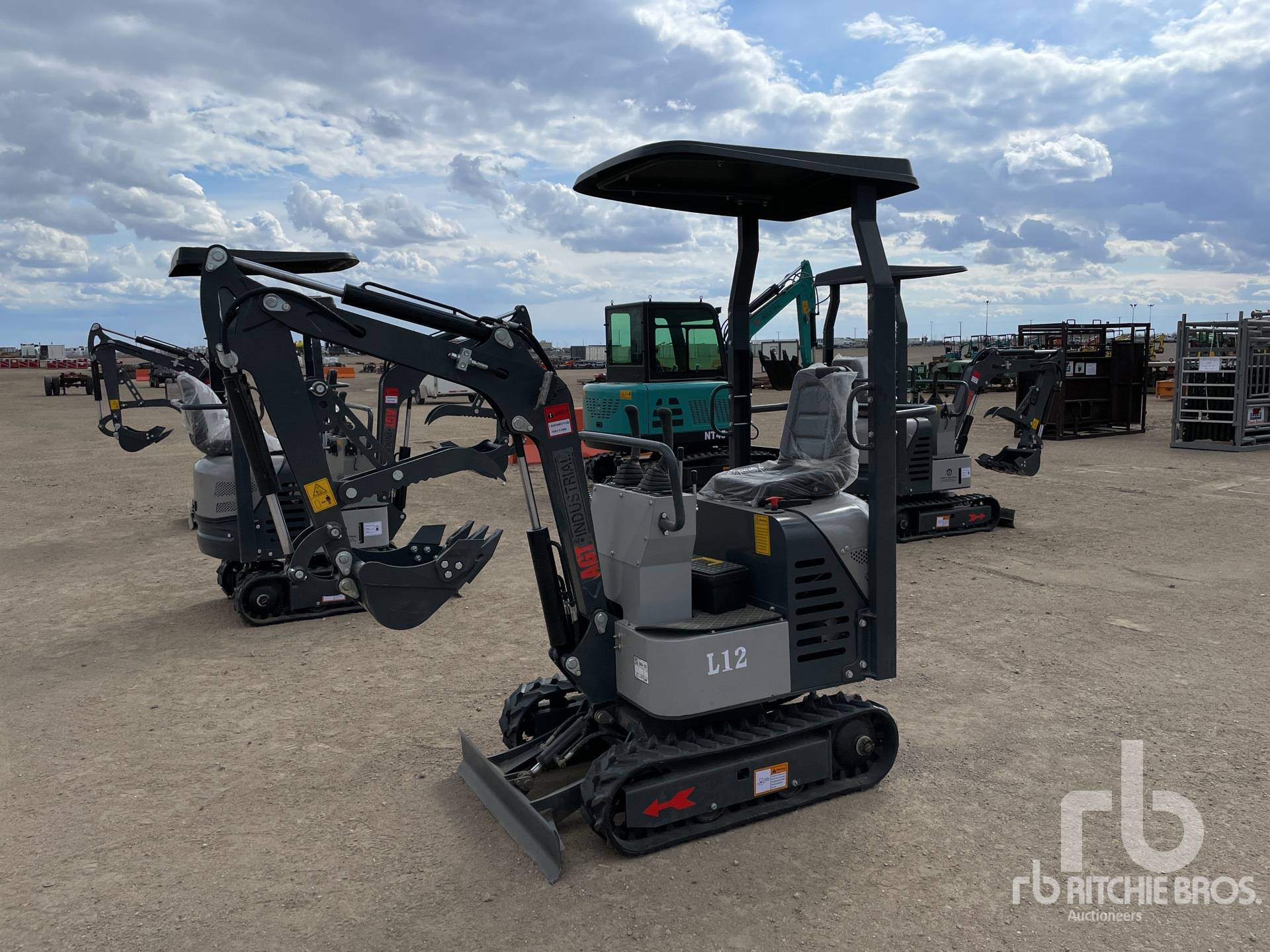

If I had to do it again, I think I would go for the L12. Cooler Included, needs a Filter though.
I ordered an Agrotk QH12 before finding this forum. I paid $6,371.81 on ebay all-in, with about $500 for taxes and shipping included. After getting on TBN seeing this post, I quickly switched over to an L12 at no additional cost! I actually couldn't believe they swapped it but they had given me no info when I asked about the differences between the models. I think they do that on purpose.
So THANK YOU! This post saved me.
The engine is much more accessible in this model and it has the hydraulic oil cooler built in, which is a nice improvement. I'm in SoCal so it is hot down here. The 2 pt ROPS is also pretty damn sturdy. Also I am 6' 5" and fit under the roof easily. Overall I'm very happy.
I am now up to 5 hours so am going to do an oil change. I got some Mobil 1 syn 15W-50. I can't find the oil filter, I don't think these B&S engines have one. Does anyone know?
The grease gun that came with it didn't have a connector nipple, just a narrow connector that was hard to use. I have ordered a new grease gun and some John Deere #2 grease. I don't think things are greased adequately due to the lack of connector and my inexperience.
The hydraulic oil filter will be my first mod. Not sure when I'll do that, but probably in conjunction with the first fluid change.
Congrats on the Hoe. Still working the heck out of mine with 65 hour and counting. The L12's and Diggits haven't migrated to Canada in masses yet so the QH12 is the same unit as my JF12, Hydraulic Filter and all. So even if I don't sell it, the Parts alone will be worth what I paid.
