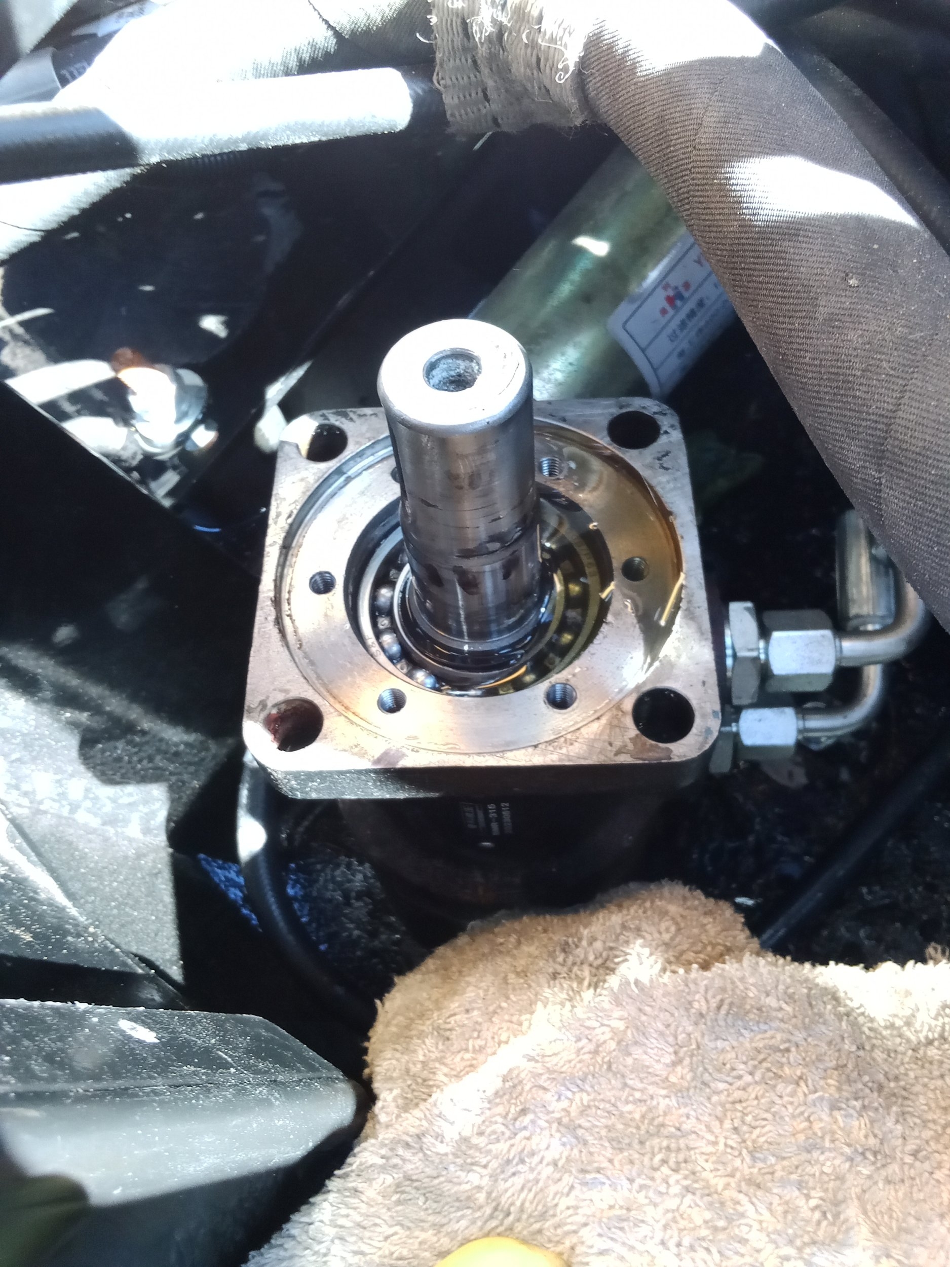

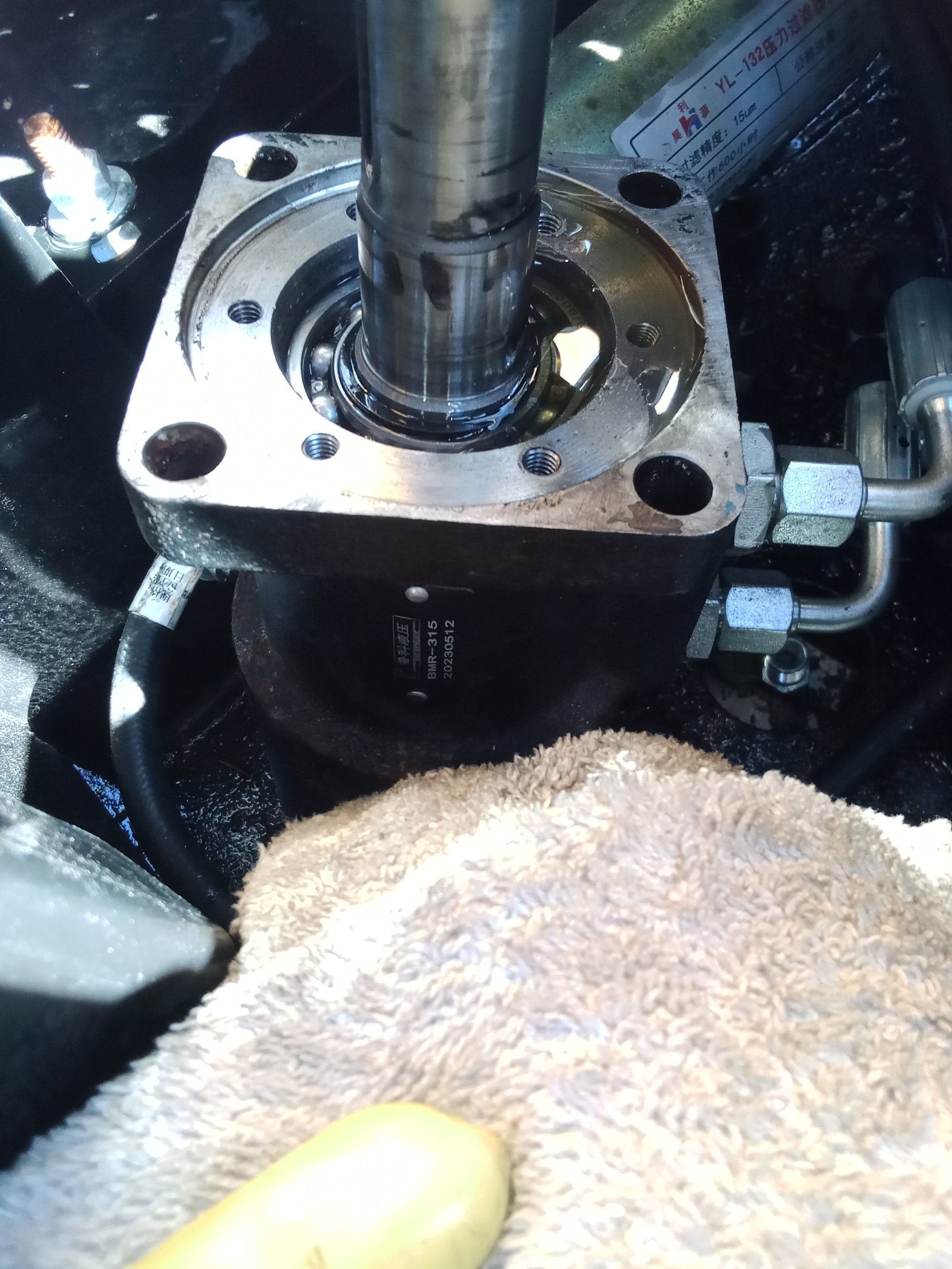

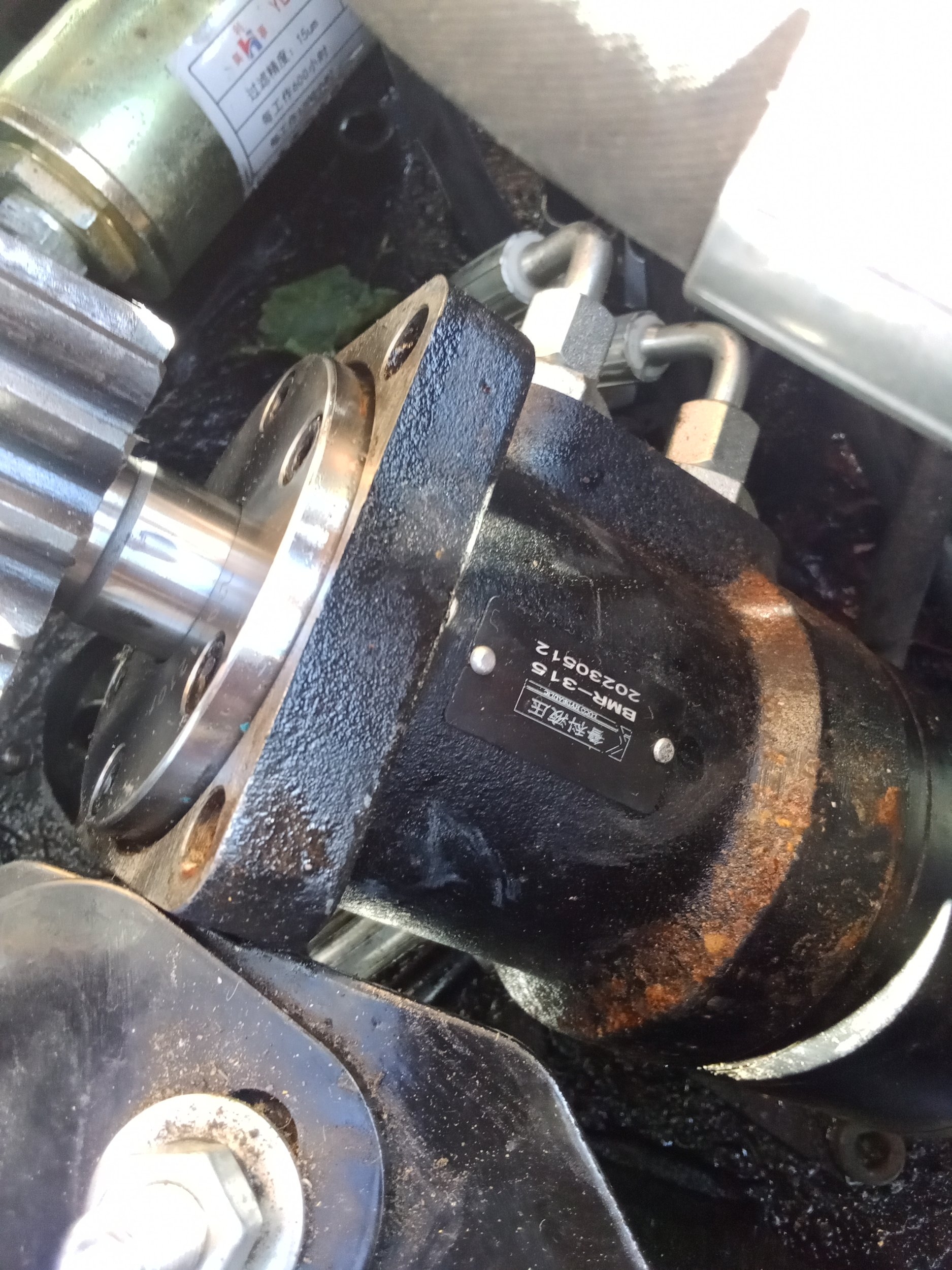

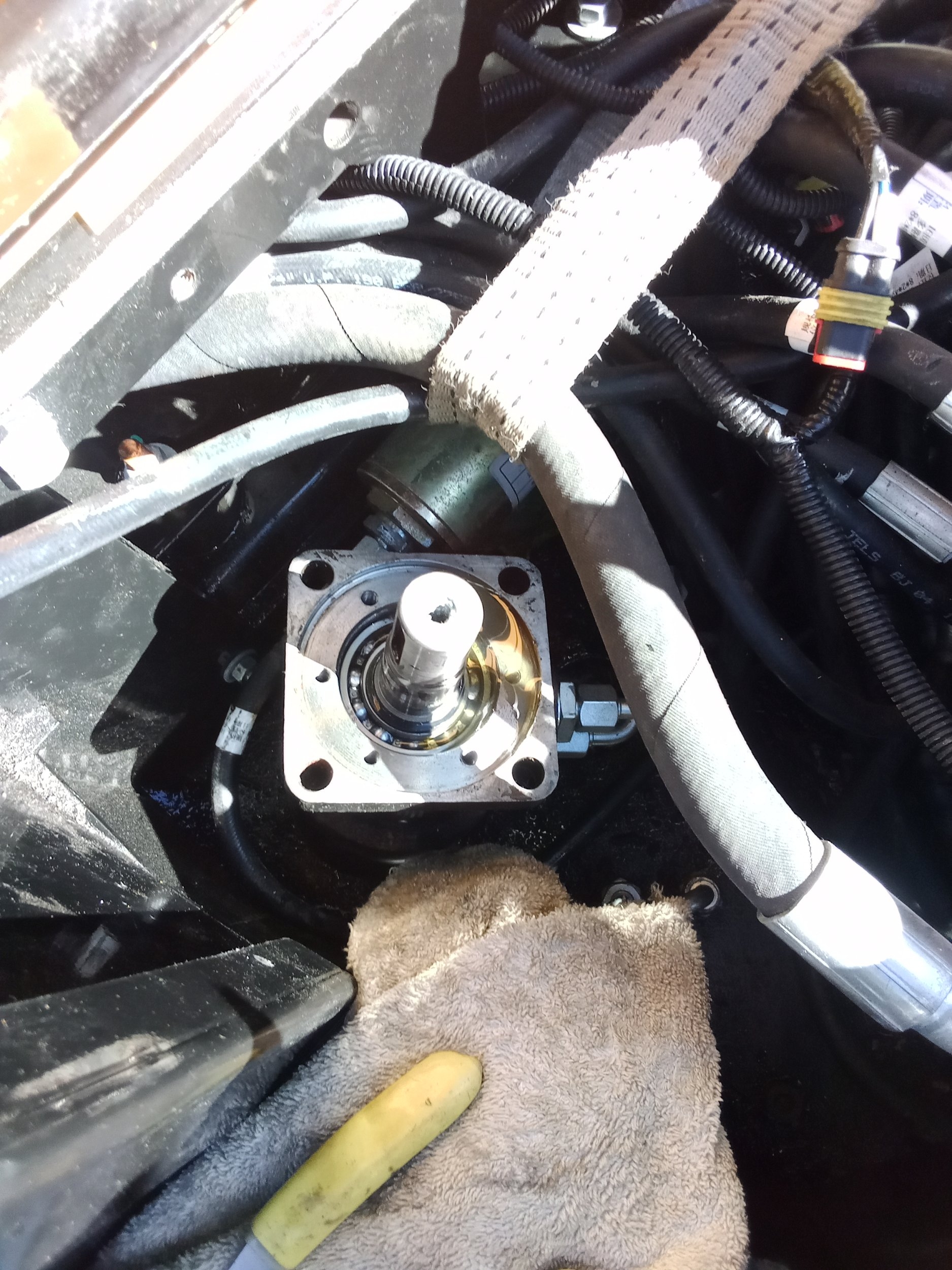

To all you guys with some hours - how much slop is normal after how long?
After three hours I've noticed joints in arm and bucket a tad sloppy (plenty of grease and all pins tight), (prob from factory?), But most importantly the house has several degrees of side to side /turning slop whether machine is running or not (will measure, but guess > 6 inches at bucket with arm fully extended.) I did verify the bolts to motor and table are tight- seems it is in the motor itself or it's interface with the ring gear.

I'm not super happy with the slop I already notice everywhere- guessing it's fairly common though. I took the slewing motor off to examine the house/swing slop and it's not the mesh with ring or the keyway /key, the slop is coming from inside the pump/gears itself, and of course just a little turns into quite a bit for the boom. Here's some pics/vid of it and cover removed. I wonder if this is because of a low quality pump. youtube.com/shorts/t_S8iINJvAQ
