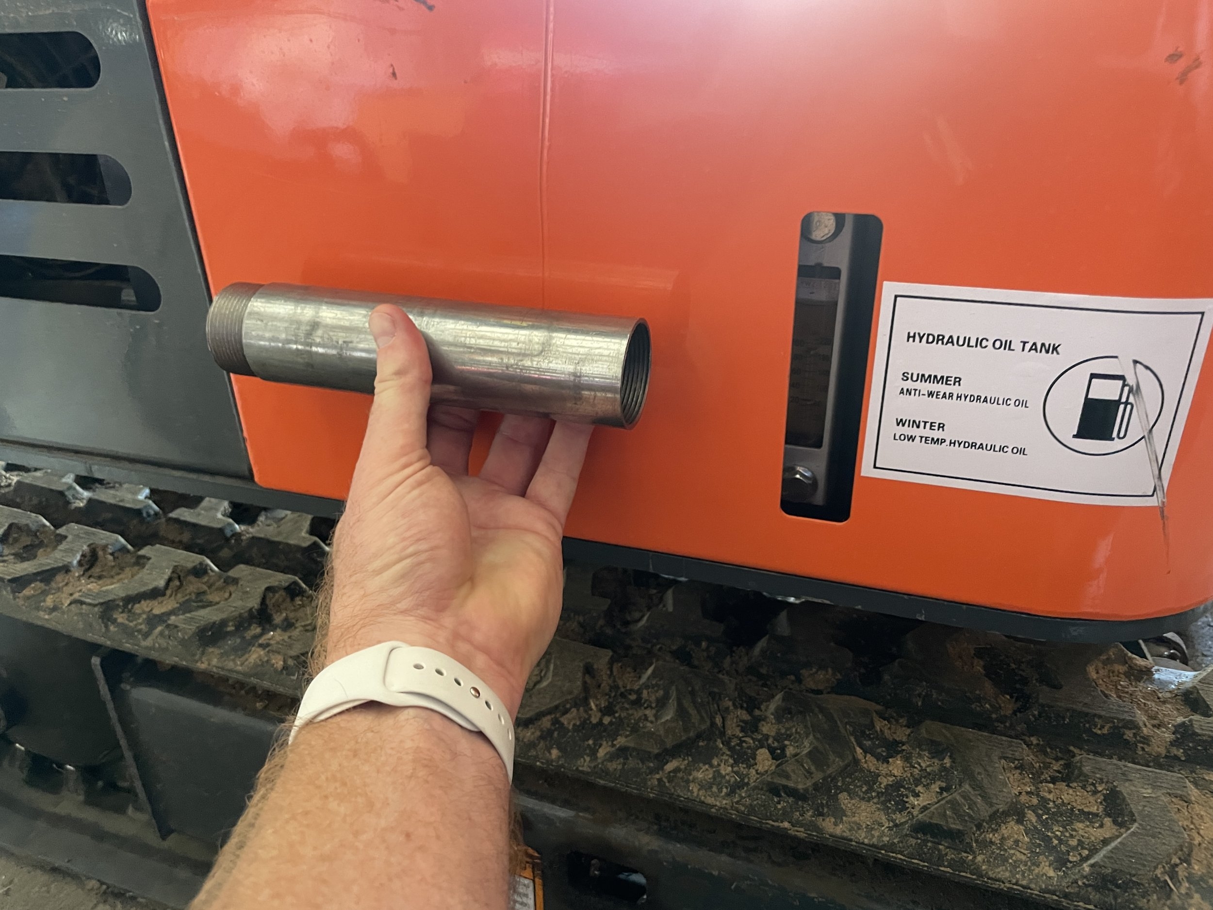

I got an AGT L12 direct from AGT via a eBay sale and it was shipped to me for $5900 plus tax about 2 months ago. Originally I had a QH12 on order but changed to an L12 because the L has a hydraulic oil cooler and stronger canopy. Also the engine is more accessible from what I can see. It was the same price.
15 hours in and so far I’m happy. No leaks or major issues. The controls for the tracks keep wiggling loose. I want to find some better handles for them. I haven’t looked into where to order those.
I was surprised to get a call from AGT a week back. They sent me a part for free that extends the pump inlet into the hydraulic tank. It’s supposed to solve a “manufacturing defect” where the hydraulic system stops working when the machine is at a steep angle.
I’ll probably replace the hydraulic fluid when I add this part as I have to drain it anyway. Anyone have a recommendation for fluid? Should I use synthetic?
Many have added a proper filter but I’m hesitant to take that on right now.

That simple fix they sent you is great. My Kat-12 has a lot of trouble on inclines. Be careful on really steep terrain and keep you cg as far forward as possible. Use the hoe to throw cg forward or to one side.
Concerning fluid; AW-32 can be bought at any auto supply and is cheap.
