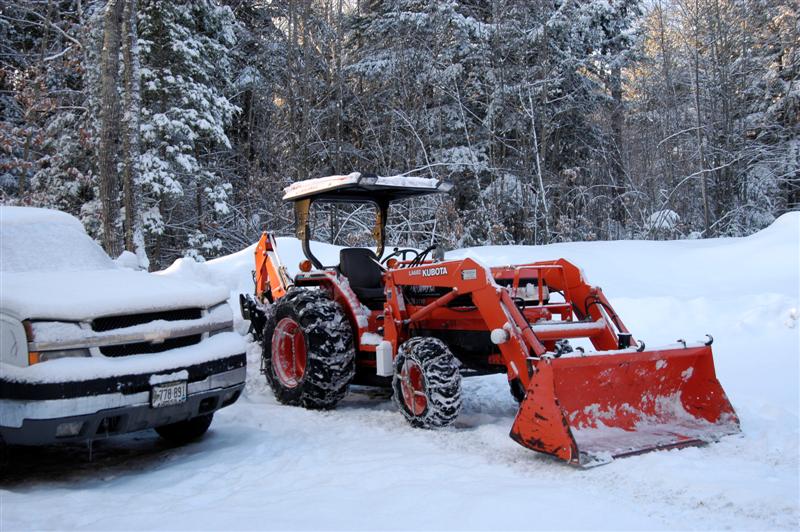

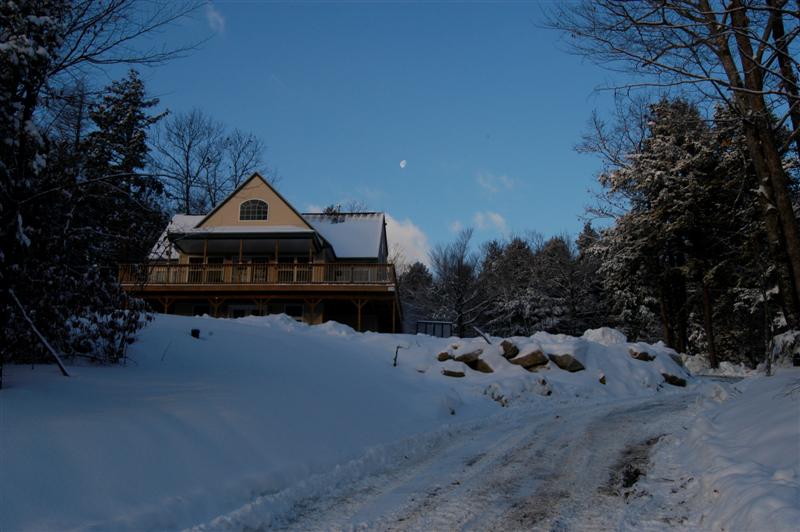

This is my first year with 4 wheel chains. I'll never go through a winter again without them. With the fall water runoff that froze before the first snow nothing goes up and down the hill but the tractor with the chains. I've already pulled my truck up three times in the last two weeks. By next year I hope I have my water problem solved but this year the chains are king.
