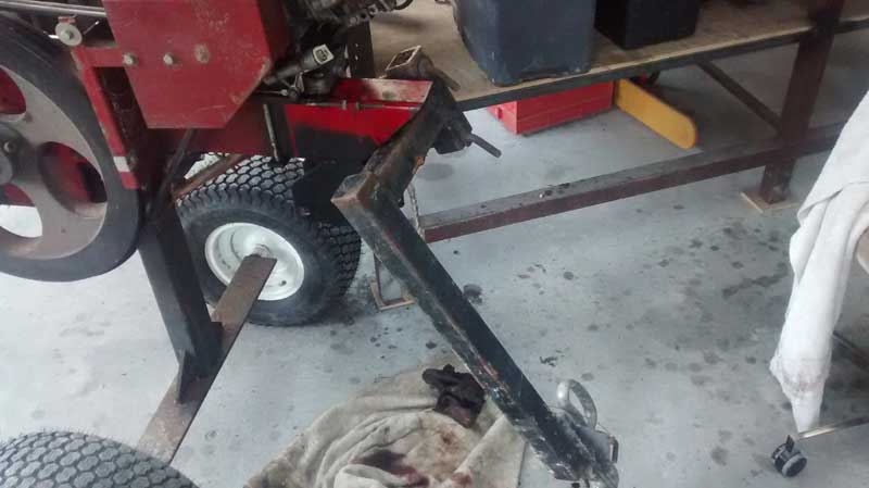

Making it towable from both ends was the first of a few modifications when I got it home. There's actually quite a few more I need to do, some obvious, some very subtle only an experienced user would appreciate.
OK, now you've done it....I need some pics. Curious as to what you did. I added a hitch adapter to mine so my friend could tow it with his lawn tractor. It also makes a nice lever for moving it around by hand.

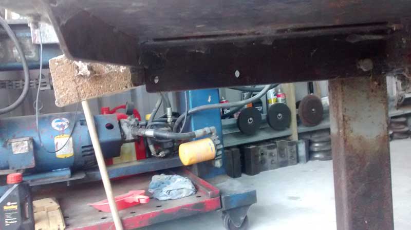

Sorry for the slow reply. I just drilled some holes in the front table supports to take pins, and welded flanges on the back of the splitter for the same reason, then fabbed up a quick tow hitch to pin on either end. Certainly not a highway-towable option but for towing around the woodlot slowly and repositioning, it works for me. But If I get enough time and money, it will be changed to be road legal as it's a pain to get on and off the back of the truck.
Front pin holes:
401246d1417731524-improving-wear-wood-splitter-slides-splitterfront-jpg
Back pin holes and hitch:
401247d1417731564-improving-wear-wood-splitter-slides-splitterback-jpg

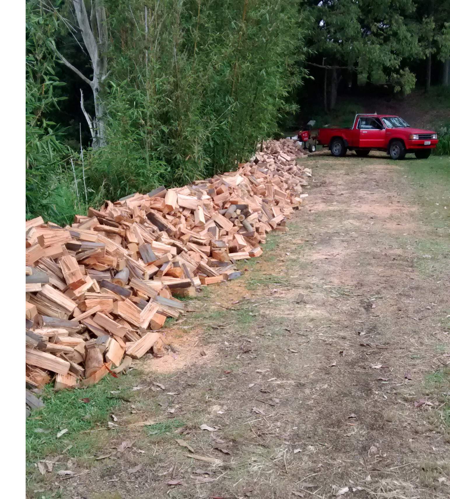

Some results of work this week:
402133d1418273837-improving-wear-wood-splitter-slides-firewood-jpg
