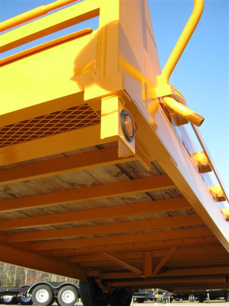

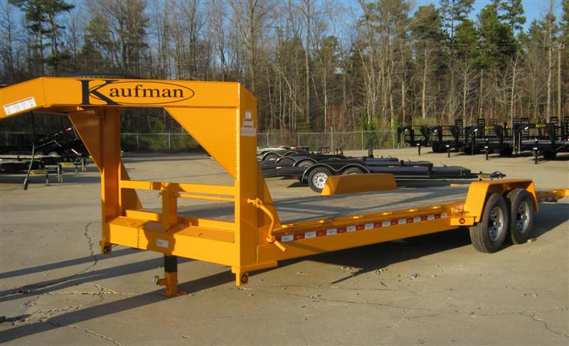

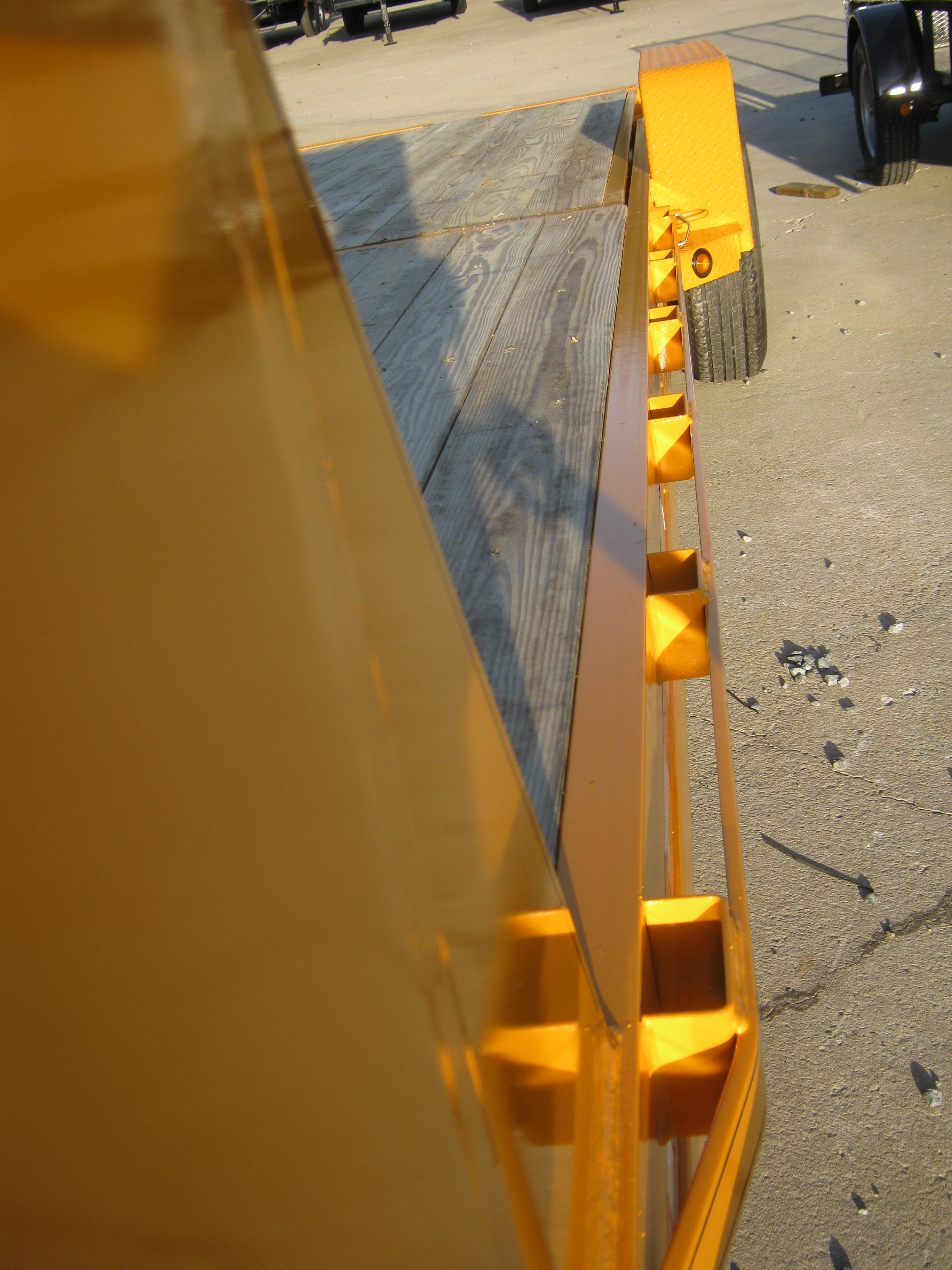

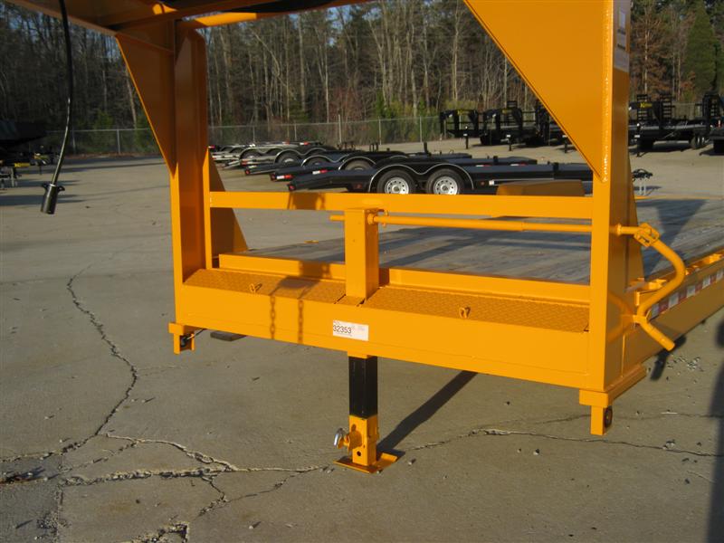

Yep, I was looking several years ago and the salesman sent me some pictures.

I talked to a guy who has one of these trailers and he says it works great for equipment but that you can't load a pickup on it. Since they are gravity tilt when you drive the truck on the front tires start pushing the ramp down before the back ones are on.
That last point will stick with me. It would be really disappointing if the need to move something with a longer wheelbase ever arose. I guess that's why the axels are so far forward on some makes.
   / In between the fender trailer with heavy axles #19
There are workarounds for that, one way would be block the front so it could only come down a couple of inches. Then stop the truck when the rear axle is on the deck, remove the blocks and drive on.

Or, if its like the yellow Kaufman in the picture, (which has a hydraulic cylinder to help control tilt speed), you can add a valve inline to the line on the cylinder and close it to lock the trailer in the tilted position.
