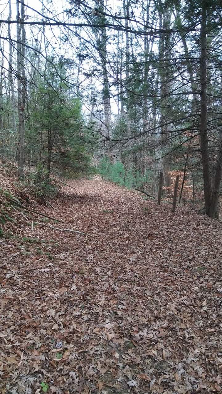

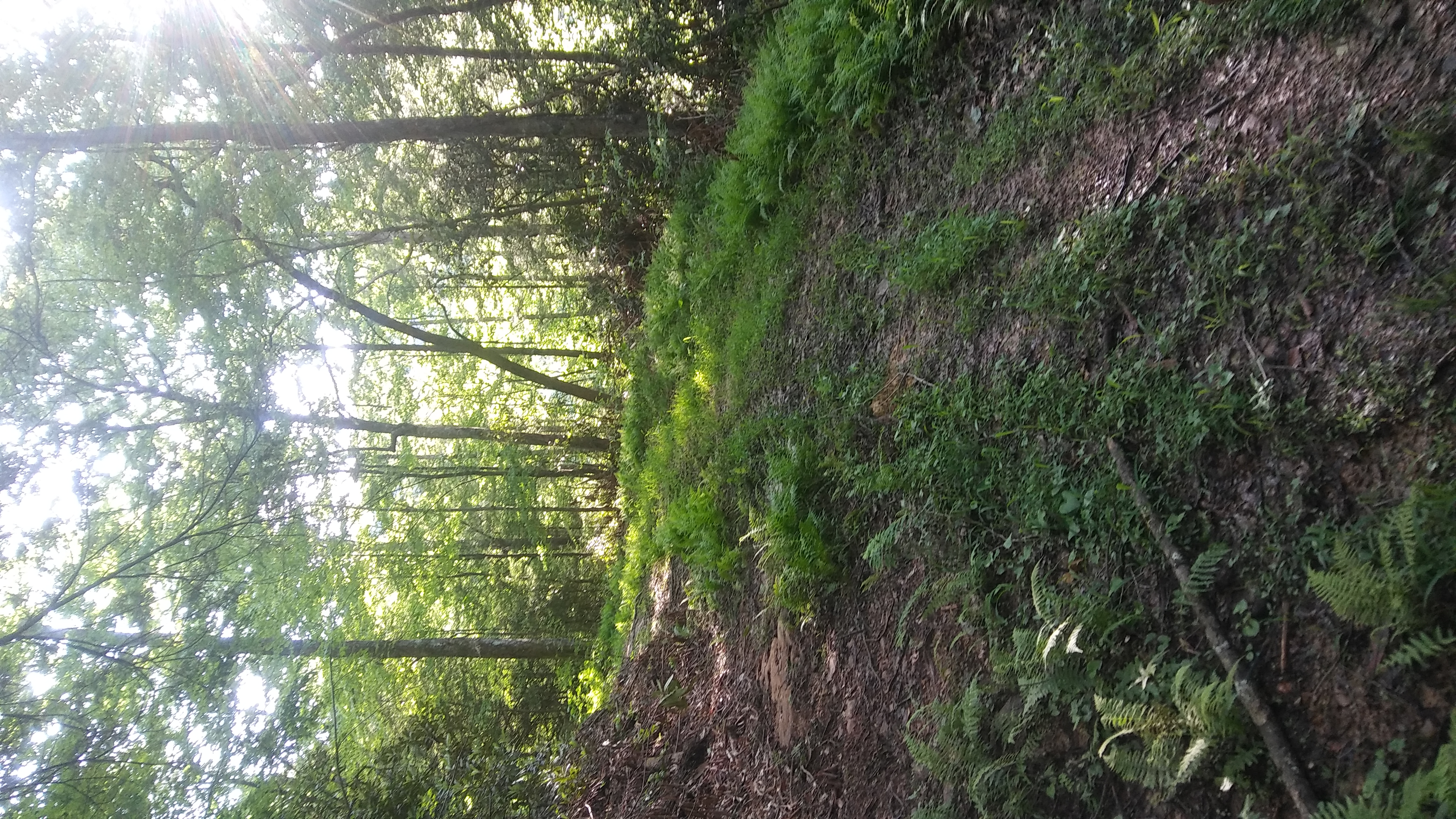

   / In the market for my first tractor
#9
Dont have many pictures but this is the road I'm working with. Last fall and then a couple of weeks ago.
