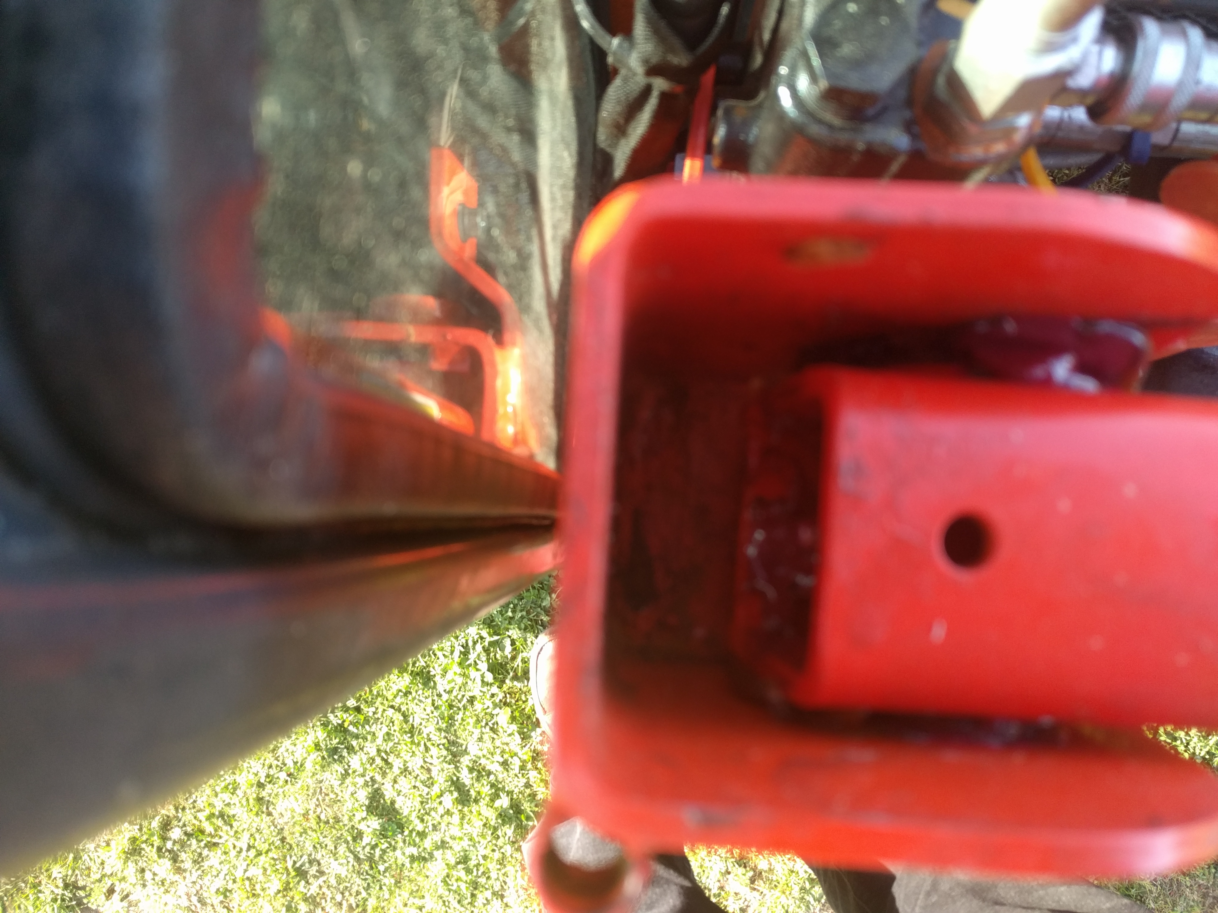

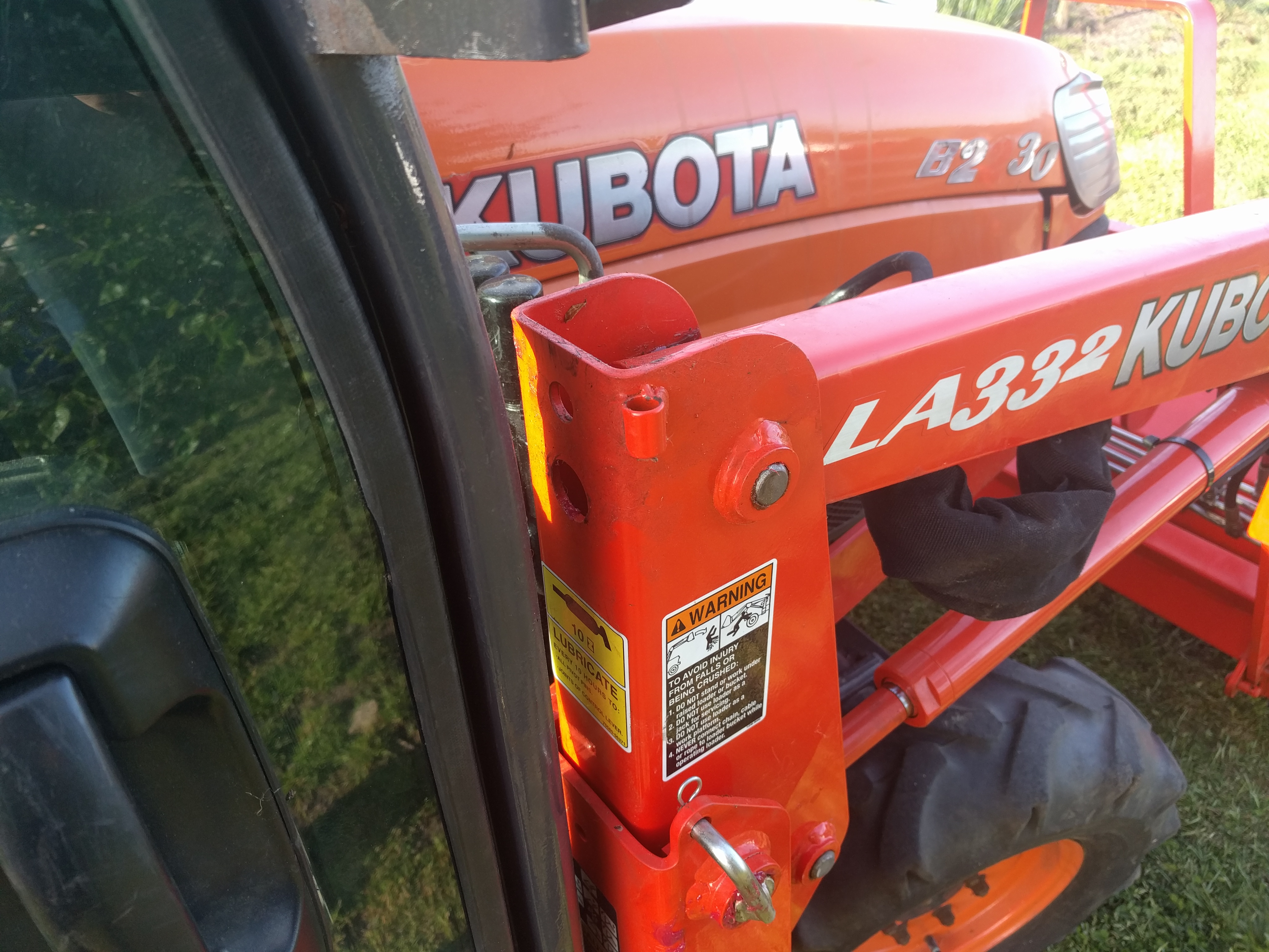

So I have a Kubota B2230 with a recently added front loader. The problem I have is because my tractor is the cabbed model the top grease fitting cannot be accessed. There is an access hole but you can only use it if you detach the loader. I dont want to have dettach the loader to be able to grease it. I have tried flexible grease gun hoses, kits of grease gun adapters, even looked at changing the staight fitting for a 45 degree or 90 degree one. Problem is when looking down from the top you can see the grease fitting it is in slightly from the loader arm - so difficult to photo. If I could find a compact right angles grease gun adapter which is 90 degrees it would probably do it, the slide on 90 degree ones wont work because of the position of the grease fitting. This would seem to be an issue others might have encountered - Any suggestions? You can just make out the grease fitting in the first photo

It looks like the fitting would be accessible from the top with the boom all the way down, if it were a 90 degree fitting mounded out a bit further. I'd suggest looking for an adapter to change from the thread size of the existing fitting to another size. They provide the right amount of offset. Then get a 90 degree fitting with a thread size that matches the adapter.

it would need to be bent or be right angled cos there is no way to get at the access hole for the grease fitting because of the cab. Might look like its possible in the photos but trust me its not
/ inaccessible grease fitting #11
It's hard to tell in your picture but I am guessing the grease zerk if pointed towards the cab. If you went with a 45 degree zerk could you get to it with a needle adapter like oosik mentioned or a straight zerk may let you come through the top hole?

Enlarging the hole doesn't help. It's pointed directly at the cab. The problem is to being able to access the grease fitting without using the provided access hole, since it's not accessible.
The grease fitting can be reached from above when the FEL is lowered, but the current fitting is recessed and points to the rear so you can't get a gun on it. There's not enough room to add an extension hose that can accommodate the wide range of motion of the end of the FEL arm.
The solution is to extend the fitting enough to be reachable from above, and point it upward, not to the rear. There have been a couple of suggestions on how to do that.
