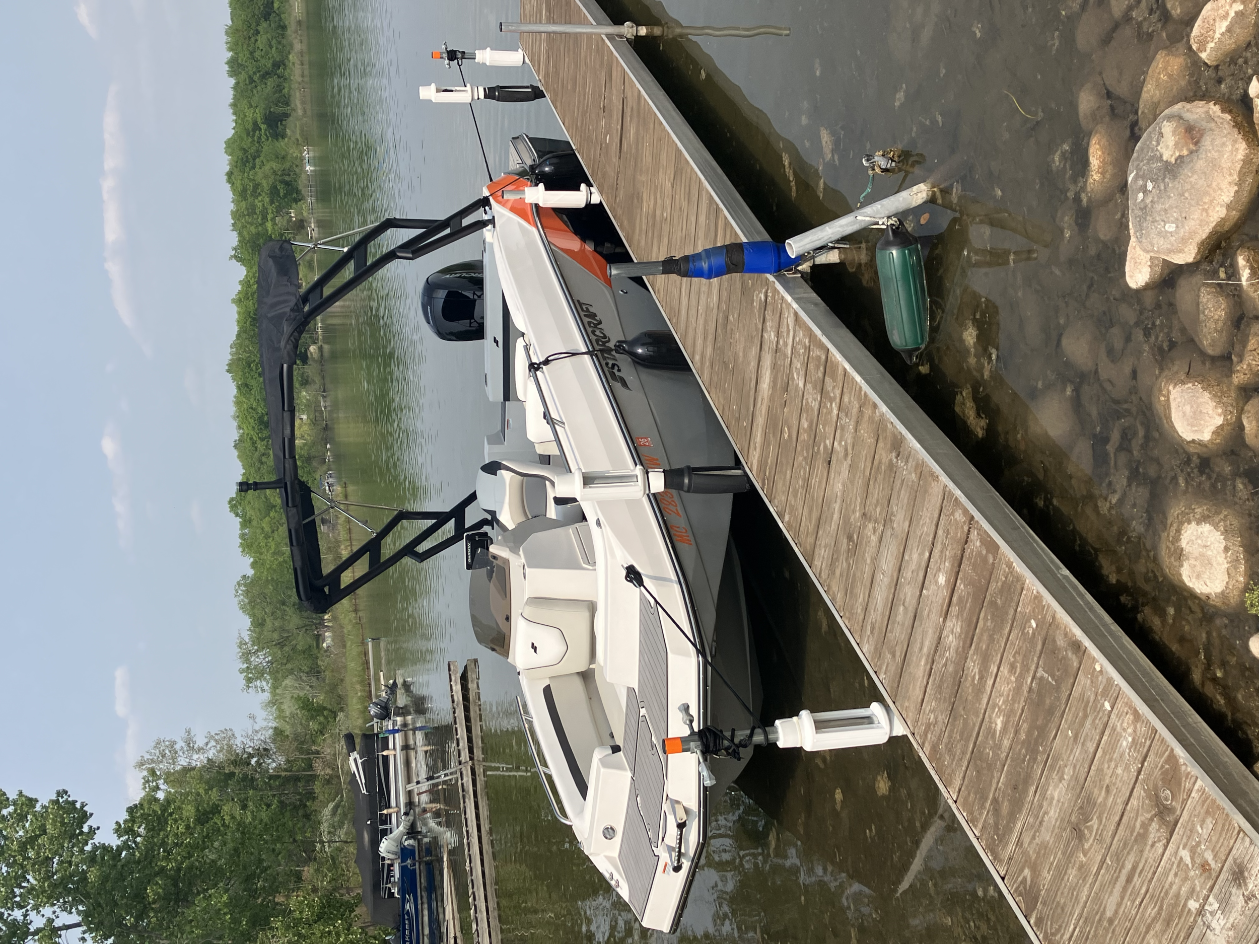

Ended up buying a 2023 new 20 Starcraft deck boat with a 150 merc.outboard.
WoW Very Very NICE!
Yep, if going New everybody i have talked to says just go ahead and get the boat equipped with one or more of the new 4 stroke outboards.
Especially a Good idea if used in salt water.
On a used boat probably not a bad idea either.
Congrats the new Starcraft it should last a lifetime
I like the integrated arc /arch as well with cover.
