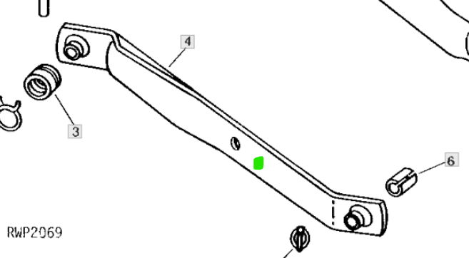

One can also relocate lift linkage on draft arm closer to load on 3pt point hitch & increase lift capacity. Note location of green dot that will relocate lift link closer to implement. Relocating hole in draft links will change maximum & minimum heights of attached implement.
