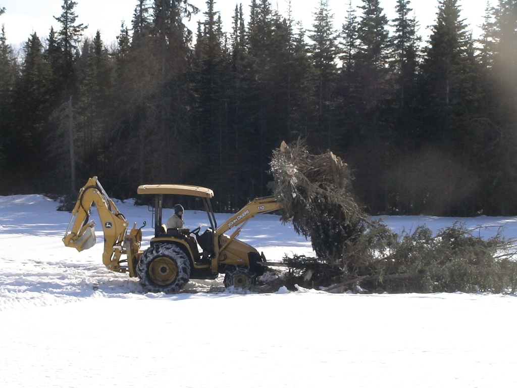

Clearing trees has always been the time when I'm most likely to have moments when the tractor can get "light in the @ss"! Generally, it's when I grab onto a pile and they're pretty long... quite a bit of lateral force on the loader and can make the tractor tippy. Try to center the load if the trees are big - and back off - when they're just too many big ones. Smaller bites...
Frozen stumps and root wads are "burn projects". Can take a couple of weeks to get them burned down to ash. Here's a pic of me tryin' to get the fire goin' again and adding another stump to the burn.

AKfish...this is back before you put a cab on the 110 huh? So now you got some heat blasting in the cab?
   / Increasing 110 tlb loader lift capacity #13
I wish I had a cab on the 110... no such luck! Steve's got a Laurin cab on his 110. Would have added around $8K to the cost of the machine... really hard to get the wife onboard with a $50K price tag! :eek:
Of course, when she had a few year's learning how to use the tractor and could see how that machine "changed" our farm - it was pretty easy getting her to agree to buying a CAB 5075M! :thumbsup:
