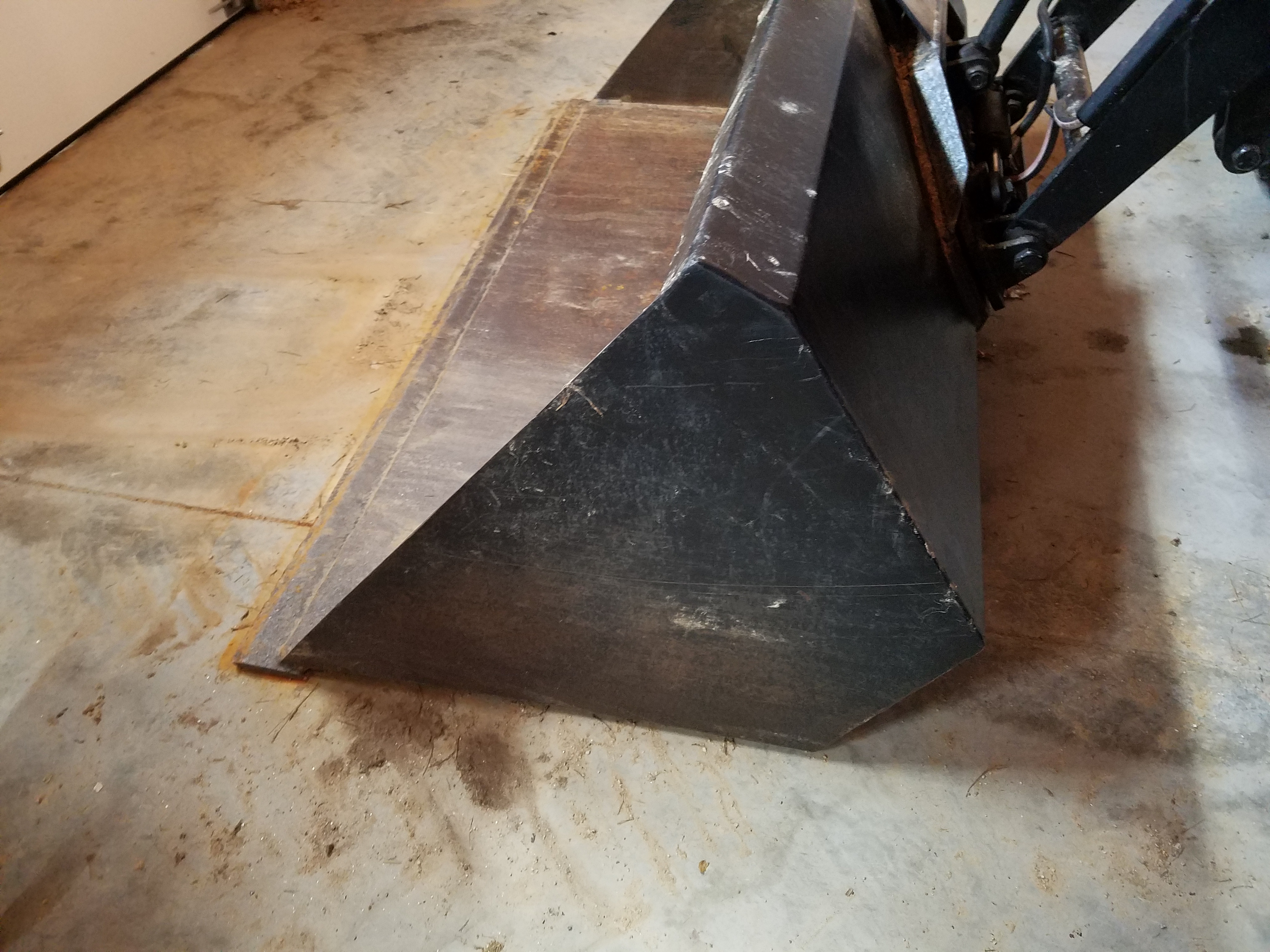

Do you guys have any troubles with the tilt range?
YES! I thought I was crazy. I only recently started using the bucket for snow removal (as I haven't finished my plow yet...) and the loader geometry on this thing is driving me nuts. Plus, the bucket seems to be too deep (and not wide enough, though I haven't taken my duals off yet). It reminds me of the old trip-dump manure bucket we had on the Ford 8N as a kid... It is a PT bucket, but It may have been modified; the cutting edge was definitely added. I know that trying to plow snow with a bucket is fairly miserable anyway, but I can do it with the JD at the farm. On the PT, even if you manage to find the perfect angle to prevent it from digging in, (I do have an indicator) it changes with the loader height! It makes me think that the pivot points are in the wrong spot or something.
I like your idea of replacing the tilt cylinder even if I don't modify the top link, because I have about ZERO breakout power at the end of that long bucket and the tilt action is way too touchy.

#20
If using a bucket for snow, I would usually tilt it back a little on its heel. That leaves a little snow but let me do removal much quicker.
