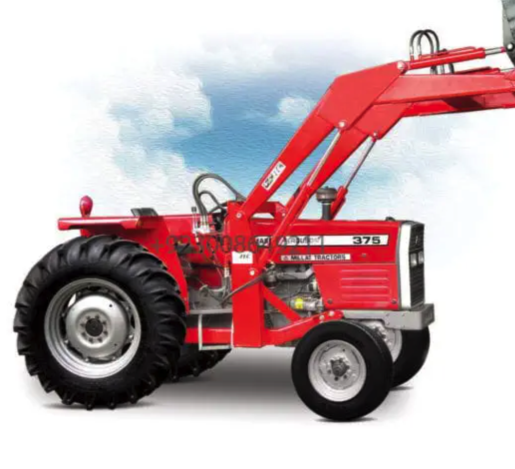

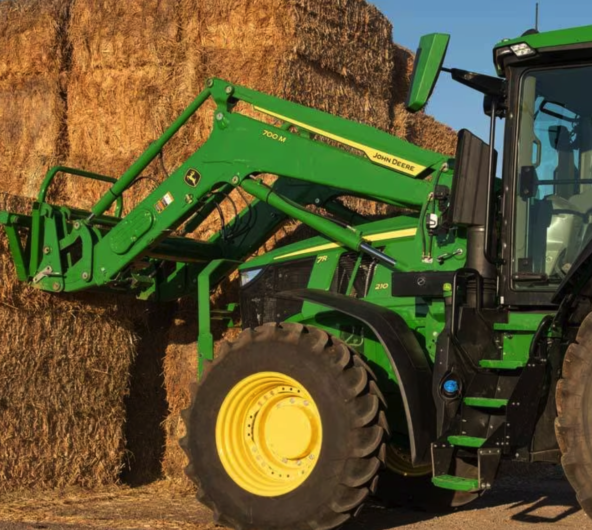

The rod side of the piston generates less force for the same pressure, due to the rod taking up some of the piston surface area. So, flipping end to end would make a substantial difference in lift capacity. That is why you don't see cylinders attached with the cylinder end at the bucket.
Makes no difference. Surprises me that people still think this.
As mentioned....regardless of orientation, the cylinder must EXTEND to raise the loader. Therefore the area of the rod has ZERO effect on its lift capacity in either orientation.
The manufactures decision on which way to orient is quite simply which end the hoses are fed from.
On removable loaders, like most modern loaders.....the supply lines run down the loader frame....there for we see the base of the cylinder attached to the loader frame....and the rod end pointing down. Because the base end/barrel of the cylinder doesnt move.
On older non-removable loaders....the hoses were usually fed from the tractor or the loader upright and not down the loader arm. As you can see in BCP's pictures. Its all about where the hoses are fed from

Look at these pictures BCP posted.
It doesnt matter which way the cylinder is pointing
They are BOTH extending to raise the loader
