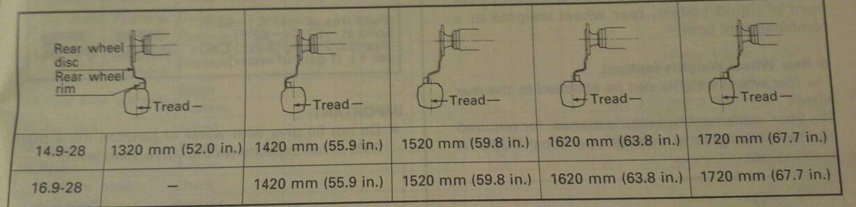

With your rims if you unbolt the outer section then rotate the inner and move the outer section out you will gain the width of the mounting which is usually 2-4 " on each tire,
which is what posts 4 and 5 mentioned.
If that is not enough adjustment then the rims can be flipped around as they are usually not centered with the mounting tabs.
Providing you with several optional spacings.

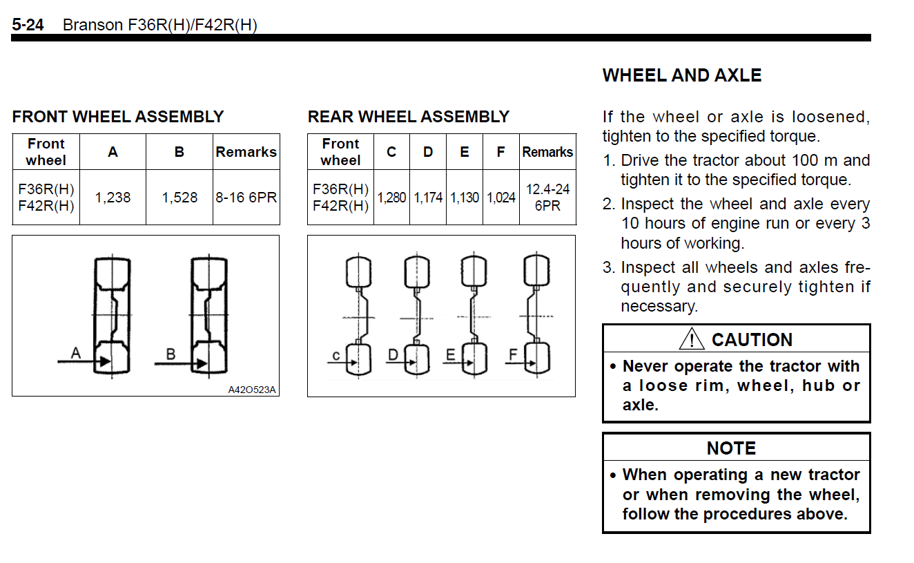

Check your owner's manual. Mine says not to do any of what's been suggested.
<snip>
Yup, definitely check your owners manual. Also a workshop manual if you can find one.
Like the page from my M4700 manual I posted
attachment.php
Where it shows the various stances that can be used.
I'm surprised Ich's manual says not to do any.

IchabodCrayne - hard to understand why your owner manual says - "don't do it" - if you have the wheels/rims and can make changes as shown by Newbury - post #13.
However - whether you do or do not have the rims/centers that allow this - the owner manual should be followed.
My M6040 Owners Manual has a diagram just like what Newbury has posted. My rears are filled with 1550 pounds of RimGuard. Thank goodness they are out there at the widest setting. I certainly could not handle the tires being they are filled.

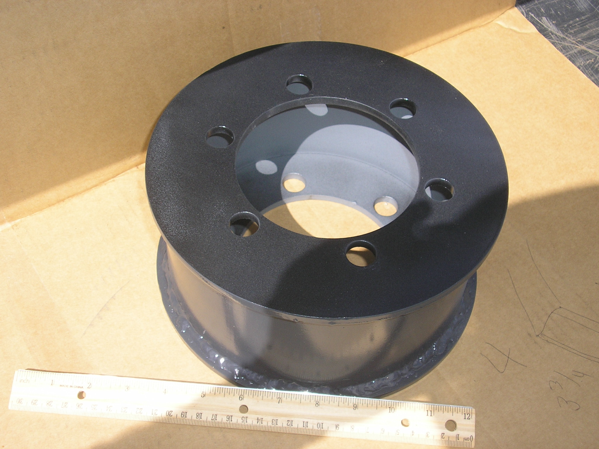

This worked for me on my 2400:
The spacer is a piece of 8" dia x 4" wide steel pipe welded onto a couple of flanges made from a piece of 0.25 inch steel plate. I took the plate to a local machine shop with a machine drawing I made of the mounting interface and had them cut out 4 adapter plates. The OEM bolts bolted the spacers to the axle hub (through the hole I deliberately left in the center) and the hardware store supplied the wheel to adapter hardware. Total cost about a hundred bucks for everything.
The width of 4" brought my outer rear tire width to be even with my 5', 3 pt. rotary mower.....could have been wider if I was doing it solely for stability purposes. Guarantee you this. 4" per side does matter.
Edit:
When you assemble (weld up) the units, ensure that you line up the holes in a straight line. To mount to the tractor hub, insert the bolts and the socket through the center hole and come through the outer stud mounting hole with the socket wrench extension for tightening.
Putting the wheel on the assy is obvious.....you can see a backing nut in the left picture.
565941d1533731068-increasing-width-rear-m4700-wheel-spacing-jpg
I expect someone bought a lawsuit after snapping an axle, etc. We just picked up a used 14K pound rate tilt trailer in part to get 82" between fenders since all three tractors are set up at 70 % of max width. I need all of the stability that I can get.
