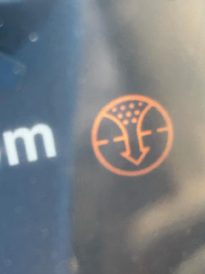

Dec 6, 2023 / Indicator light #1 thatguy1231 New member Joined Dec 6, 2023 Messages 1 Tractor Mahindra 3538l So I had a indicator light come on and I have no idea what it mean some Thanks Attachments 14813.jpeg 124.2 KB · Views: 214
Dec 6, 2023 / Indicator light #2 J jonsstihl Veteran Member Joined Sep 2, 2008 Messages 1,210 Location Quebec, Canada what does the manual say, looks like either a DPF/regen light or possibly a restricted air filter light.

Dec 6, 2023 / Indicator light #3 Eagle1 Epic Contributor Joined Jul 4, 2003 Messages 27,753 Location Viburnum, MO Tractor Kubota BX2200, LS XG3135H, Grasshopper and Yazoo Zturns Looks like air filter to me... I 8. Universal Symbols - Mahindra 10 Series Operator's Manual [Page 38]

Dec 6, 2023 / Indicator light #4 ptsg Super Member Joined Apr 3, 2013 Messages 7,757 Location Portugal Tractor Branson F36Rn - Agria 8900D Clogged air filter light. Time to pull it out and check the condition. Blow it out with compressed air. Preferably from the inside out.
