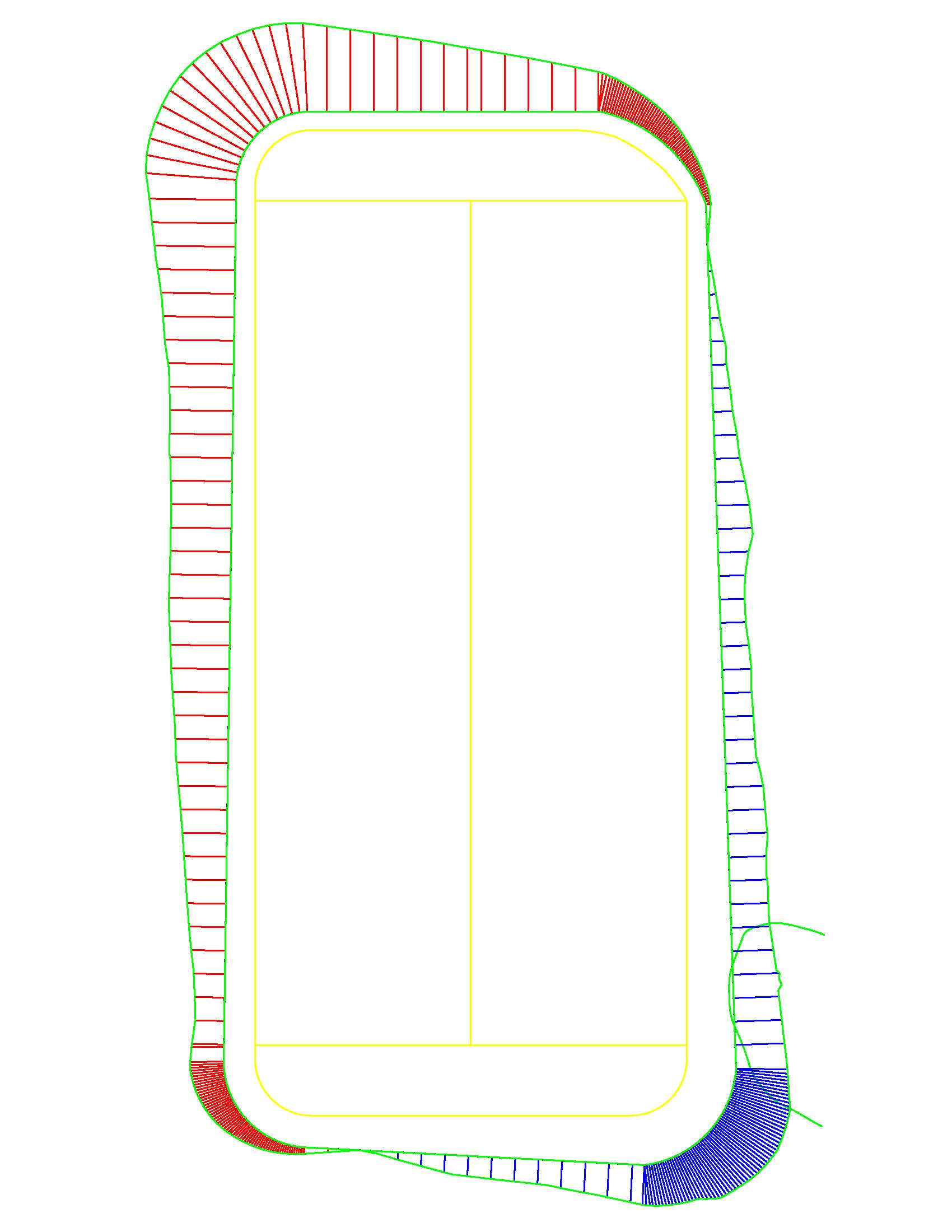

Unless the OP wantrs a borrow pit on site, it makes no sense to import the material. I would run a balanced cut/fill job with drainage swales around the perimeter cut section. It would basically look like this pic of a polo field we designed and built using gps guided machines. The cuts were as much as 10'.
