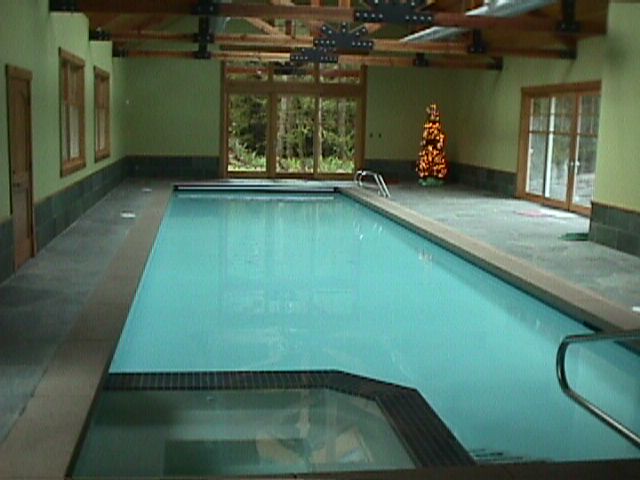

I recently installed a 56'x14' pool inside my house. It is in its own 'wing', and includes a Lifebreath HRV (Heat Recovery Ventilator) to keep the humidity down. A few things I learned:
1) The most important thing to install on an INDOOR pool is a water proof cover. This drastically reduces the amount of moisture in the air. This allows you to use an HRV dehumidifier, rather than a compressor type. The cost difference both in installation and operation is very substantial.
2) The interior of your pool room should be made from fairly weather proof materials. We used a lot of stone and cedar. The walls were painted with a fairly thick coat of enamel paint plus a water resistant primer.
3) Pools can be rather expensive to heat.
4) There is always the big question of going with a gunite (sprayed concrete) or fiberglass. The size of our pool eliminated the fiberglass. The largest lap pool we could find was 38'x12' in fiberglass. Also, replacing the fiberglass pool in an indoor installation isn't feasible.
We really enjoy our pool, and are quite happy that we put one in. I have attached a picture of our pool room so you can have a look at what we did. The pool and equipment came out to about $50k. The building was part of the new house, but wasn't very cheap mostly because of the skylights and windows we selected. It is quite nice.
Kevin

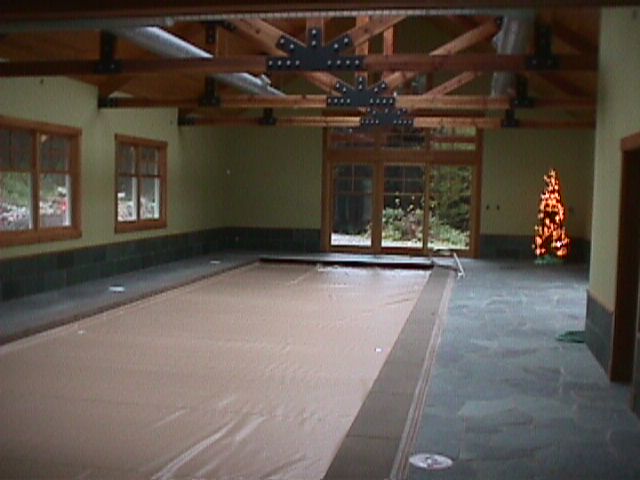

Forgot to mention that we also installed a hot tub in one end of the pool. It was in the previous picture. The hot tub and the pool share the same water.
The picture in this attachment has the pool cover closed.

That is stunningly beautiful. Pam and I have decided against the pool because of initial and ongoing cost. Let me say again, though, that your pool room is magnificent!
Jim
   / Indoor Inground Swimming Pool #18
Uh Kevin----do you think I could COME LIVE YOU YOU? /w3tcompact/icons/smile.gif Now that's a pool area I dream about. Great photos
