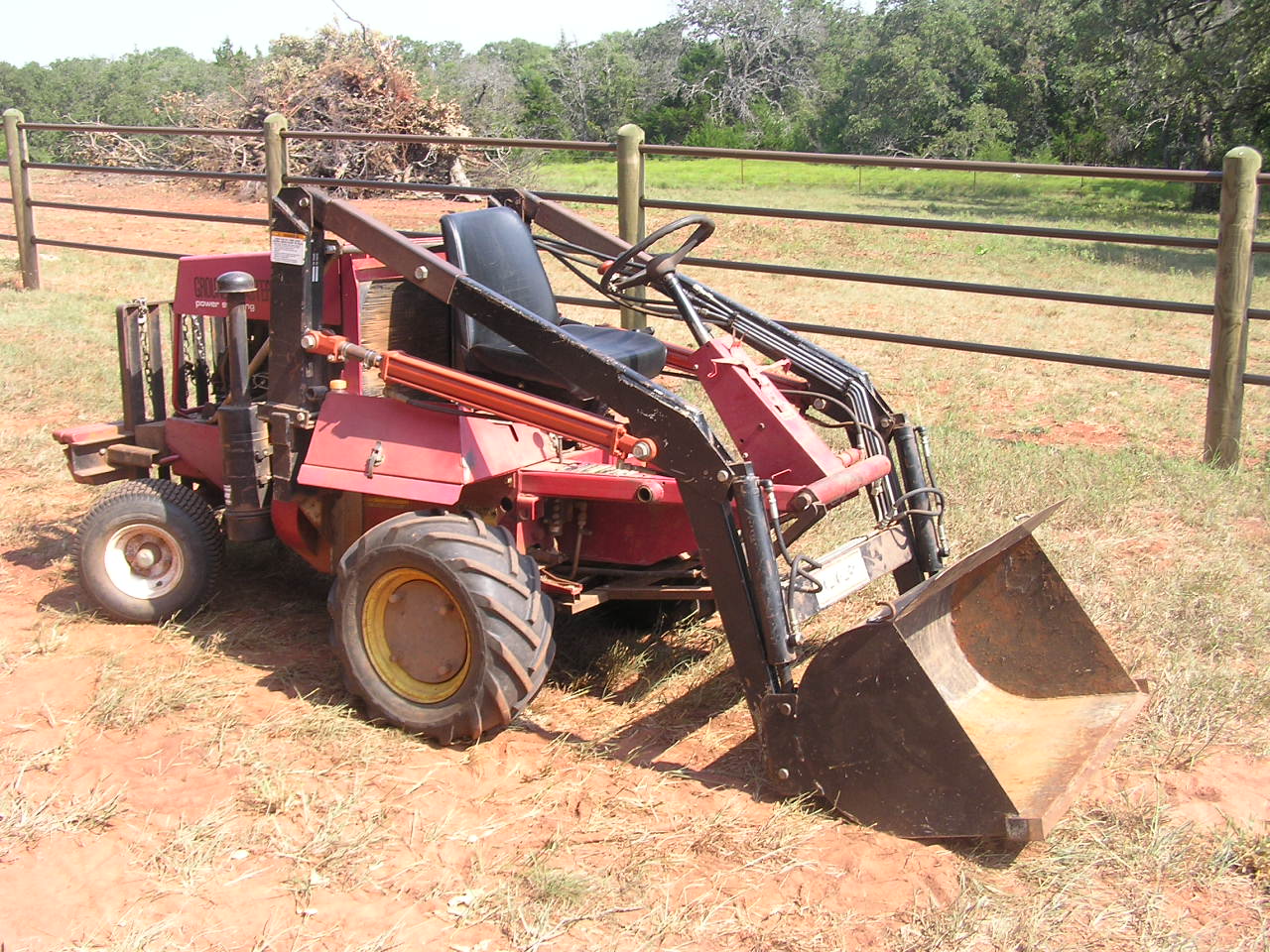

Growing up, I spent summers on my grandfathers farm, drove a Case Vac by myself 68 years ago, I have owned several tractors over the last 32 years, they all had R1 Ag tread rear tires. The thing that surprised me about R4 Industrial tires, is that they will slide sideways on a muddy side hill, where a R1 will keep going straight.
The R1 definitely has more pulling power.
Guess what tire is on my loader. :D
