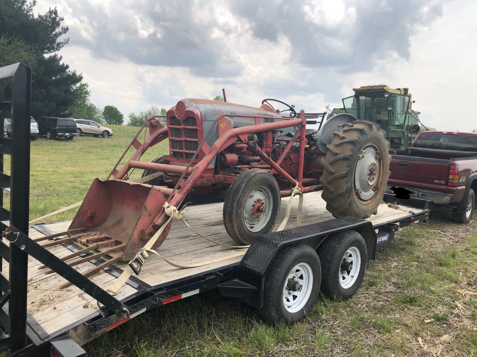

Went to an auction today, the only thing we were interested in was basically was the Ford PowerMaster 861.
It went for more than we wanted to be in it but my buddy bought it. It turns over, won’t fire, just sat in the barn the last 8-10 years. I’m not concerned with it not firing.
What I would like to know is PTO HP number, it’s a gas, internet shows 62hp for the gas and 54hp for the diesel.

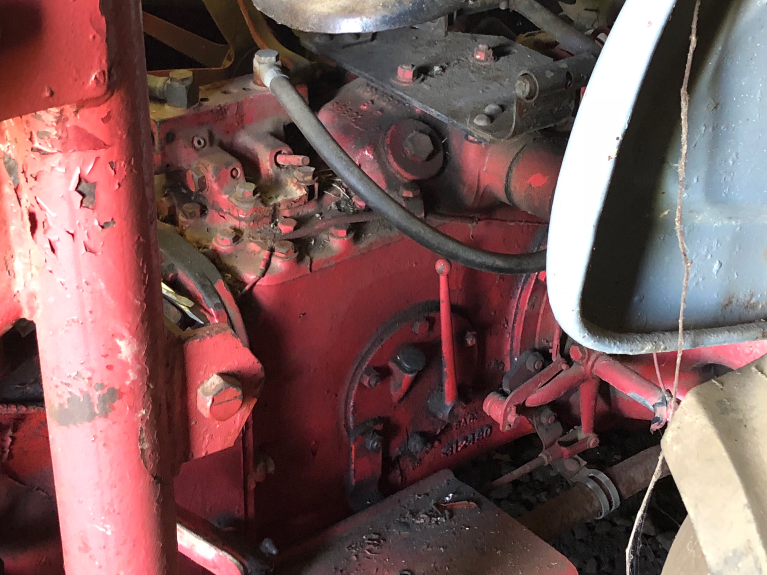

The guy bidding against my buddy came over after the auction to chat, he said his neighbor has the diesel version and it’s got a Hi/Low range, he grabbed the shifter and pulled up, the shifter clicked, he said that’s high, clicked down is low range. Tractor Data just shows 5 gears, no Hi/Low.

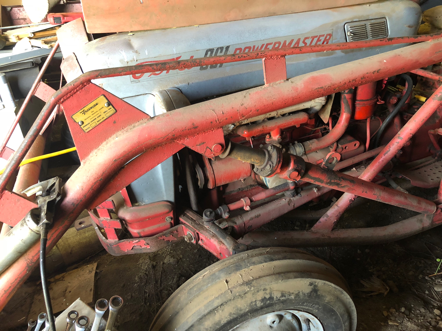

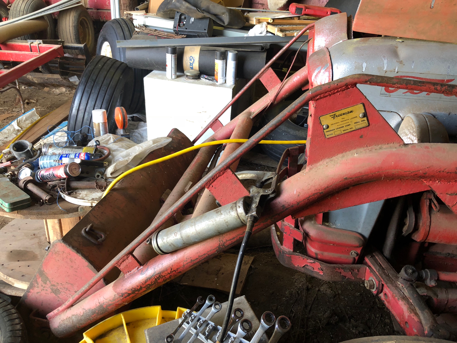

This tractor has a trip bucket FEL, are those useful for anything? What are they worth?
My buddy and I are getting into hay, this tractor will be used for that along side my JD 4320, so he’s not real interested in the loader, he has a 28 Max XL TLB so he doesn’t need a loader.

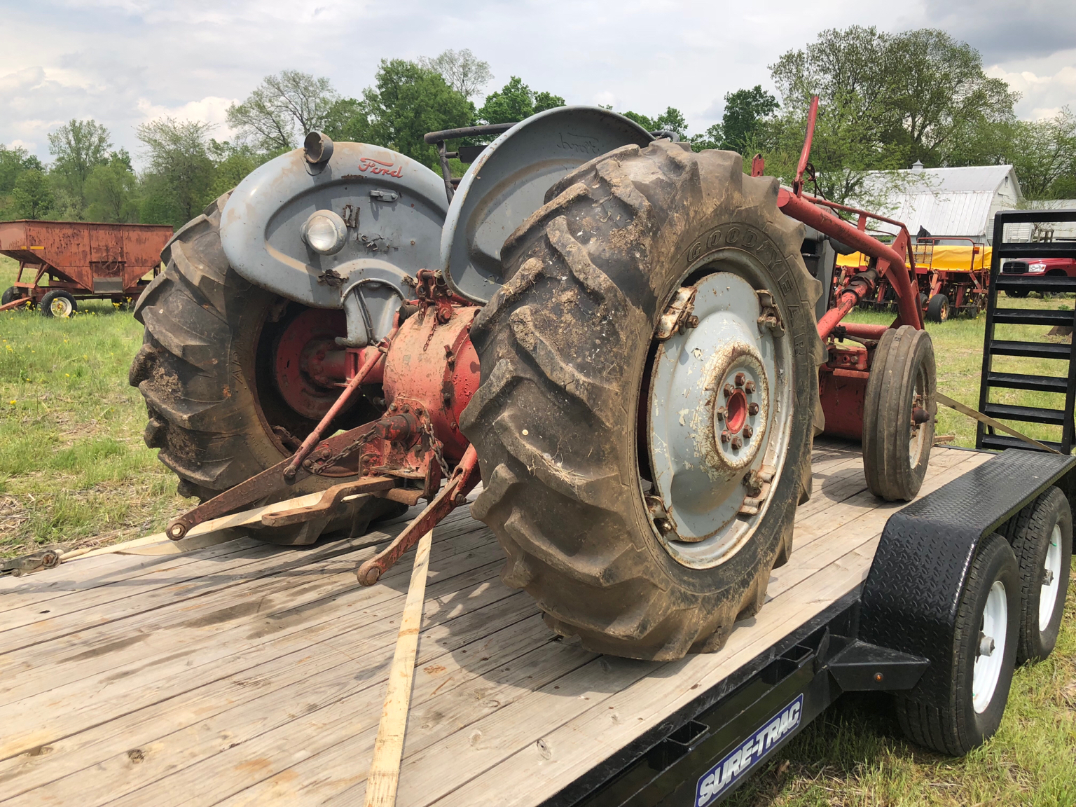

The rears on this tractor is filled with calcium, what’s the best way to drain it and stop the corrosion? Prob fill the rears with WWF.
Any info you guys can come up with would be helpful Thanks.

Assuming you have a 5 speed trans; All the way up is R and 3rd
middle is 1st and 2nd
all the way down is 4th and 5th

I'd like to know how much that tractor went for at auction. Willing to share?
I assume you want to know about the horsepower so you can make some determination of what equipment the tractor can handle. There are a lot of guys on here that could certainly help with that. Unless you take that tractor and hook it to a dyno, anything else is just guessing. Although, I would GUESS that it is putting out a few PTO HP less than 62.
The trip bucket loader wouldn't be worth much to me. It could be useful for pushing around brush, general lifting and manure cleaning. $500 or less would be my estimate.

About the calcium, if it leaked inside the rim, you're looking at some work to clean that up. You can get a hose adapter that will screw on to your tube and allow you to hook it up to a garden hose. Or you could get an ag tire service to pump it out. I know one thing, I'll never put calcium in an other tractor tire. It's way more trouble than it is worth.
