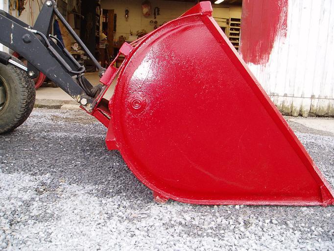

I shred them with the mower or not. Use a regular yard sweeper and dump them where it fills. Then I get the PT and the big red can, pick all the piles up and hall them to the woods.

Stray, I forgot about your giant bucket. Nice job, by the way.
