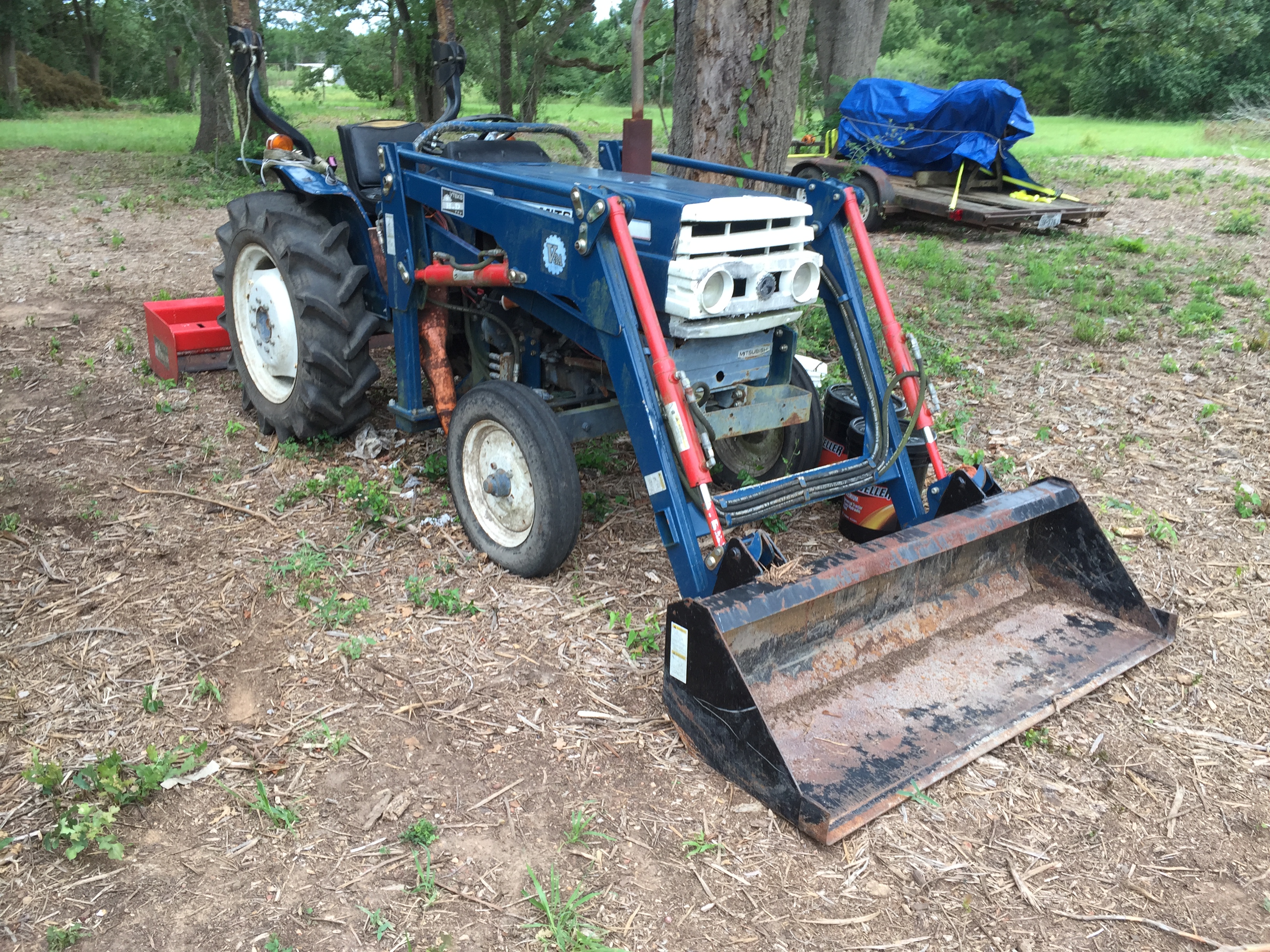

I picked up this tractor while doing some horsetrading. My wife kind of likes it, so I'm thinking about hanging onto it.
Can anybody tell me more about the D2650? Like which MT or Satoh model it may match up with?

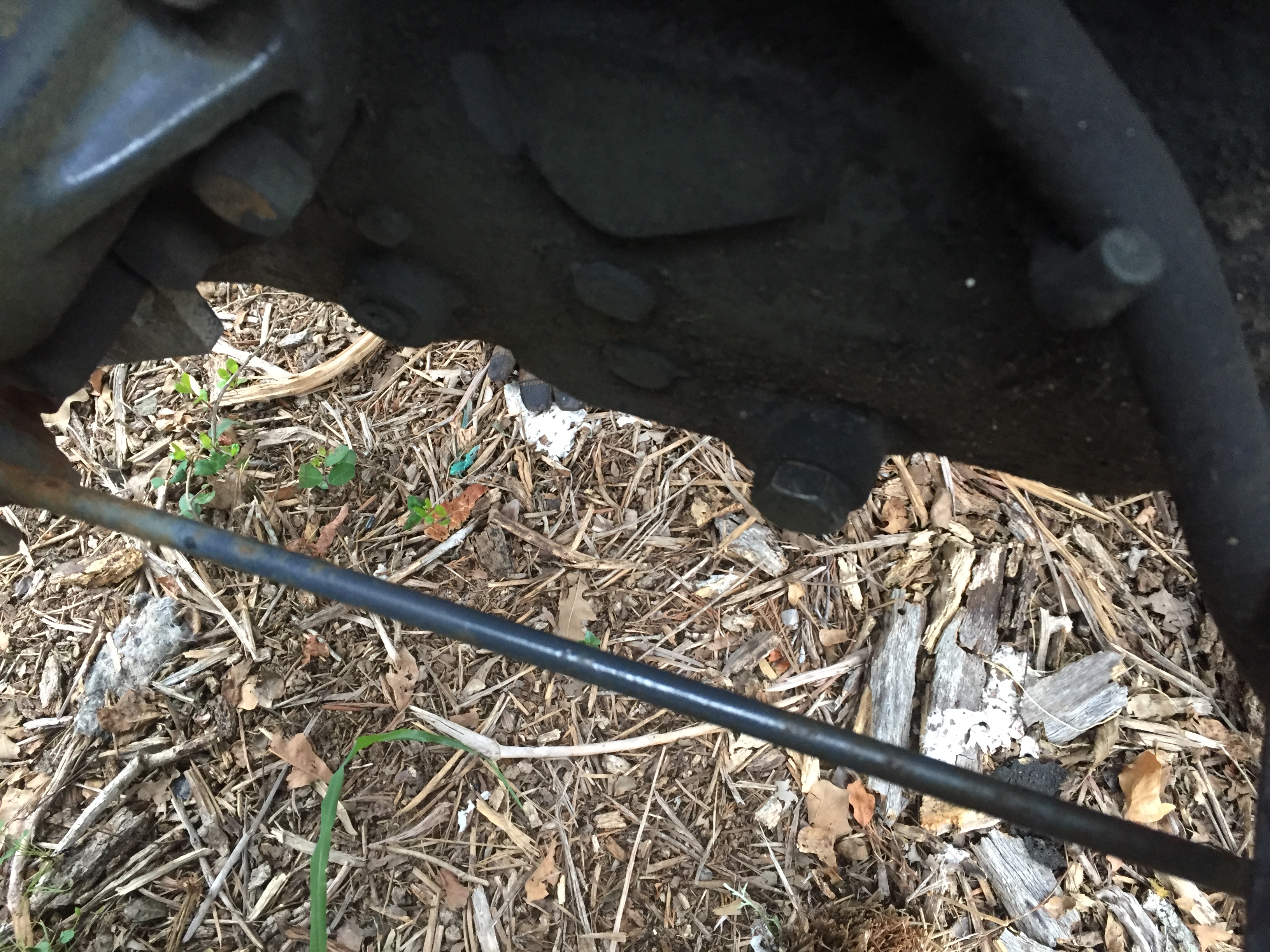

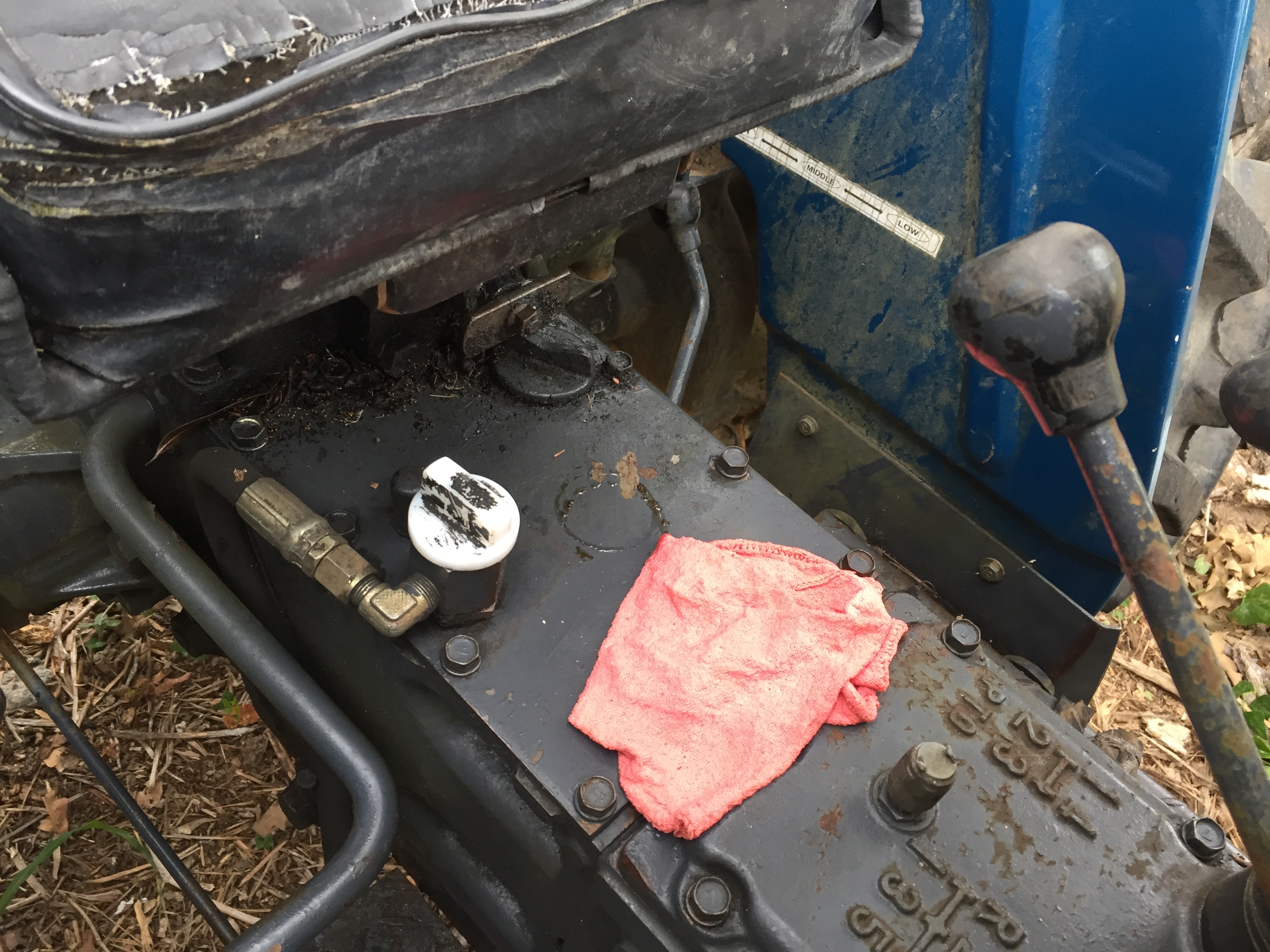

On the right side (as you sit on the tractor), the four bolt plate that's supposed to have the hydraulic screen under it, is non-existent. However, there is a big, drain plug looking thing with what looks like the level plug behind it.
On the left side, is what looks like the cover for the hydraulic screen. But, that so happens to be attached to the hard piping that goes to the pump. Also on the left side, on the transmission case is about an 8mm plug that could also be the level plug.
I'm reading conflicting stuff about how much fluid these tractors take. I've read as little as 2 gallons and as much as 8. Anybody know which is right?

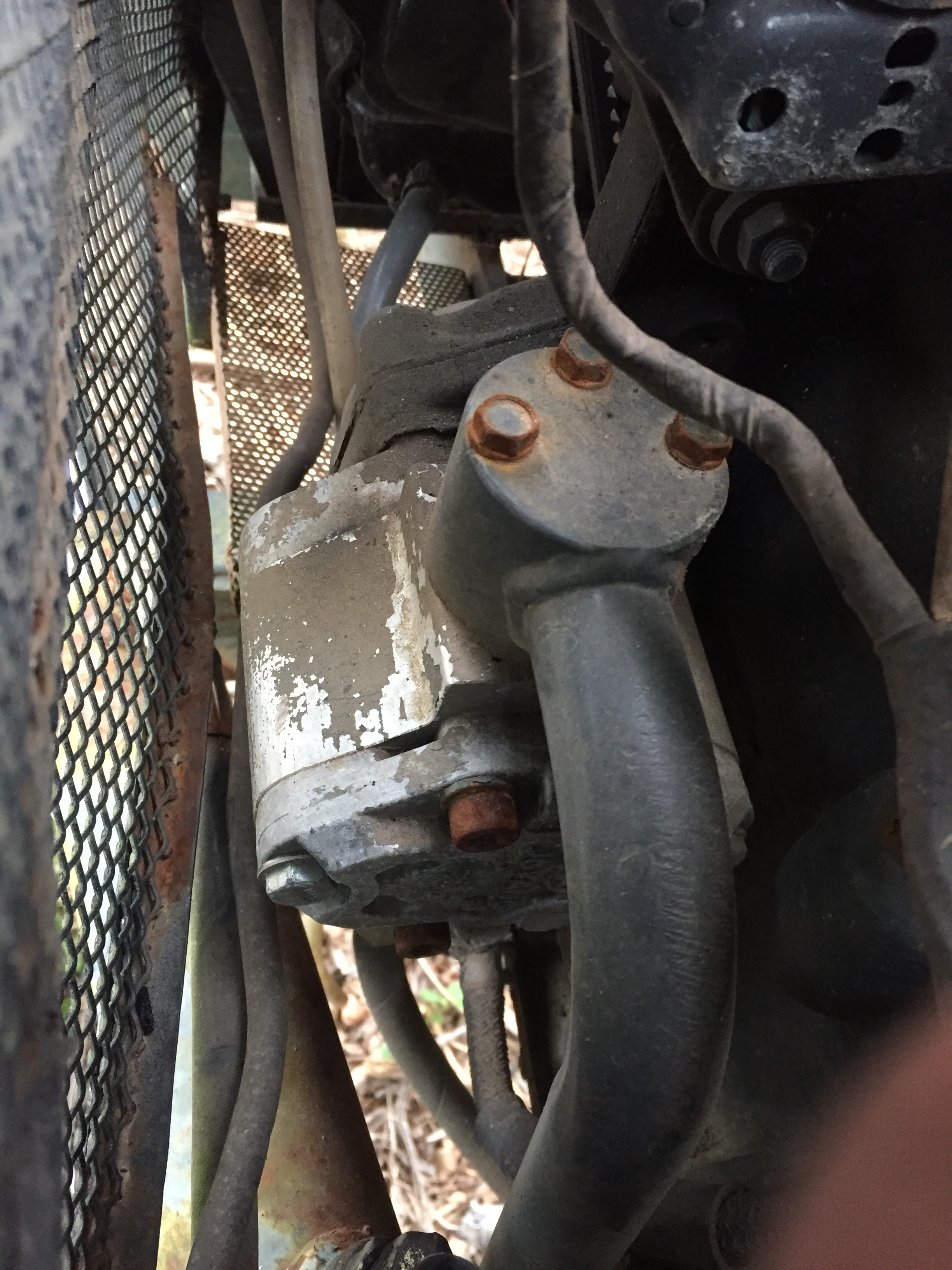

I've included pictures of the pump and where it's mounted. If anybody recognizes it, and has info about it, I'd like to hear about it.

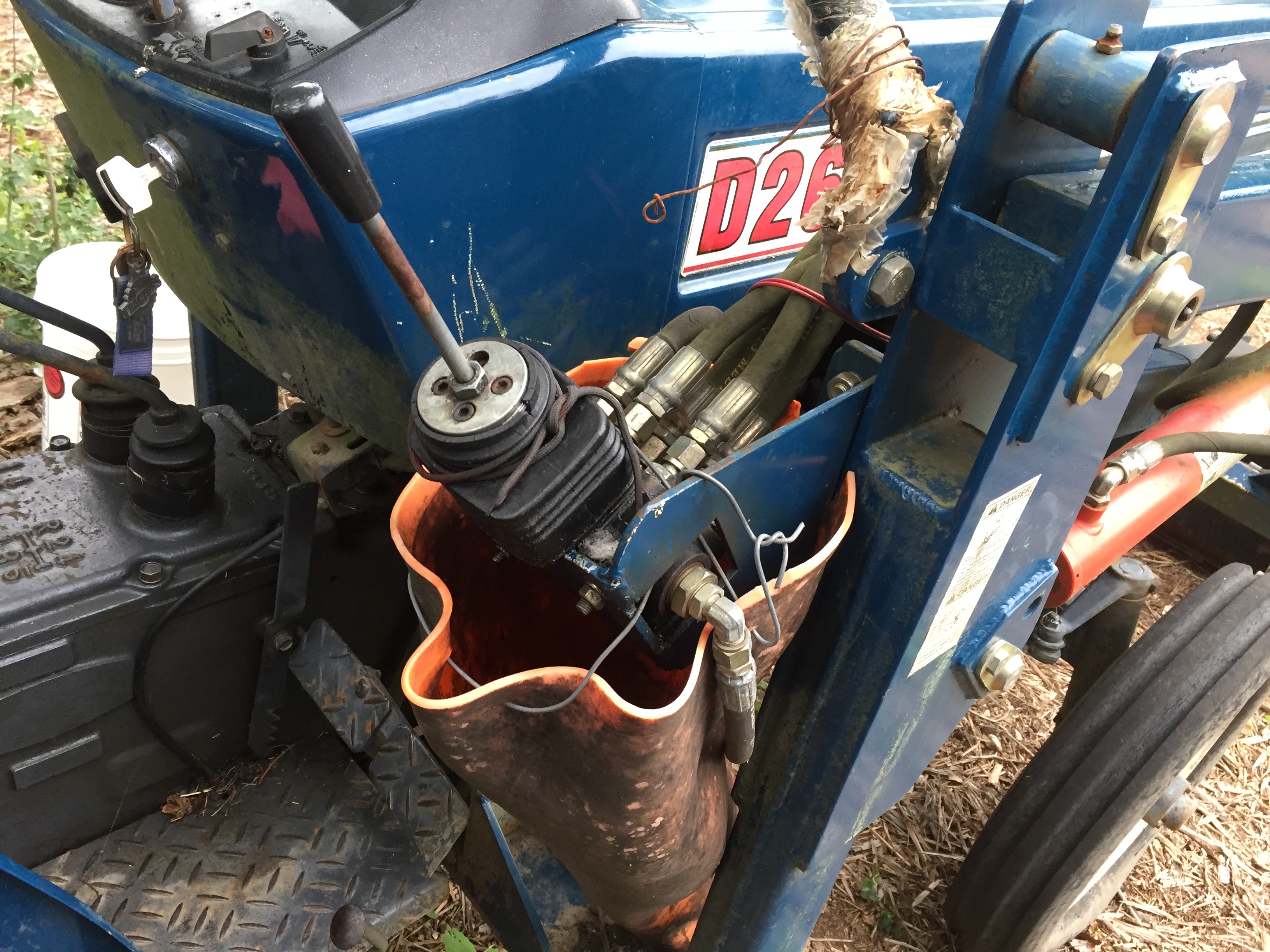

There's also a picture of the spool valves. I believe this is where the problem is coming from. The valve is leaking really bad from around the top. That's why they made the "funnel" underneath it to keep hydraulic fluid from getting all over the operator. Cuz ya' know.... Why fix it, when you can "rig" it?
Anybody recognize that loader control valve? If so, what kind of spiders and snakes are in there when I go to rebuild it?

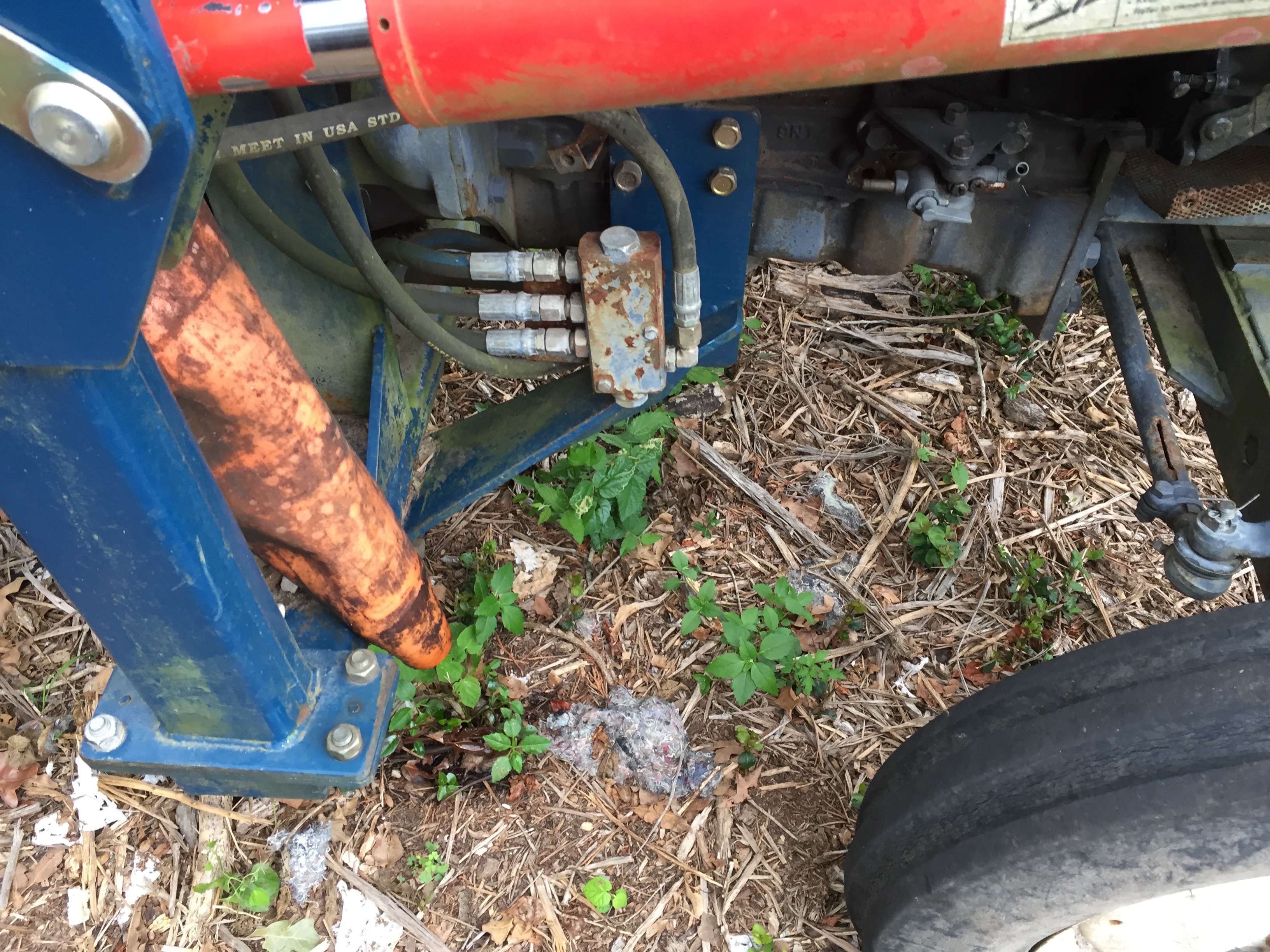

And then last, what is that block under the cylinder for the lift? The one with all of the hoses going in and out. Is that the control valve?
