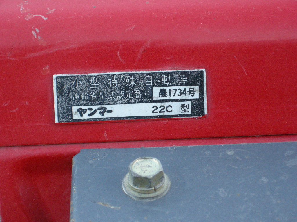

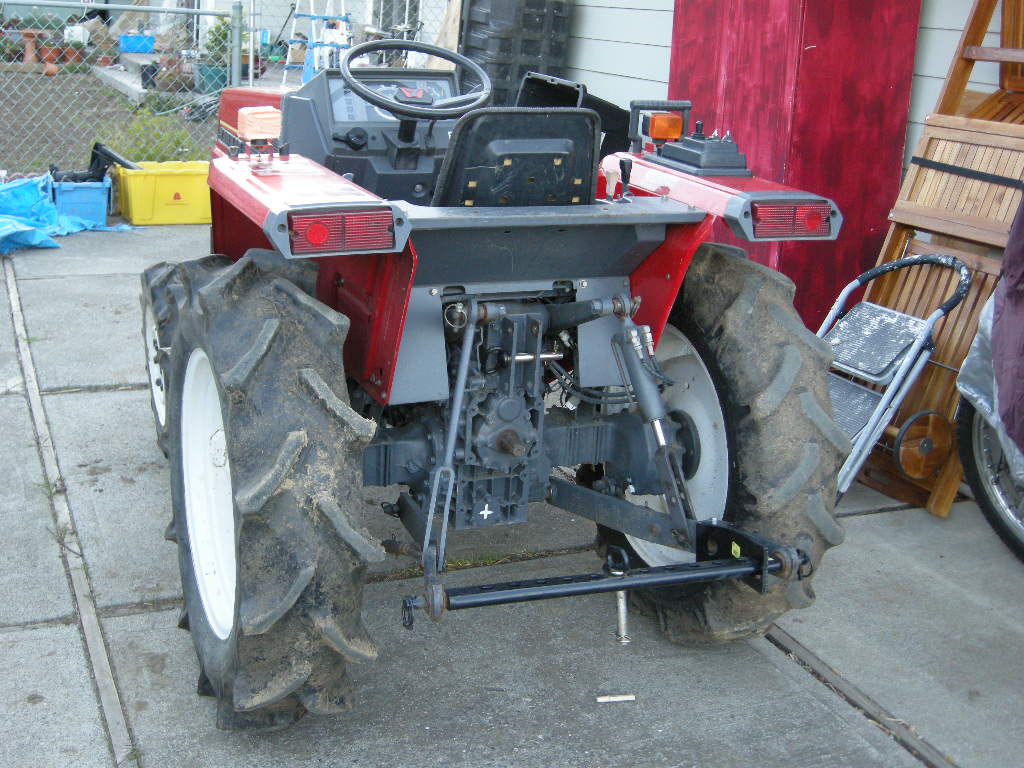

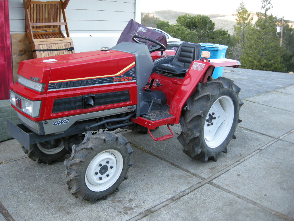

Here are 2 pix of the tractor and one of the only placard I can find on it (unless there are some hidden behind body panels or otherwise inaccessible). It looks similar to the F22D and the F245D/F255D. That's about as close as I can get. The placard has 2 numbers and I assume one is the serial number. The 22C MIGHT be some type of model number, but it doesn't seem to match anything I could find online. The FF225 is listed on this site (Japanese Used Tractors and Farm Machinery -MISH JAPAN TRADING CO.-) but there's only a pic, no info.
Thanks for you help!
Dodd

Not to be a downer, but the FF225 is a no frills tractor as far as the F series goes.
I believe its full time 4x4 , no power steering, no quick turn, and an aluminum housing on the back like the F18.
Im glad to see that yours has the UFO option !:thumbsup:
I had one here for sale about 5 years ago.
It takes a koyker 125 loader with the F215 mount.
Hope that helps:D

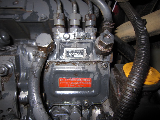

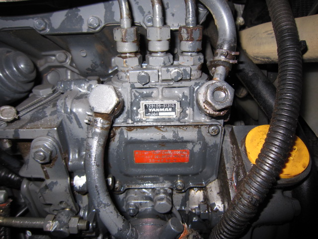

Here are two views of the fuel distribution unit. You can't see it here, but there is a small amount of fuel on the top of the unit. It appears to be leaking from around one of the compression fittings.
Runningbird - I do have hydraulic lines under the right floorboard. In fact, it used to have a FEL on it, but the last owner got rid of it because it was in the way for him driving around his orchard. He just pulled the lines and linked them together with a coupler. That will make it stupid easy for me to add an FEL in the future. I'll have to keep my eyes open for a nice used one (if I can find one).

It looks like you need to tighten those 3 lines on top first, then the caps on the lines. They are a pain to tighten because they are to close together, so have patience...
Hose it all off and let it dry, or use an air line to blow it all off, then inspect for more leaks with a flashlight.
Your fuel dist unit is an (injection pump)
:D:D:D
Ernie

Now that Spring has sprung, I'm more willing to get outside and work on stuff (not that we ever got a good winter out here). I cleaned off the injector pump and cranked the old girl up. It seems that the fuel is leaking from the right-hand connection. If you notice in the pictures I posted earlier, the "clamp" (for lack of a better term) that holds the right two outlets together is a couple of mms higher than the left one. I don't know what the function of those clamps are other than to keep the bottom connections from turning.
I assume that the top connections are standard compression fittings. Should I loosen the top fitting, tighten the bottom one, and then re-tighten the top one?" If that doesn't fix the problem, I guess I'm looking at replacing the injector line and maybe the fitting that goes into the pump.

The lines use copper washers on the banjo fittings, if they are missing, it will leak.....:D
