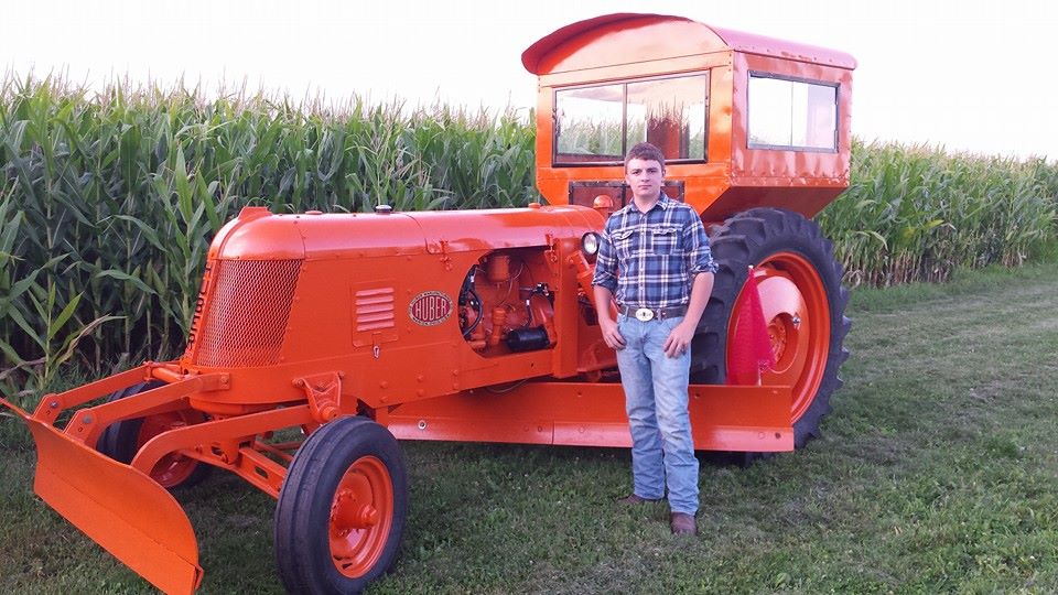

In the past, I seriously considered buying a "Huber Maintainer", built throughout the 50's, and early 60's.
Never did find one close to home, at a price I liked though.
For those who might not know, a Huber looks like a stretched out farm tractor, with a belly blade.
A perfect machine for long driveway maintenance.
Much better than a box blade, land plane, or rear blade for driveway/road use.

Here's a pic of a very slick ole Huber. Used to see them around here. But again, I think the Scrap Iron Monster ate em......
