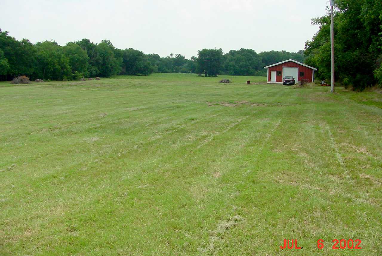

   / INFORMATION ON HOOKING UP A BRUSHOG #14
Yep, worked well, and while I don't have a picture of the hookup, I do have this little picture.

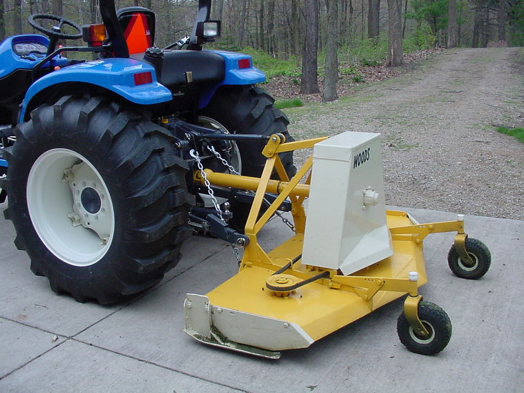

   / INFORMATION ON HOOKING UP A BRUSHOG #16
The attached pic uses the check chains setup in combination with a flexible top link on the cutter. My mower is shown but my brush hog has the exact same setup except without the small turnbuckles for fine adjustment. Note that the top link on the cutter does swivel, much like the picture from rdbrumfield. Others have replaced the tractor top link with a chain, and that's where you've heard some folks get concerned. I know I'm a little bit biased, but after trying all the different methods, none come close to the level cut you get with the check chain setup. No gouging and no constant adjustment. KK does sell many hogs with the flexible link, so see your dealer or just have someone fab one up for you. I guarantee, yes guarantee, you won't be disapointed.
   / INFORMATION ON HOOKING UP A BRUSHOG #17
I probably should have added that the lower arm control is set all the way down, but as you can see the chains support the front of the deck. This setup keeps the deck riding fairly constant with the rear tractor tires, but without the bouncing, lifting and falling that would occur by using the lower arms by themselves to set level.
