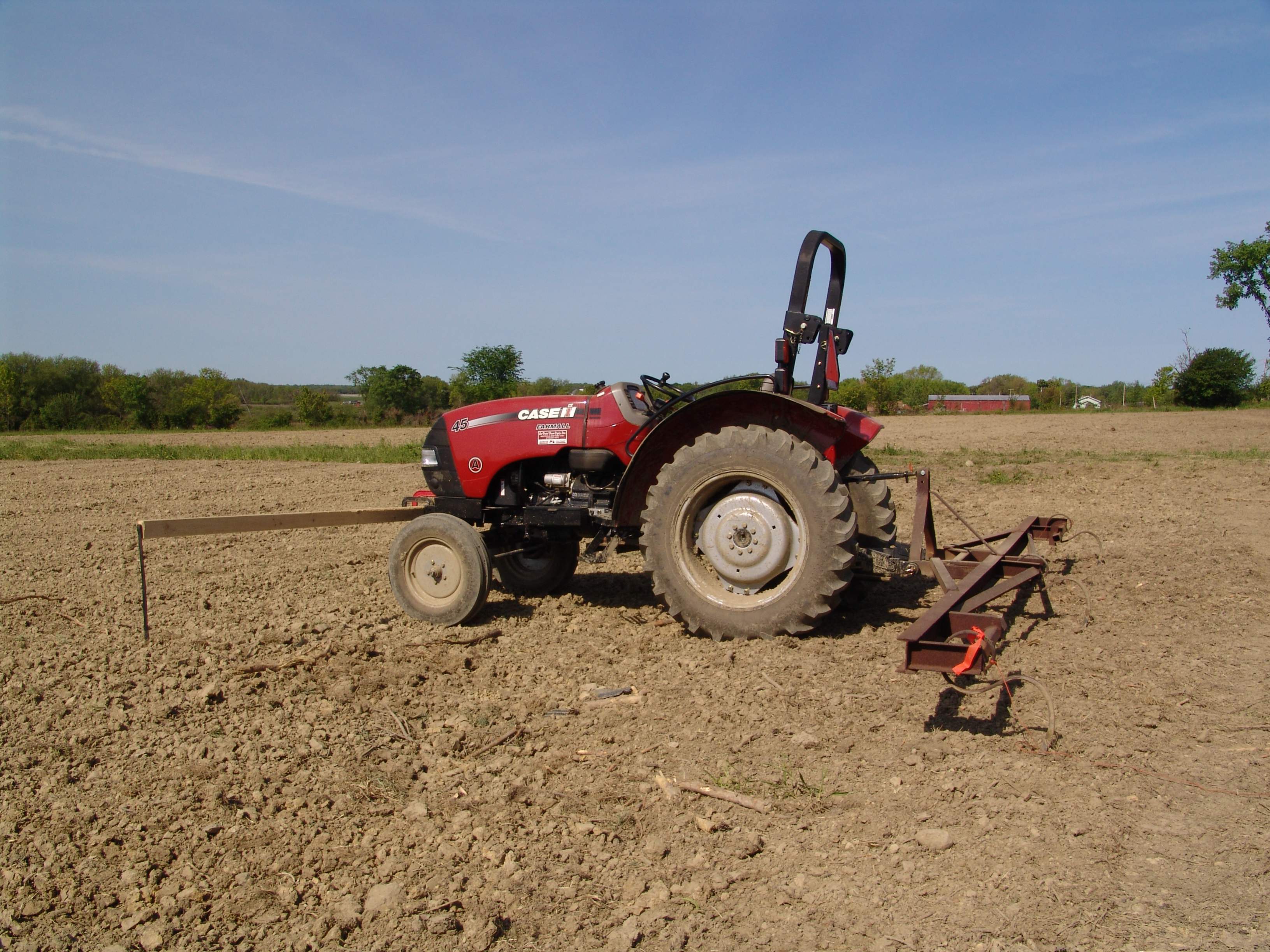

Using it to mark out the rows for the new vineyard
