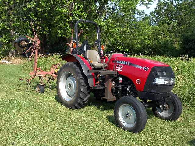

Back home from tedding
   / Initial review of the Farmall 45A #19
Looks good! How hard was it to take the post driver off?
#20
The post pounder comes off easily. All I have to do is unhook the hydraulics, unbolt the valve and unpin the slide cylinder and it slides right off. I just hang it from the beam in the barn so its easy to take off and put back on when needed. The pounder stays attached to the slide table and all the hydraulics stay hooked up as well. The inlet hydraulic side hooks into the rear quick coupler and the outlet dumps back into the case so that there is no restriction when you let the pounder down. That part isn't too bad, just unscrew it and put a cap on the fitting I installed.
