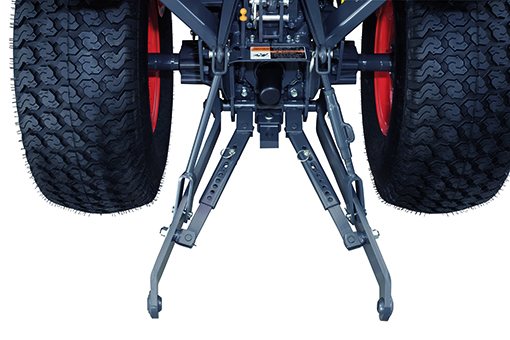

Kubota sells stabilizers for B and L models and larger tractors. When I bought them for my L they were priced less than anything aftermarket and I had them in 2 days. So I have always been surprised when I read about people paying more and waiting for weeks/months to get aftermarket stabilizers for B and L models, or for BX models that can accept the B stabilizers.
As I posted above, I'd suggest someone measure to see if the telescoping stabilizers from the B2301 would fit a BX. There are posts here on TBN dating back to 2011 that show the B stabilizers being added to a BX, so I am sure it's doable. Even if you have to make slight modifications it can't be that hard.
I paid $175 for the L stabilizers from Kubota, so the B/BX sized units probably cost the same or less.

The B stabilizers are on the inside of the arms, just like the BX. Do a search here on TBN -- there are other threads where people put B stabilizers on a BX. It's not rocket science.

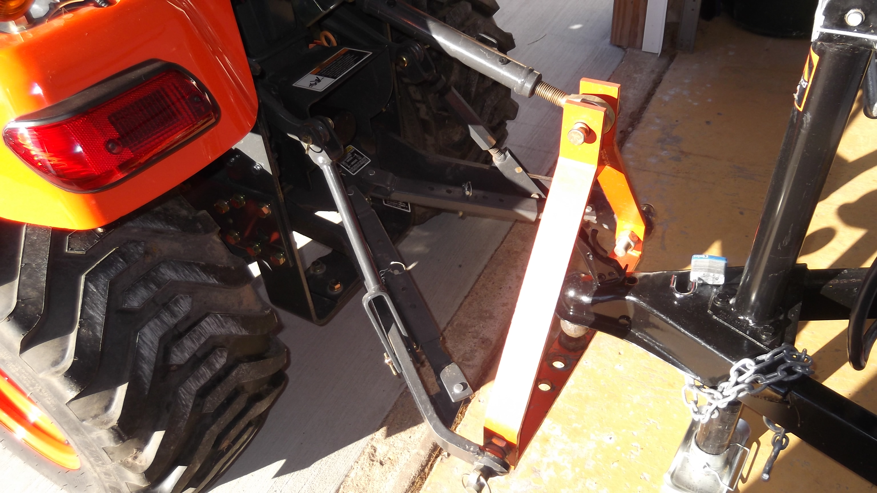

And here's a picture of the parts for B2910 that I used.
http://www.tractorbynet.com/forums/...ng-stabilizer-replacement-421457-3ptparts-jpg
One of the best mods that I made to my BX.
Here's what mine looks like, I did add the rear attachment part off the B2910 later, cut off the original tab and drilled a hole in the lower lift arm.
http://www.tractorbynet.com/forums/...ping-stabilizer-replacement-420433-bxiind-jpg
